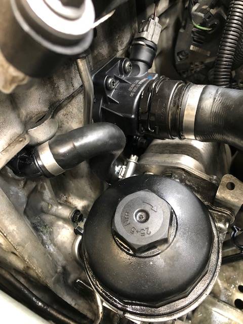

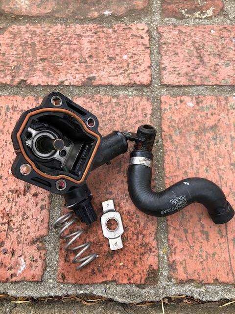

Did this job today.
You were all right, the thermostat WAS broken...terrible design. The plastic end of the hose was also broken just as you all suggested it would be...it is amazing it did not just pop out from coolant pressure on the freeway.
Terrible job to replace the thermostat under the manifold, but got it done and it is all good now. thanks!
- IMG_5431.jpg (76 KiB) Viewed 383 times
- IMG_5432.jpg (54.15 KiB) Viewed 383 times
