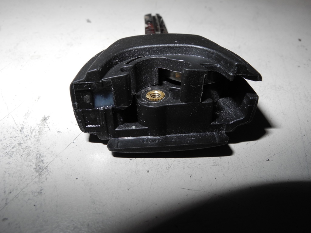

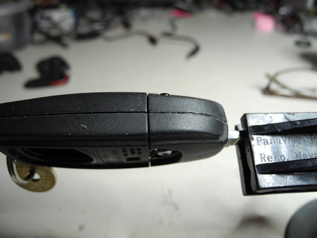

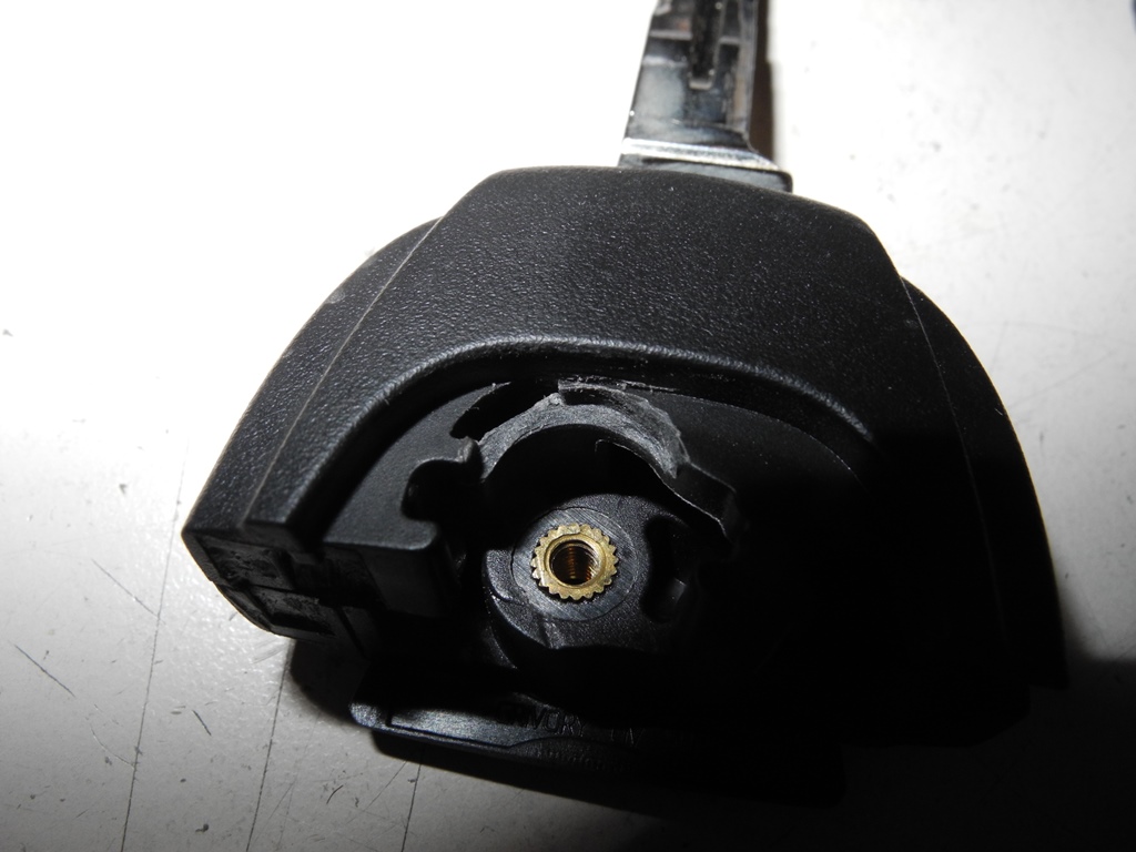

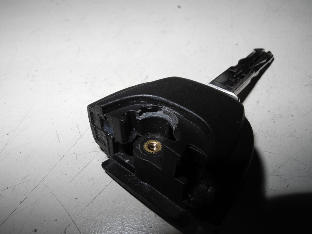

I used the key a couple times since the “fix” and while it's holding up fine, I can already see some delamination of the silicone right at the end of the key case. So trying to pin the down the case flex at the end is key (pun intended) to making this repair last in my opinion. I looked at one of my '08 keys, that end is already showing a small fracture (case is original) so flex is a normal part of function that needs accommodated once you re-use an OE key case.
I like the idea of creating more surface area for the adhesive. I also like the idea of the previous poster who used the thumbtack to hold the bottom of the key assembly tight up against the top. I tried this along with my little screw and it sure seems to lock in whatever flex remains at the end of the key slot. As such, I'm now using a “V4 case” with a stainless 4mm washer under the screw.
I used a handheld rotary tool and a small cylindrical cutting blade to make the notch.When it’s tightened up, there’s no key flex at the end so I’m encouraged. No idea if the brass threaded piece in the base will pull out, time will tell.

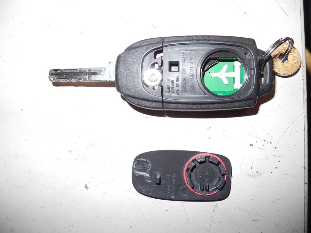

I'm performing the inevitable button repair on the switch key of my S60... Fortunately I have BOTH keys to the car, so have a very functional 2nd key in using since my other one had the infamous ears to the button break off. That all said, I bought an eBay replacement case but wondered before trying to stick my original back together, what's the best way to remove the transponder capsule to transfer into the new casing to avoid glue, epoxy and driving a new screw through the case? I saw above a member used super glue remover, would soaking in Goo Gone do the same thing? I'm thinking if the adhesive could be loosened enough an Xacto knife should work to gently pry it out... Any ideas?
- ZionXIX
- Posts: 1310
- Joined: 11 August 2014
- Location: Texas
- Has thanked: 64 times
- Been thanked: 194 times
So I just did this recently. I spent way too much time separating the case at the seam with a box cutter. If I had to do it again I would use a dremel wheel and just focus all my efforts at the seam. There is plenty of clearance as the transponder is at the bottom. After that I kept widdling plastic away until I felt there was as little as possible holding onto the transponder. Mine popped out with a tooth pick. I bought a reproduction case that just snaps together. No gluing needed. The finish is more of a matte black. Just go slow.

Curious what you did and how you widdled the plastic away from the transponder capsule? I think the case that I plan to transplant to will hold up. It fits together very tightly, which will be inseparable with some industrial epoxy employed.ZionXIX wrote: ↑07 Jul 2022, 06:47 So I just did this recently. I spent way too much time separating the case at the seam with a box cutter. If I had to do it again I would use a dremel wheel and just focus all my efforts at the seam. There is plenty of clearance as the transponder is at the bottom. After that I kept widdling plastic away until I felt there was as little as possible holding onto the transponder. Mine popped out with a tooth pick. I bought a reproduction case that just snaps together. No gluing needed. The finish is more of a matte black. Just go slow.
- ZionXIX
- Posts: 1310
- Location: Texas
It takes a lot of time and patience. Once the halves are separated you will see how much plastic is holding onto the capsule. I took a sharp box cutter and scraped away plastic one layer at a time. It took hours. Always cut away from the capsule, not towards. Just in case you slip. There was minimal to no epoxy in mine.
