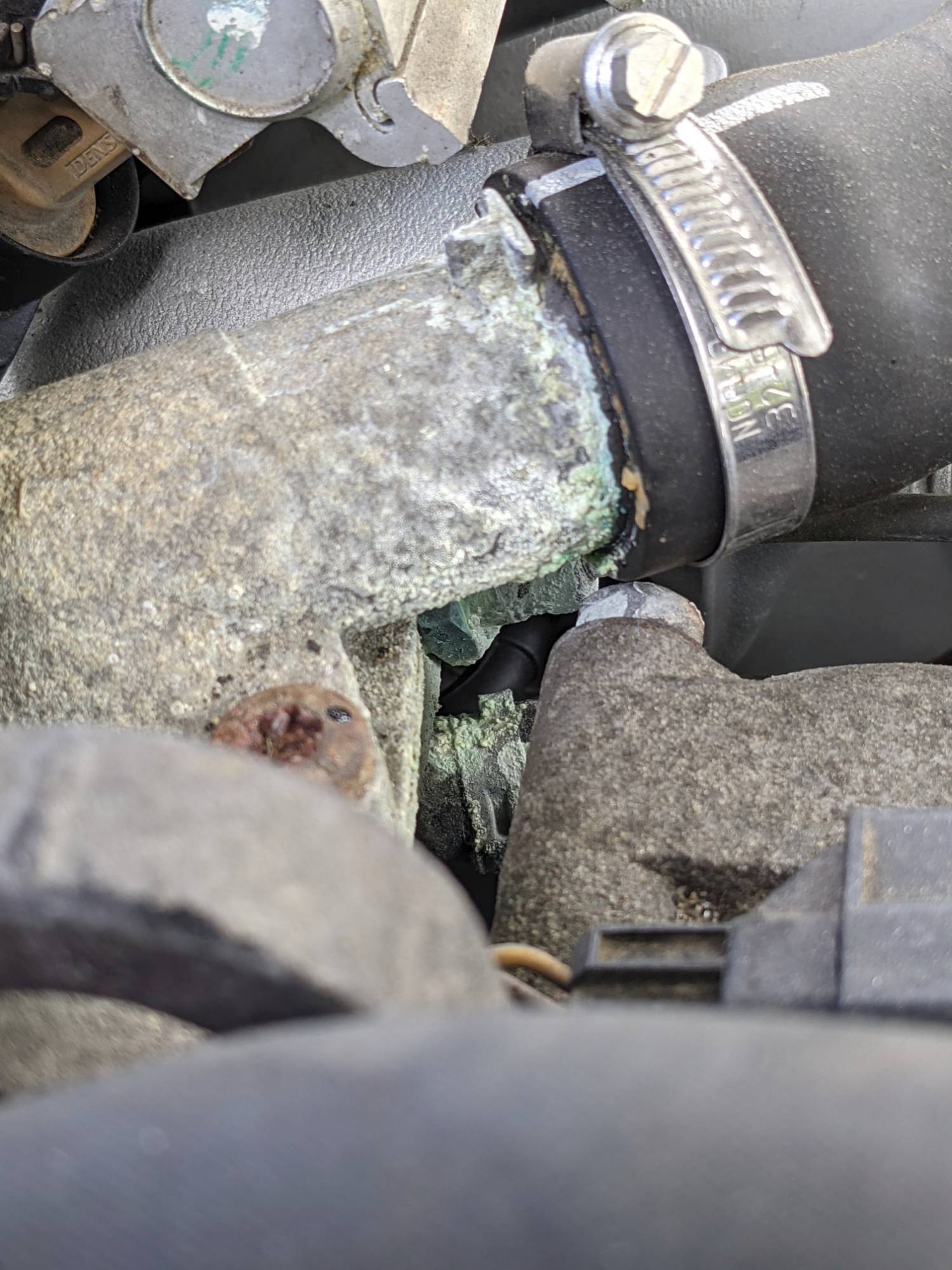

How much should we tighten worm gears around hoses? I replaced many of my coolant hoses with Volvo brand parts and used the OEM Norma worm gear clamps. Yet, I find coolant seeping out at the thermostat. Is there a torque for this clamp and others? I don't want to crank down too hard and hurt the clamp or hose. Thanks.

How clean ids the mating surface? If it is or was crusty and is full of pock marks it may be impossible to seal. You should not have to really crank down o the clamps to make them seal. You should only need to tighten then until you see the rubber starting to indent either side of the clamp. Looking at your thermostat cover it looks pretty poorly.
Other than replacing the cover with a better one, all I can suggest is to remove the pipe again and try to sand down the clamping section to reduce an imperfection on the surface.
Never seen Norma clamps. I always got ABA Swedish clamps from Volvo until about 5 years ago when they started to sell the cheap crap with little cuts in the surface and sharp sides.

Snug the clamp right up the ridge on the pipe so that the clamping force is stretching the rubber tight over the ridge to seal. That will help. If it’s really badly pitted , some permatex aviation gasket sealer will help or call me for a replacement

Hi,FireFox31 wrote: ↑14 Jul 2022, 21:52 How much should we tighten worm gears around hoses? I replaced many of my coolant hoses with Volvo brand parts and used the OEM Norma worm gear clamps. Yet, I find coolant seeping out at the thermostat. Is there a torque for this clamp and others? I don't want to crank down too hard and hurt the clamp or hose. Thanks.
Yeah as Scot850 'Neil' says, the mating surfaces have to be clean and smooth so you get a close, tight fit. From that pic it looks like there could be either a lot of erosion to the connecting pipe or it is very dirty. Either could cause a slow annoying leak.
So i would say take it off and clean the mating pipe to start with, then maybe some sealant as Abscate says if you see any erosion.

That clamp doesn't look tight to me, although I admit, I've never used one of this specific type before. I've got them on the car of course, but I've not had to remove them.
I have seen specs for worm drive clamps, but I don't recall exactly where, and they may not apply to this specific type any way.
I agree on the need for cleaning. Besides the casting, I'd also scrub inside the hose.

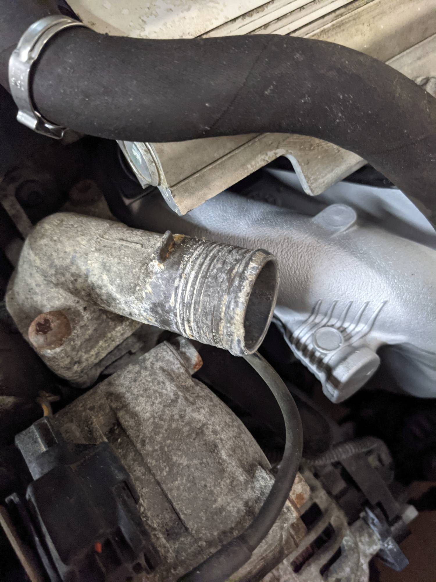

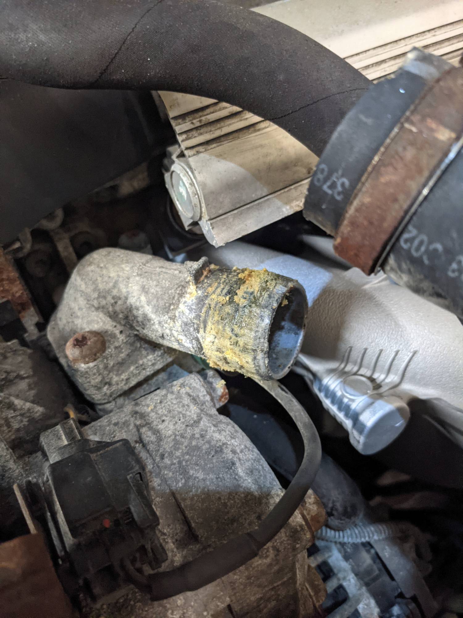

Thanks for the feedback. When I removed the old cooling hose, the thermostat housing was covered in yellow slime. I did my best to scrape it off, but wasn't super careful about it. Before and after pictures are attached. I'll drain the system and try to clean up the housing even better.
Speaking of dirty coolant connectors, the metal pipe which leads to the lower radiator was covered in rust. I don't have picture of after I cleaned it but I'll be checking it for leaks as well.

I like using a wire wheel to clean up stuff like that. Preferably off the car, but even on the car if necessary... a small wire wheel on a drill, die-grinder, or even a Dremel. The Dremel would not be very aggressive, so I'd try to only use it in low clearance situations.
