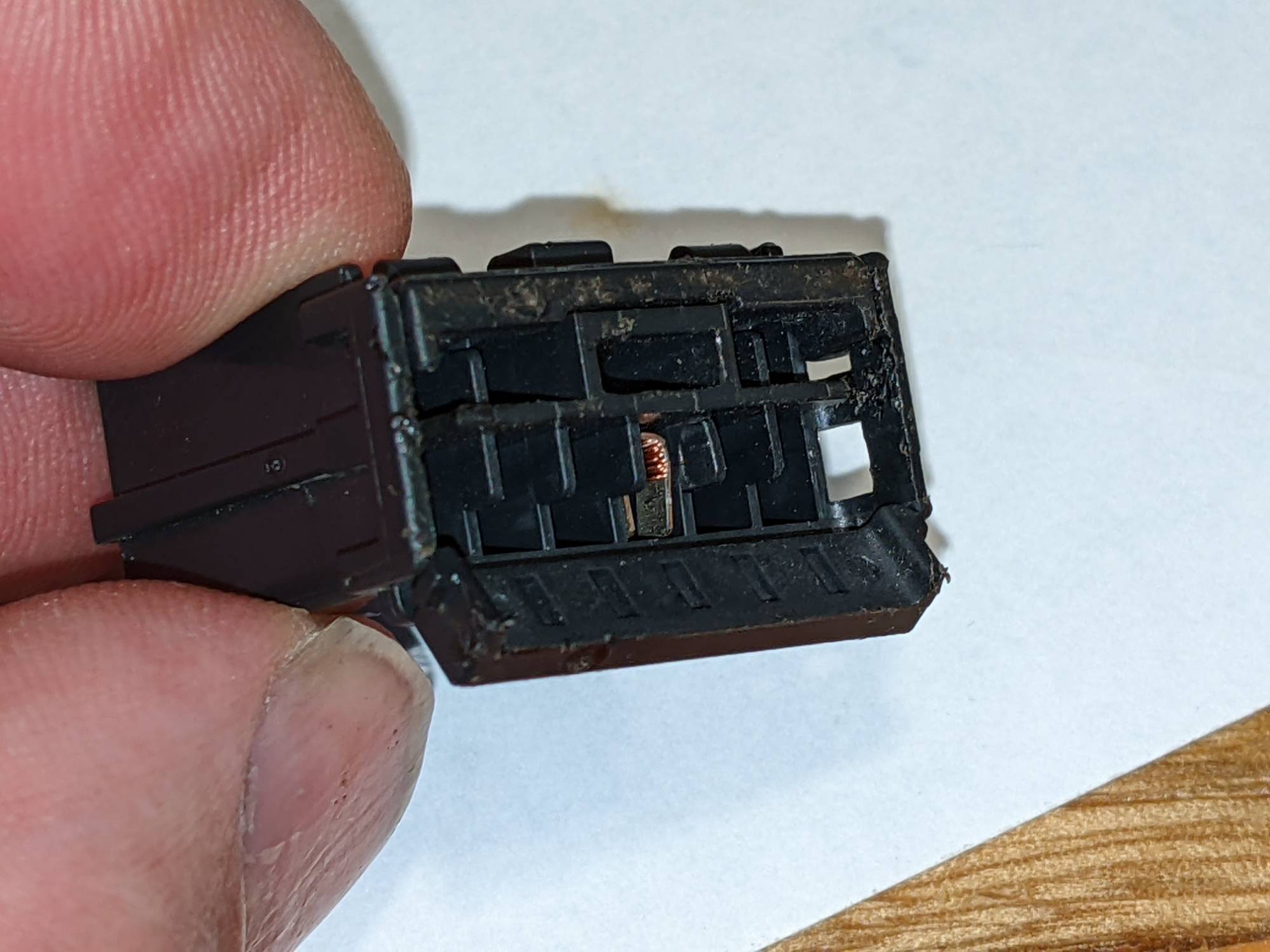

I will probably pull another connector next time at the junkyard with a piece of cable to allow a connection to be made, but my question is does anyone know what pin removal tool I need to extract the pin from the connector?
I have a small set of connector pin removal tools but none seem to work and I don't know what the pin looks like to find the correct release tool. Anyone have any ideas and can point me in the right direction please?

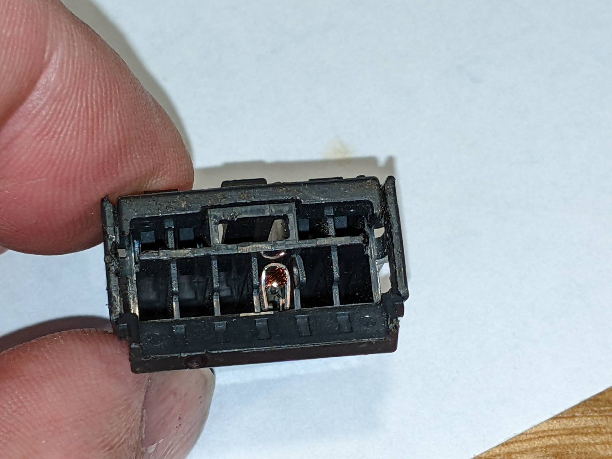

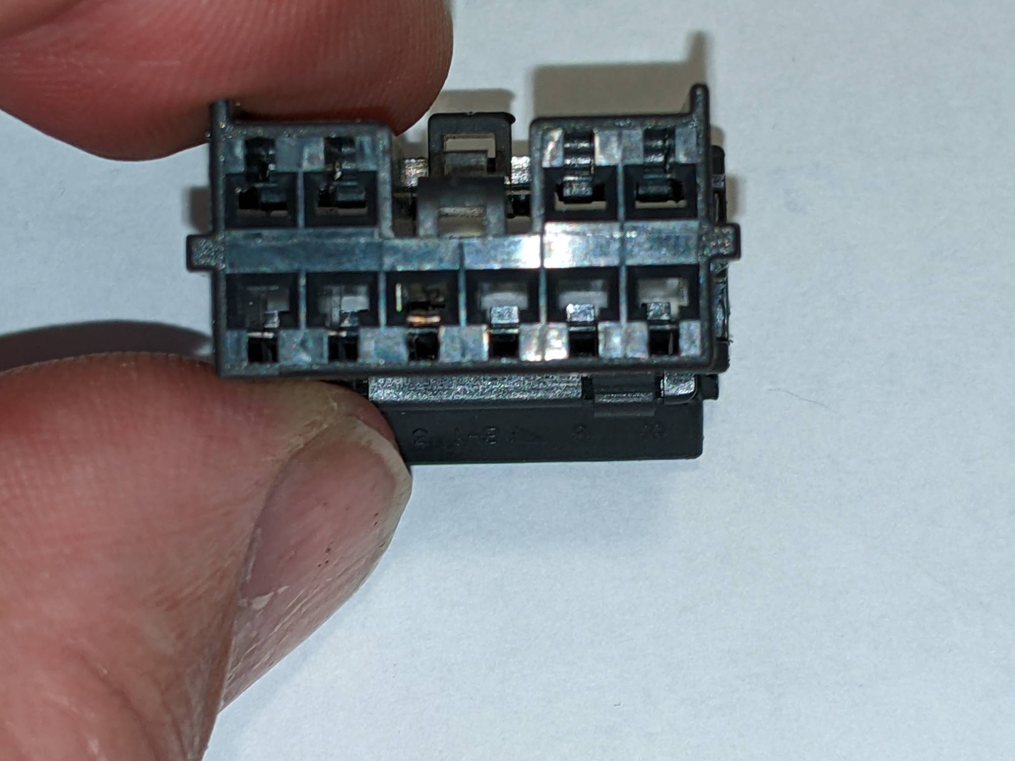

In the picture above the locking bar for the pin has been opened up
You can see the only pin in the 3rd hole from the left in the bottom row.
Any help appreciated.

There’s a plastic tang in the plug body
that drops into a hole in the connector pin.
A very thin, flat pin release tool should
lift it up and out to free the pin.

I broke the plastic tang off trying to remove it. I can see no easy way to remove it. I tried the 5 different tools I have and none did a thing really to help release it. Once it broke the tank off it still came out with a struggle.
I then tried it in one of the other slots for giggles, and it was a bear to get to go in. Now naturally it won't come back out!
I think my original plan is the way to go and cut a pigtail and connect to it.
Thanks guys.
Thanks guys.
