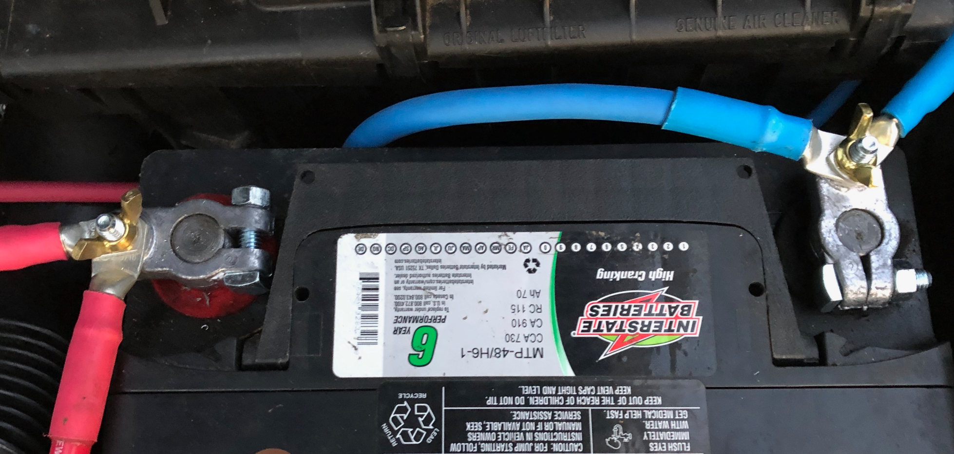

back in 8/2019 I decided to replace all my battery cables and I went the route of making my own.
I didn't look on amazon for fancy batter cable terminals (wish I did) but ended up going with this set up.
This set up has been working fine for over 3 years now but probably < 10K miles as I drive so little theses days.
I sourced the red wire and lugs from West Marine. I ordered the blue wire online for the extra 5 hp/ft the Polestar blue color gives me.
it would have been cheaper to just buy pre-made cables but I enjoyed the project. We'll see how long this lasts me.
Note I did install a proper cover over the + terminal as part of the project.
Th wing nuts seem to be holding fine but I think I should swap those out for proper nuts.
One nice aspect of this type of terminal block is I can disconnect the negative side without removing terminal form the post. That remains tight and I just have to remove the wires and then tuck them behind battery.
-A
