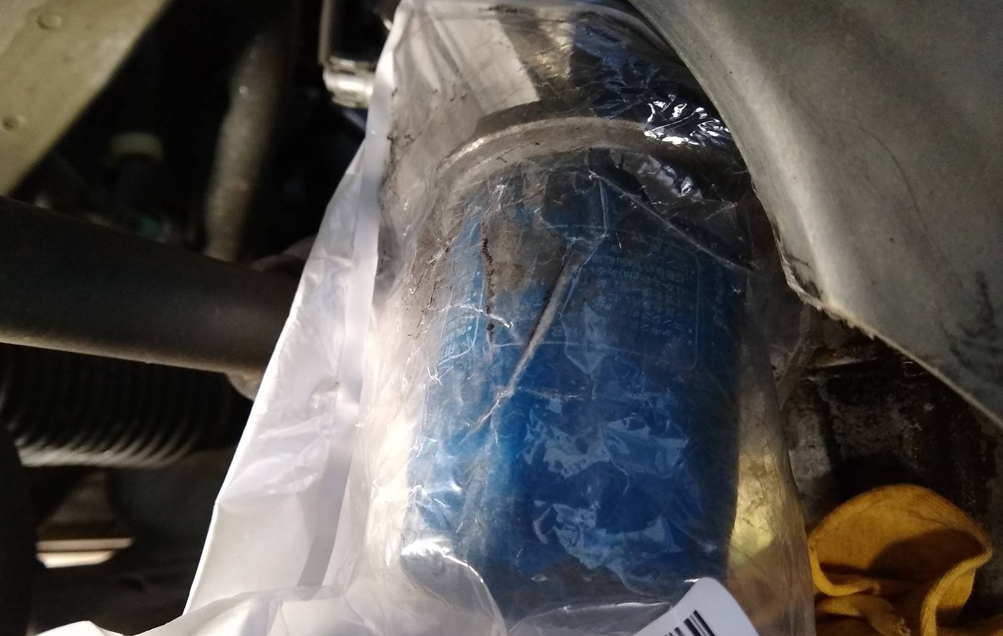

Forgot where I saw this yesterday but the filter is tightened 1 full turn after making contact then backed off just a little. Oh, a zip lock is part of the tools as it wraps around the filter, when possible to catch the oil. 03 Honda Odyssey.
I've heard of using a bag, also seen a cup demonstrated. I could try it, although I'm not crazy about having an oily bag.
Added to my toolbox of knowledge. Brilliant.
