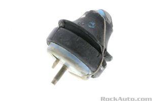

5 mounting points? Yes, motor mounts with hydraulic fluid yep.. they're dead center of the firewall and radiator.. I call them acorns.. that's what they resemble

MDK, are those "acorns" easy to replace or to access on my own?

Not that big of a deal if you know what to do. 1a auto have videos on how to.. on YouTube XC70 V70 S60 2001-2009 Basically the same. You have to loosen the motor mount that sits directly below the serpentine belt (passenger side) loosen whatever mount your trying to replace and put a jack on the oil pan.. I recommend checking out the videos first MDK

Not too difficult, fairly easy if you’ve done it before…FCP Euro also has a video…Mr. Detail wrote: 13 Oct 2022, 05:54 MDK, are those "acorns" easy to replace or to access on my own?
Might as well change the other mounts while at it. Need a 15mm swivel socket for the top nut on the front mount and a 14mm swivel socket for the bottom bolt on the rear mount, most difficult part of the service, removing and installing that bolt.

I find a long 1/4” extension fits perfectly against the sway bar and gives enough clearance for that one.

The swivel socket I used was 3/8” drive with an 8 inch, more or less, extension. Just cleared that gap, don’t think a 1/2” drive/swivel will fit thru. That bolt can really be a bear if frozen in place, difficult to square up the socket and get enough torque, possible to break bolt head off. Also, be careful not to cross-thread it when re-installing.
