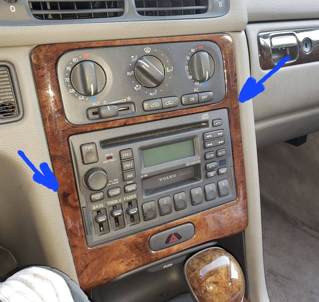

Greetings all,
I have a very squeaky dash in my 98 S70. It is not the dash mounts though. At least I do not think so. All 4 mounts are tight in the dash & the dash itself seems tight. I am getting the noise in the trim where the wood trim around the stereo & climate control meets the dash. I am probably not explaining it well. I am attaching a photo the points out where the noise is coming from. All along both sides where the arrows points to. I can push on the dash itself & the noise does not change but when I push the wood trim, I can get it to stop. I do nothing that this trim can be removed without pulling the dash. Any thoughts on this? One final thing. This is an older photo. When I recently changed my head unit, the noise got a little better for a while but it is still bad. Thanks.

Maybe just a couple of squirts of silicone spray around the edge.

You can get that trim out but it’s not fun. I recently documented where all the fasteners are. You work through both the radio hole and the removed glovebox…

Sveedy wrote: 06 Nov 2022, 06:51 Maybe just a couple of squirts of silicone spray around the edge.
Hadn't thought about that. I tried sticking a business card in there to see if it changed anything but it would not go in. Thanks.

abscate wrote: 06 Nov 2022, 06:53 You can get that trim out but it’s not fun. I recently documented where all the fasteners are. You work through both the radio hole and the removed glovebox…
Less fun than pulling the whole dash? I just found your post on this. I'll take a look. Not sure I'm that desperate yet. Thanks.

Much better than whole dash removal. Taking off the dash pad doesn’t help access the screws at all, just pull the glove box and radio.
Tape the torx screws to the driver to start them in the new console.
I think I skipped the bottom ones. I can post a clearer picture of the console out if that’s helpful

I think you may find you have broken dash mounts. The 2 lower mounts (one either side) by the door trim also fail not just the 4 main ones.
I would try the silicon spray with one of those plastic tube nozzles, but I think it will return.
