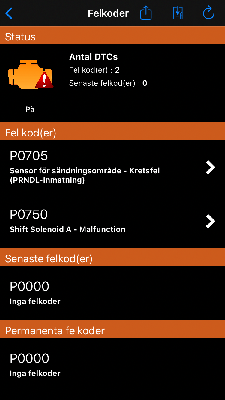

I have some codes and the last one someone said is becuse the car thinks it is in gear thats why it wont start? And as i Said it is manual swaped but the problem is i don’t no where they spliced the harness? I know that some green/green red should be togheter but cant find them..Well i have alot of green and green/red wires but don’t know what goes to where🤷‍♂️Soo If someone has a pinout diagram for the ecu/tcm and what cables i should follow that would be great or any HELP AT ALL WOULD BE NICE and i have no reverse lights it seems like either

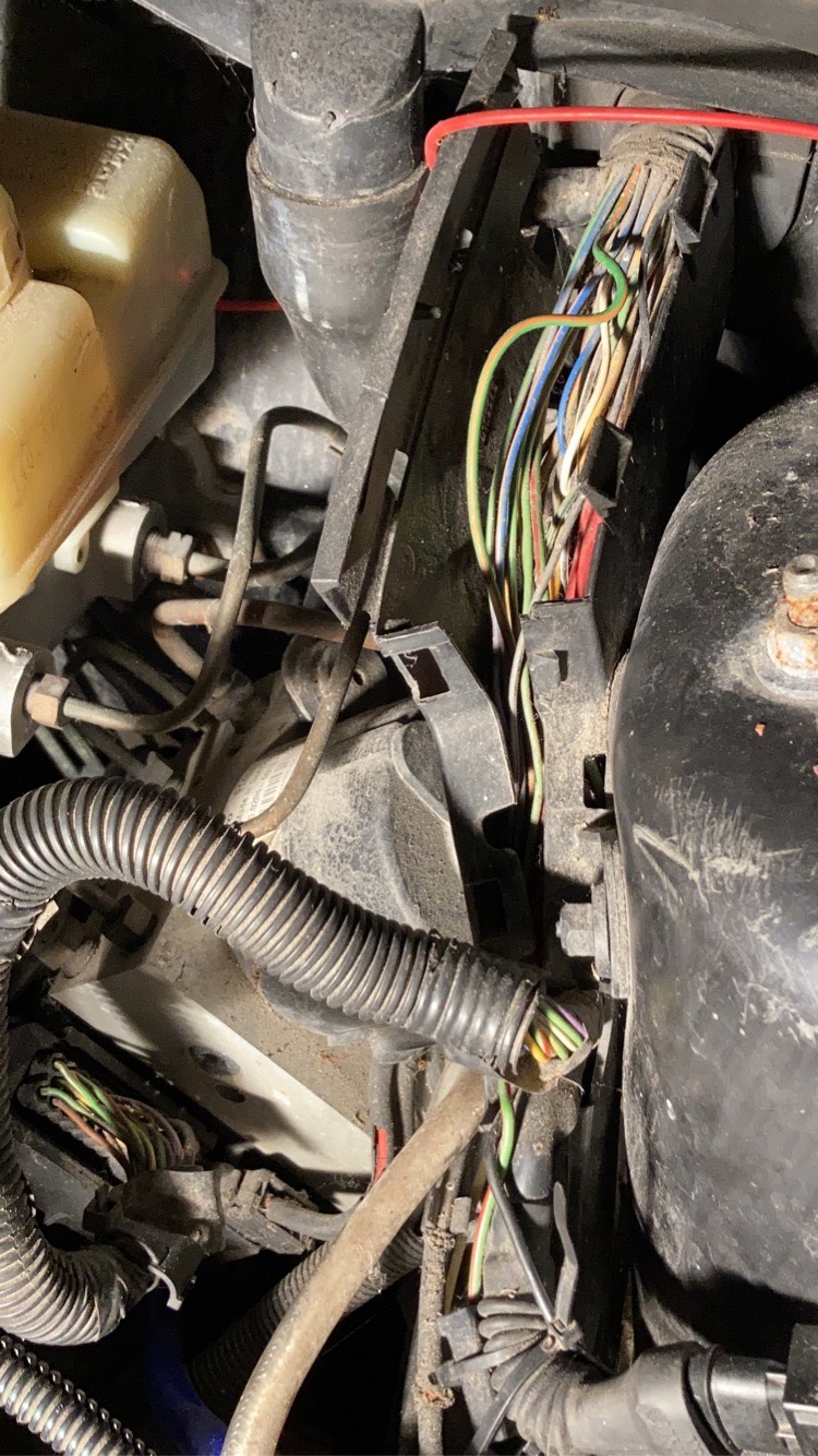

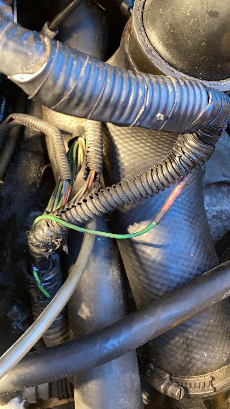

Included some random pics of the harness maybe not so much for help but still
Obd codes
Obd codes

There is a red green splice that has to be made to bypass the Pnp switch but that will cause a no-crank state, not stop ignition. Sorting out someone else’s wiring is difficult but the good news is that job looks bad enough it’s worth starting over and redoing everything. Who goes to the trouble of opening looms and then not replacing the wires? Yuck!
