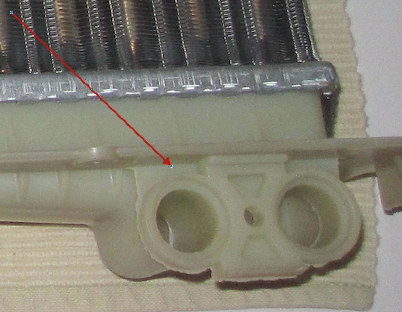

Oh man. I've got a leak at the o-rings right now, and I've just come across this thread. I installed a Swedish Car Parts core back in January '21, and it has leaked ever since (I just realized last month).
I've since tightened the T25 twice. I originally was careful NOT to over tighten, based on Robert's video where he says "don't over tighten, or you can pinch the o-rings".
I was thinking I just needed to snug the screw more, but now that I see this I'm not sure. I bought the core directly from the site (I even talked to Alex a bit on the phone beforehand, FYI turns out anything on ebay is not SCP, he says).
Anyway, the core is still on the car, but I did snap some photos before I put it on. It's not clear and close up like the pics you all have, but I did notice something...what looks like the same anomaly in the same place that you all have seen.
IMG_0706 - with arrow, out of round - cropped.jpg (129.25 KiB) Viewed 418 times
Posts: 35273
Has thanked: 1498 times
Been thanked: 3810 times
What’s the T25 screw bolting into on these? It doesn’t look good to seal the oring on that

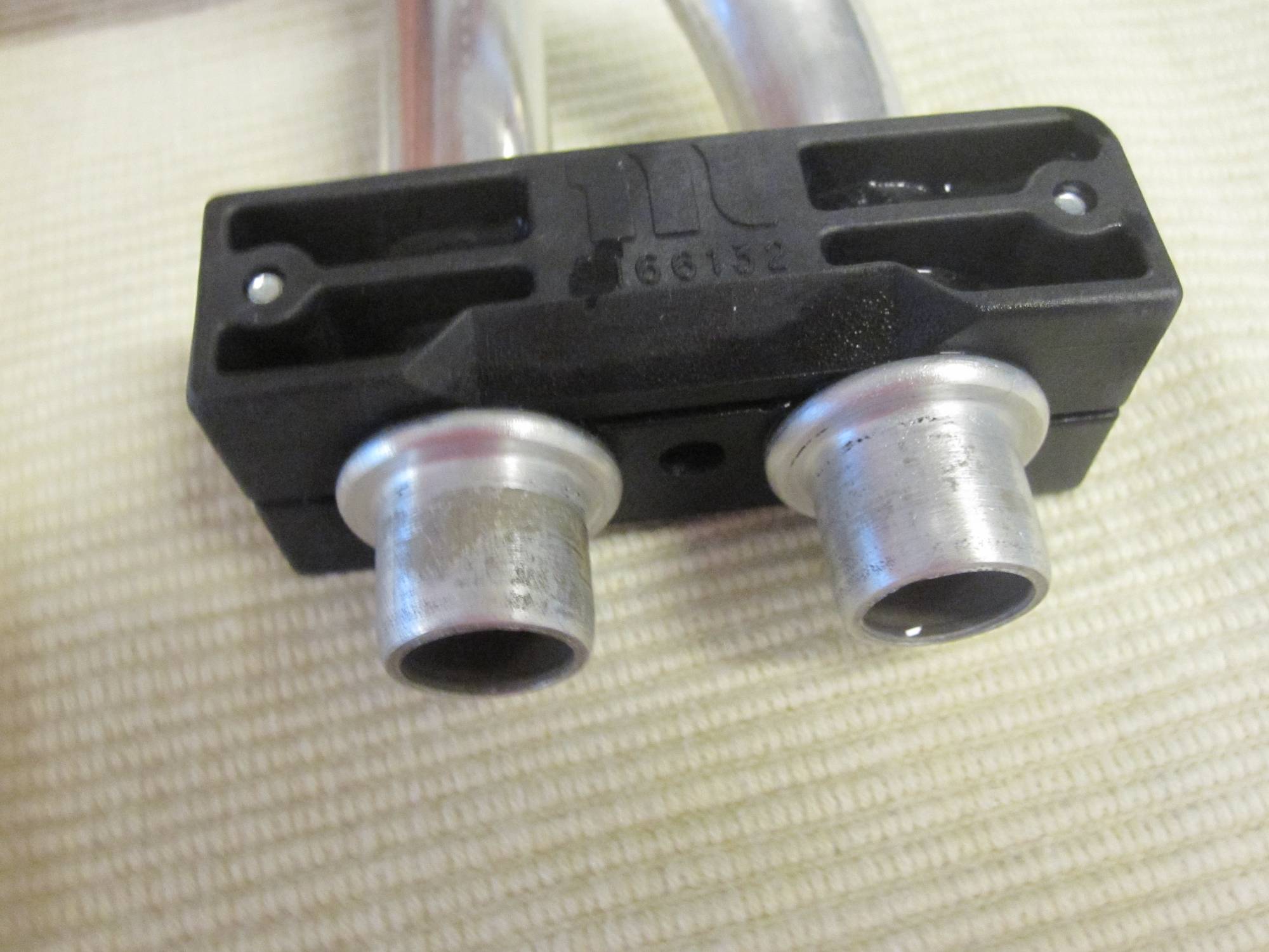

abscate wrote: 25 Nov 2022, 17:59 What’s the T25 screw bolting into on these? It doesn’t look good to seal the oring on that
The T25 is bolting on to this piece. So, you don't think this core looks ok? Because of the warped looking o-ring boss/female port connector piece?
