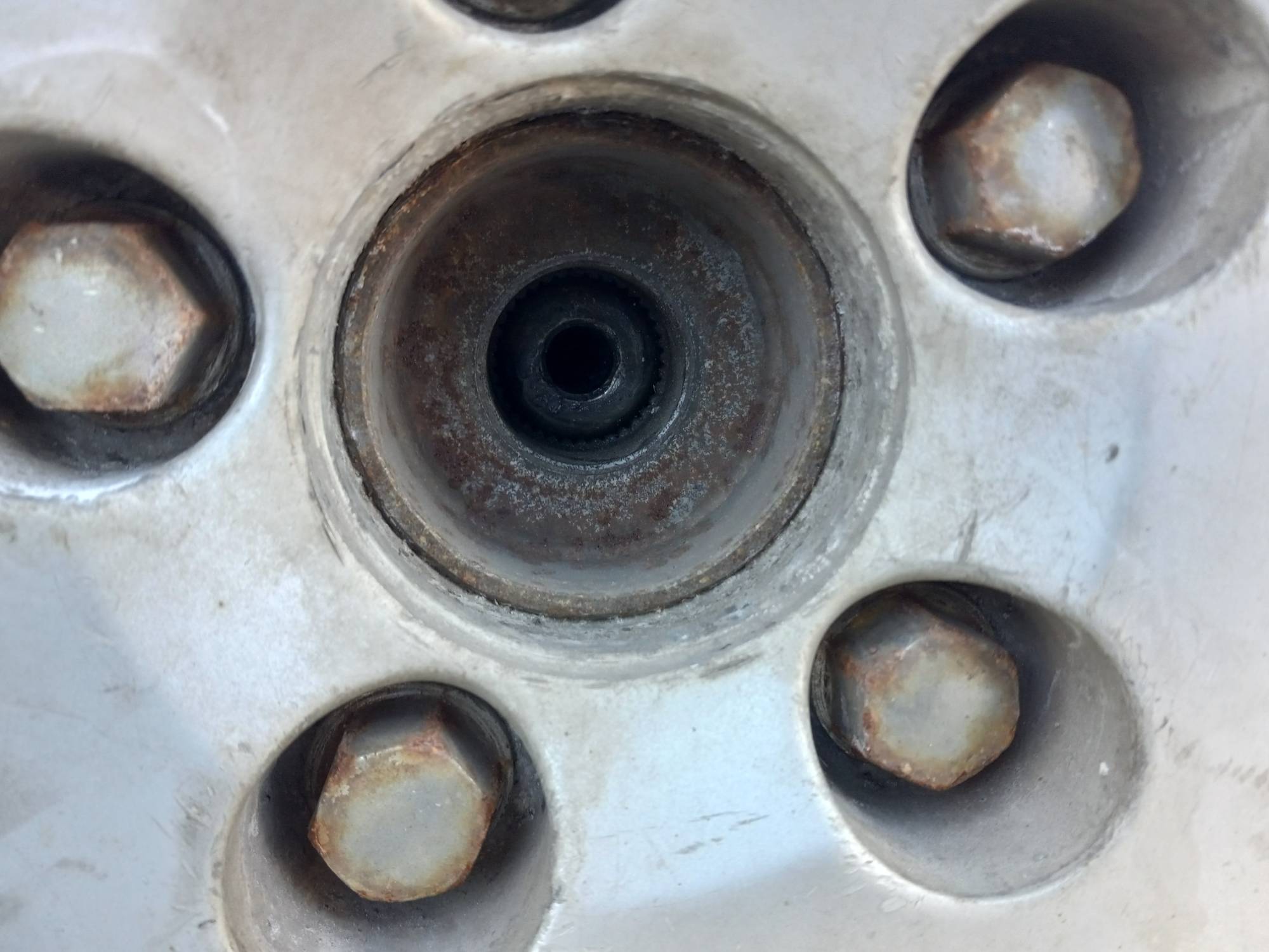

Here we go, this might be the cause, something went missing.
Who knows how long I drove it like this. Front driver side, this is where I was getting an ABS fault . duh.....

It’s nice to find root causes so …..visible

Any noises with the missing bolt , no “pinging” on deceleration or anything just the abs?

Stu70 wrote: 27 Dec 2022, 03:23 Any noises with the missing bolt , no “pinging” on deceleration or anything just the abs?
slight noise on bumps, hard to pin down from just the noise.
I didn't really hear much until after finding the bolt was gone. Then I noticed every little rattle.

Those soft bolts don't require much torque but wonder how it popped out. Did it break off from the stud?
When I first did them on my P2 I broke that soft bolt. Had to extract it then rethread it.

I don't think it snapped, I'll find out soon enough.
Harbour freight torque wrench, should be called talk wrench.
You can guesstimate torque better than this thing.

Volvo used to sell axle bolts with rubber cone on them.
Here you go, an aftermarket one: www.amazon.com/MTC-171021-30714142-Insu ... B01CGOFX68
