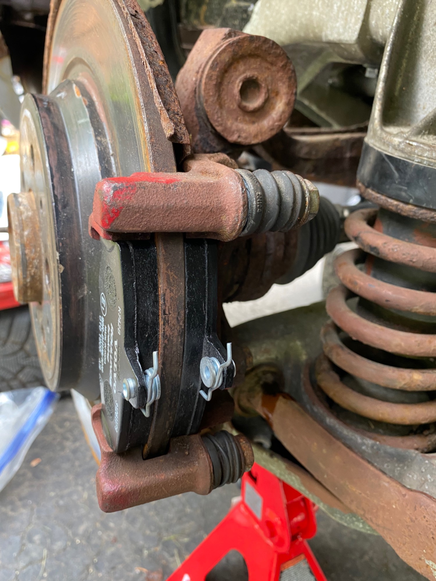

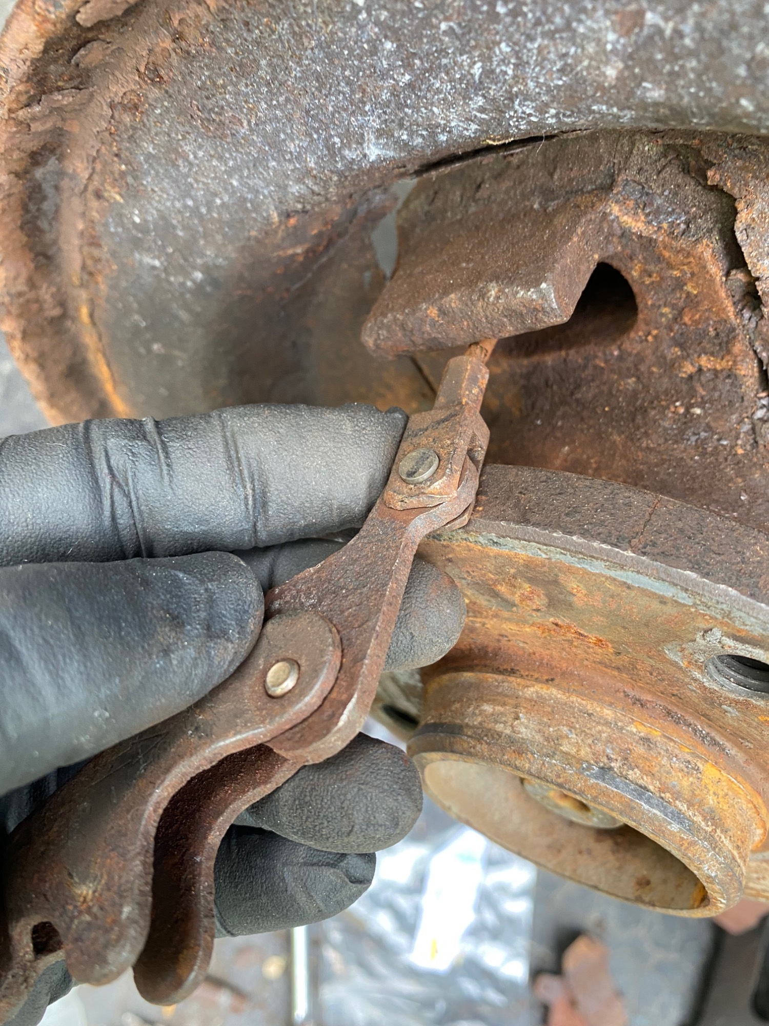

I think the P2 platform uses a common parking brake expander but the bastard 1998 1999 2000 awd use a nasty boy
Unlike a simple hook, some Swedish Sadist designed a clevis and pin design which has to be inserted , then tucked into the expander so the pin doesn’t fall out. It is hard to do this working inboard , so I popped the cable off the parking brake lever and set it up outboard.
P80 awd parking brake expander and cables

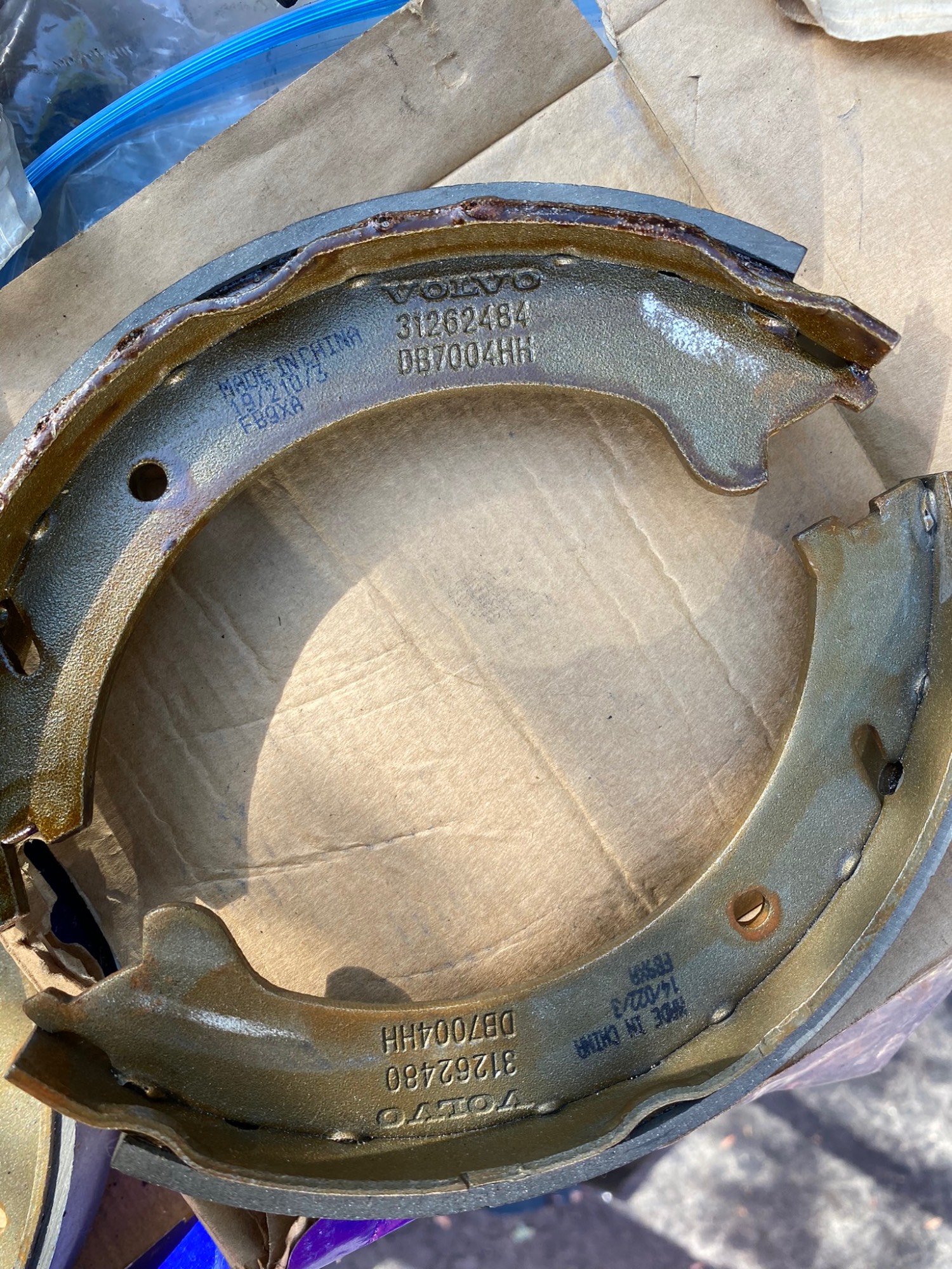

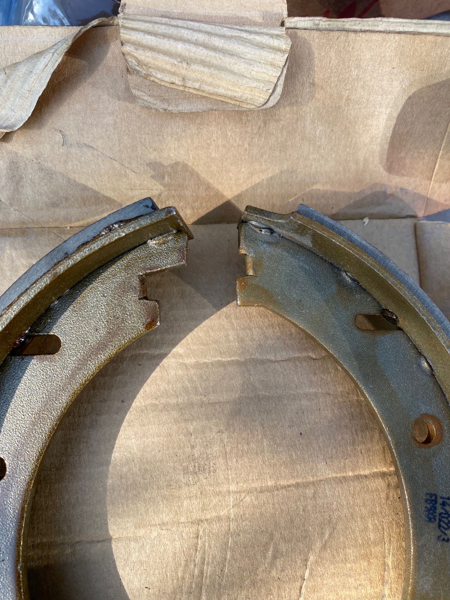

Those awd shoes are also different ftom both p80mfwd and P2 shoes…although Volvo will send you a special mixed set if you ask nicely…

Those backing plates are rather crusty. At least the pivot for the shoes is part of the hub and not aluminum like on the P2's!

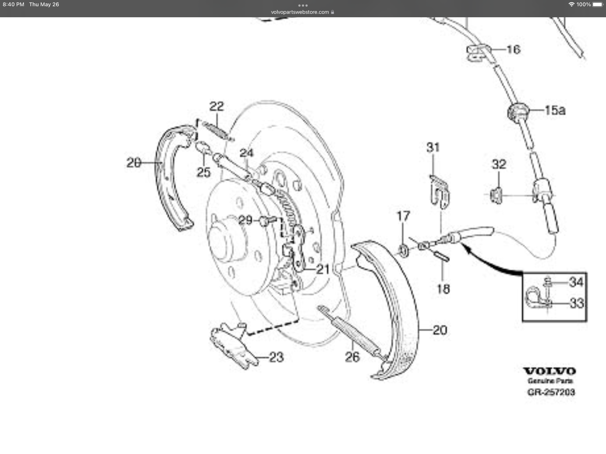

The adjuster, Holders, and springs are all the same as P80 parts and are available
17,23,31 are all NLA.., don’t lose your expanders like me. I fudged the clip with a zip tie

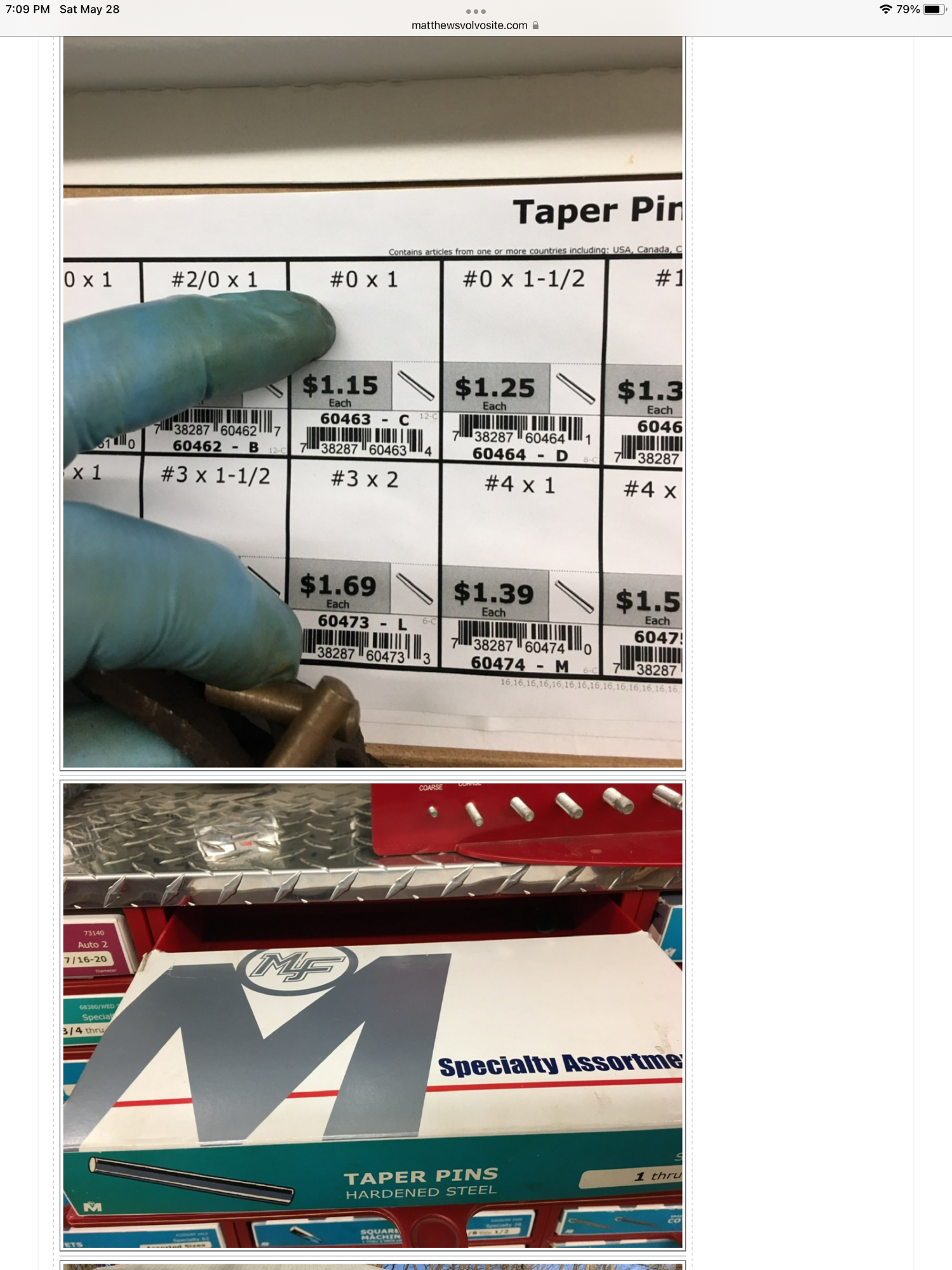

The pin is available and I have also sourced a hard pin replacement thst just needs trimming.

I have been looking everywhere trying to find. The expander. PO removed (cut one instead of removed and I found out later) the parking brakes because they didn't work but kept all the parts in a box with new shoes I swear!... Except really it was all there minus both expanders. The two 99s I have aren't awd and are too large. So these expanders are NLA eh?

So need the expander for both sides? There are more V70 XC'x out there than 'R's. Might be worth trying somewhere like VandSautodismantlers in Sacramento as they are dry state cars. They may be willing to pull you parts. Rear dust shields are also NLA so again dry state cars may be able to supply those as well.
I had some spares but I sent one or 2 to abscate so not sure if I have enough to let more go. I will try and check tomorrow afternoon when I have some time and see.

My bad. You clearly said EXPANDER, not ADJUSTER. Again I have spares but only 3 as I sent I think one or 2 to abscate as he had misplaced those for his car. I can give one after I give it a clean up to the cause. Yes the expander is NLA, you were correct.
Otherwise you will need to ask companies like Erie Vo-Vo (East Coast), vandsautodismantlers (West Coast) or even Chapman Motors on Vancouver Island Canada to see if they can pull you a pair. Chapman Motors have just got in a 98 and 99 V70XC's:

Awd parking brake shoes are different indeed.
Fcp has a good parts engine with the Volvo numbers. You can see the difference in the cutouts of the shoes in the picture above
