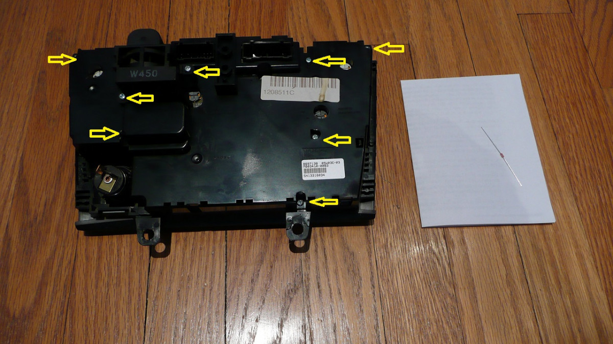

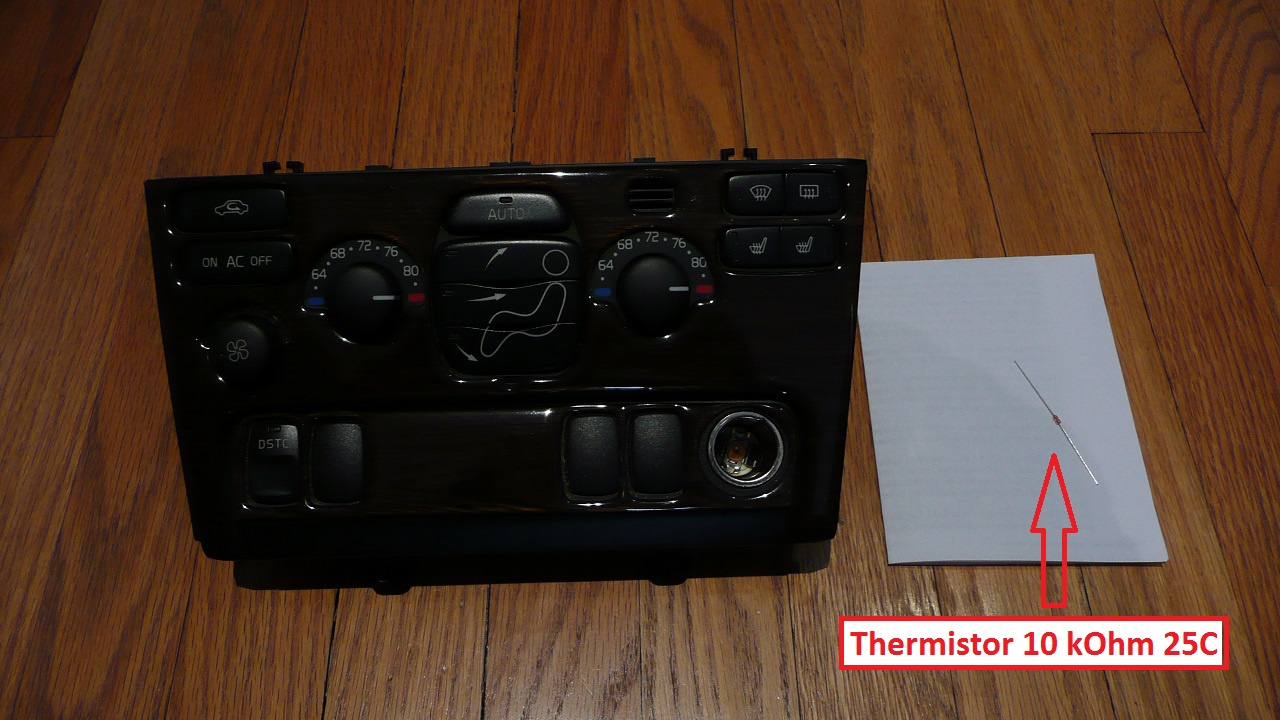

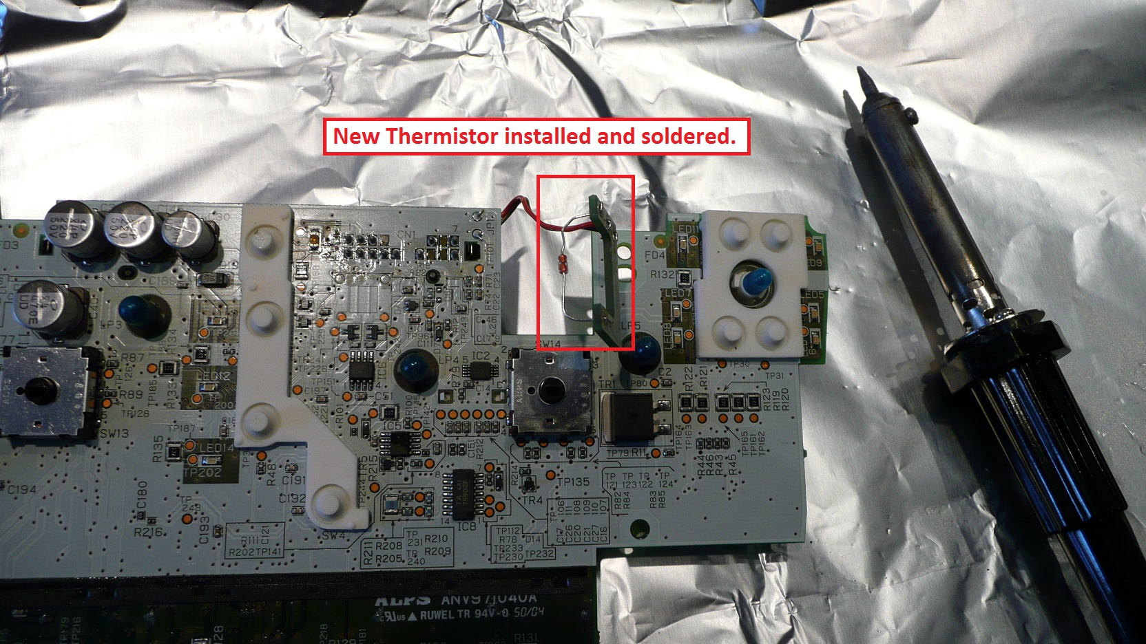

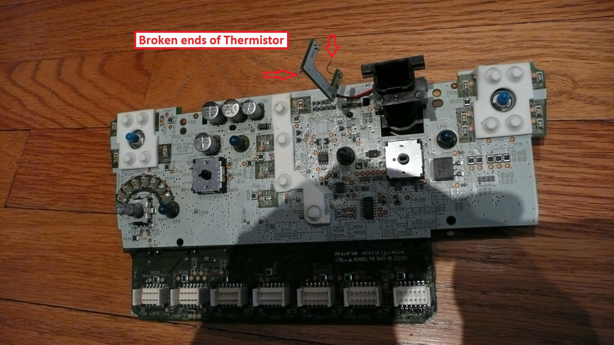

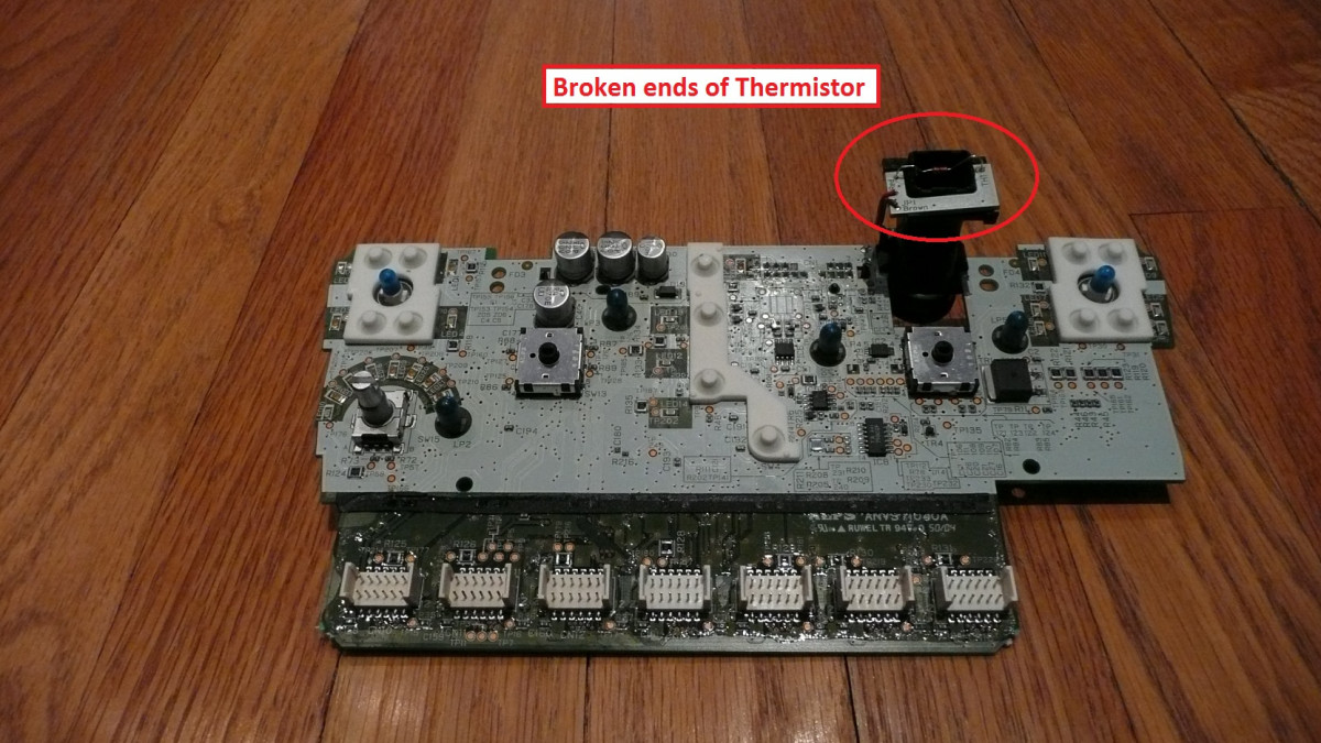

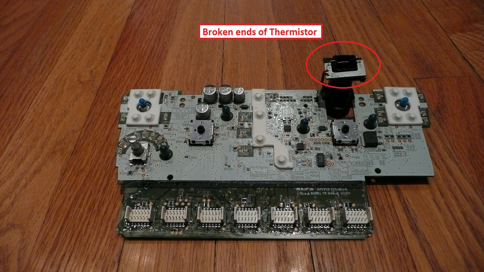

UPDATE on my 2005 XC90 2.5T HVAC Thermistor.
The Radio and HVAC panel on the XC90 is slightly different from S60, V70 but very very similar...
- Bought the Thermistor on ebay, works great:
https://www.ebay.com/itm/2003-2014-VOLV ... 4266146616
- D/C battery ground cable beforehand, otherwise you will end up with "SRS Airbag message", which can only be reset using dealer tool or VIDA laptop!
- Watch this video, best is to remove the entire Radio/HVAC unit as shown, then remove the HVAC panel as in the video:
- IIRC: there are eight (8) Phillips #1 screws in the back.
- Definitely get a second person as helper to help you remove old pins (TIP: use a safety pin end to push the old wire pin/solder out while heating with a solder gun).
- Install the new Thermistor with some extra room on both legs as shown, so the wires can go into the slots of the black holder.
- Take this time to clean the small "sampling fan" too...
- Some photos...

So far so good, my repair above using new thermistor works great.
"Auto" functions works as designed.
All you need is some basic soldering skills.
