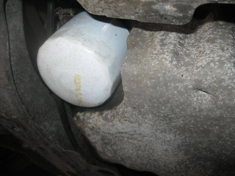

Hi,
Have you seen how the oil filter is buried in the 1998 v70? I can find a pic.
I'd be lucky to get a bag around it.
I dont like going under vehicles anymore though this car is way too heavy.

Once you loosen it, just before it starts to drip slip a bag over it and move the rubber band all the way to the top of the thin grocery bag before spinning. The S70 changed to the cartridge, not sure when in the later models and that does not spin freely as the gasket is in contact with the threads all the way down.MrAl wrote: 06 Mar 2023, 21:30 Hi,

That baggie and rubber band trick is brilliant.
Duly appropriated.
