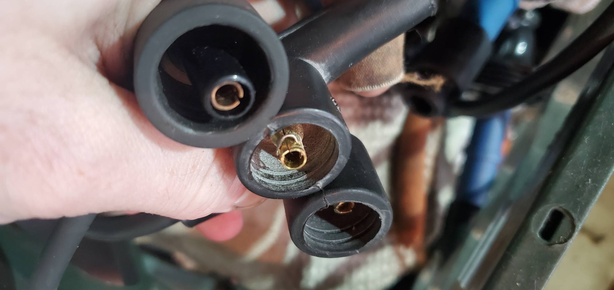

I bought a set of Bougicord spark plug wires, part number 9135700 for a 98 v70, which is supposed to fit these 20 valve cars, yet all 5 of the leads to the spark plug don't have enough reach to make good contact with the distributor. For some reason, the coil to distributor wire isn't as recessed in the rubber boot and clicks onto the posts of the coil and distributor and stays on snugly.
Top is one of the new bougicord spark plug leads, middle is the bougicord distributor to coil wire, and on the bottom is the old wire of unknown brand.

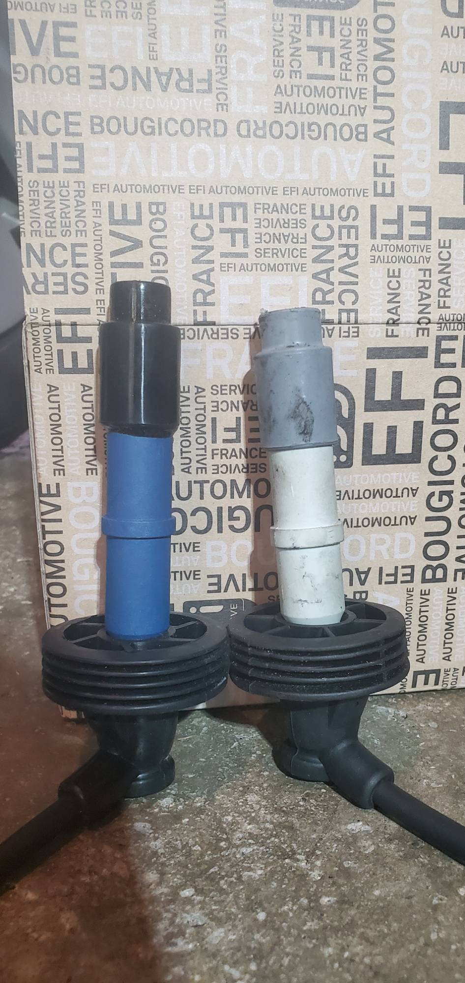

The plastic boot that fits over the spark plug is also longer too, and caused the rubber boot to be sticking halfway out of the head instead of flush like with my other cars. Top is the bougicord, bottom is the old wire.

There have been at least one or two others that have had this issue in the last 6 months. The 10V and 20V are different.

The white and gray boot is how they should look. Send them back!

It looks like what happened to me. I bought through FCP, and was shipped 10-valve parts. I think Bougicord mislabeled some boxes. FCP replaced them, on their dime, and did not have me ship the wrong wires back. The second set was correct, and is currently on the car.
I shipped the wrong wires to a board member in Australia, since he has a 10-valve. Unfortunately, they ended up being wrong for his car, too. Apparently for a short time Volvo used a different connector on the distributor cap and he had the other design.
