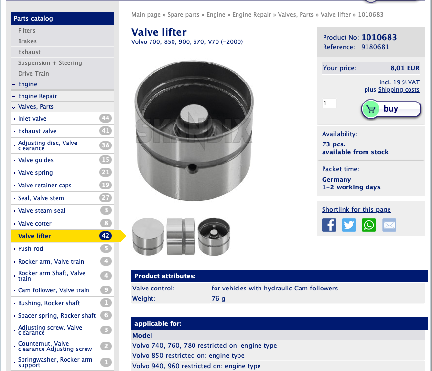

I asked before, but it was mixed in with other questions so may have been missed. I know the US as far as I know did not have the 10V engine, but for anyone that does, do you know if it has hydraulic valve followers/tappets? From this Volvo drawing on a Canadian Volvo parts site it looks like it may be. AS I have never stripped an engine, let alone a hydraulic tappet version , can anyone tell me if this looks like one in the picture, part #22a:

This is part 22a
Volvo part number 9180681
