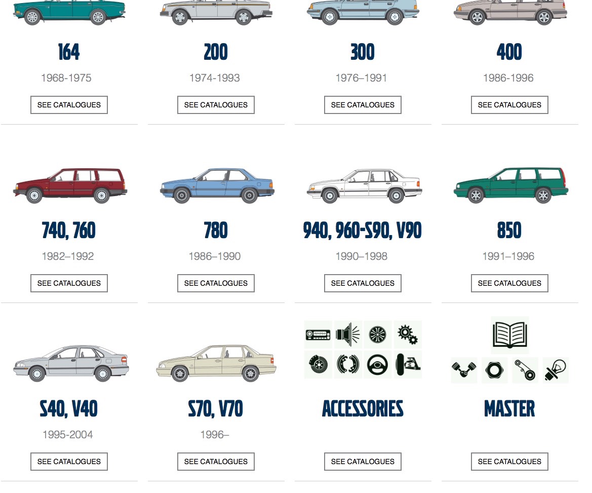

scot850 wrote: 18 May 2023, 10:07 Volvo does not really care about the older cars. They sold all their pre-2000 stocks to a company in Sweden called GCP (gcp.se). They mostly run the stock out but do occasionally have new stuff made if enough interest is made and the OE supplier is willing to do so.
Are the moldings all the same for all years? There is a bunch of P2's in the local junkyard just now. I won't have time to go thee soon but will look and pull any that are there that look ok.
Great link, Scott. Mine are black if you see any. Or I can paint them.
But it seems there is a gap between P2's and the last V70/S70 lines...
