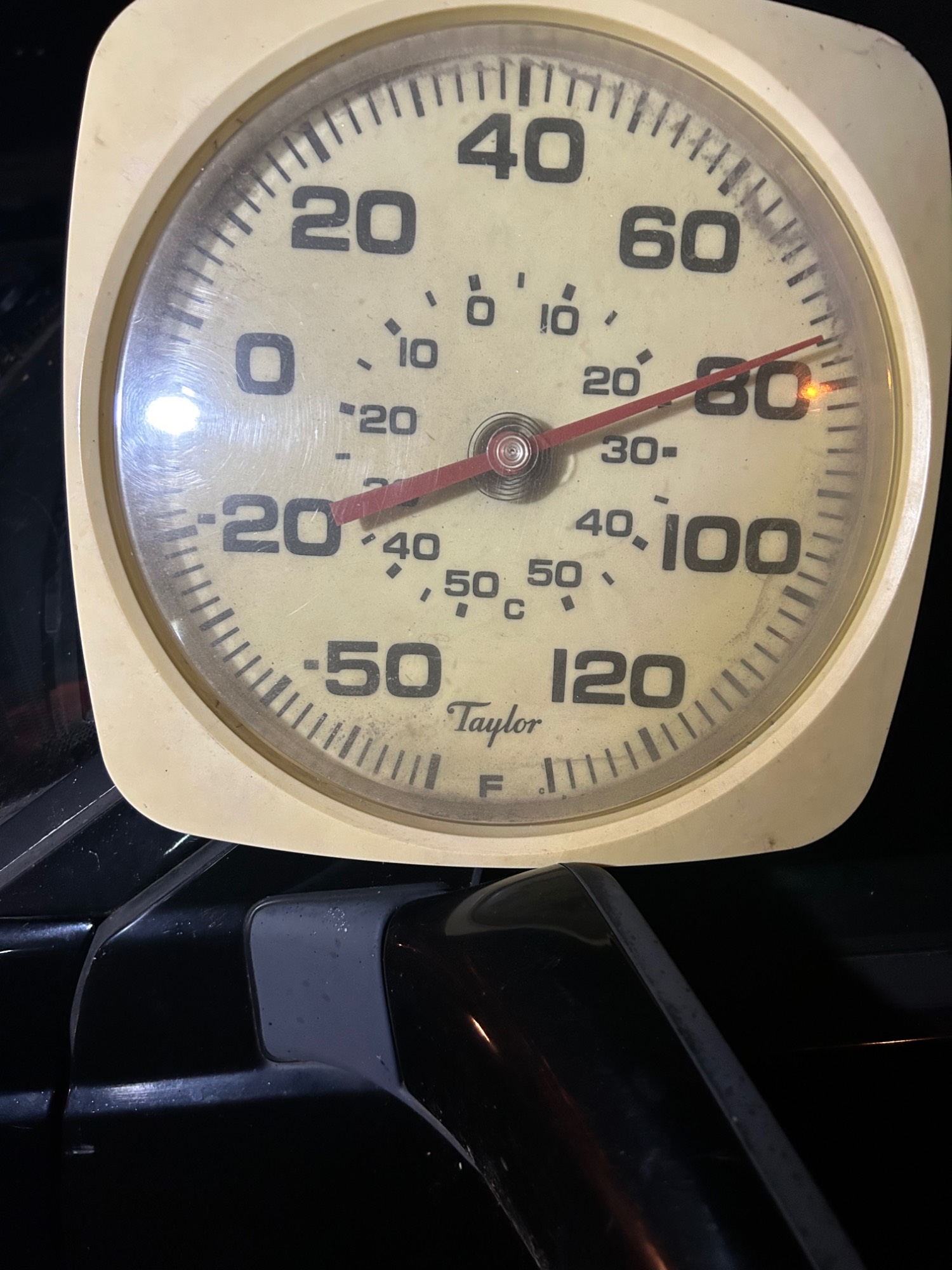

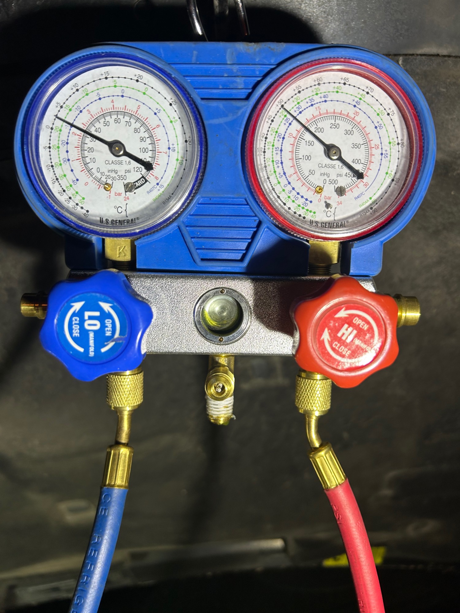

Engine warmed up, AC compressor running with fan on highest setting.
Permission to charge, captains?

75 F, 15 PSI low, 135 PSI high? According to internet charts, R134a at this temperature should be 35-45/150-170 PSI. I would add a bit and see how it goes.

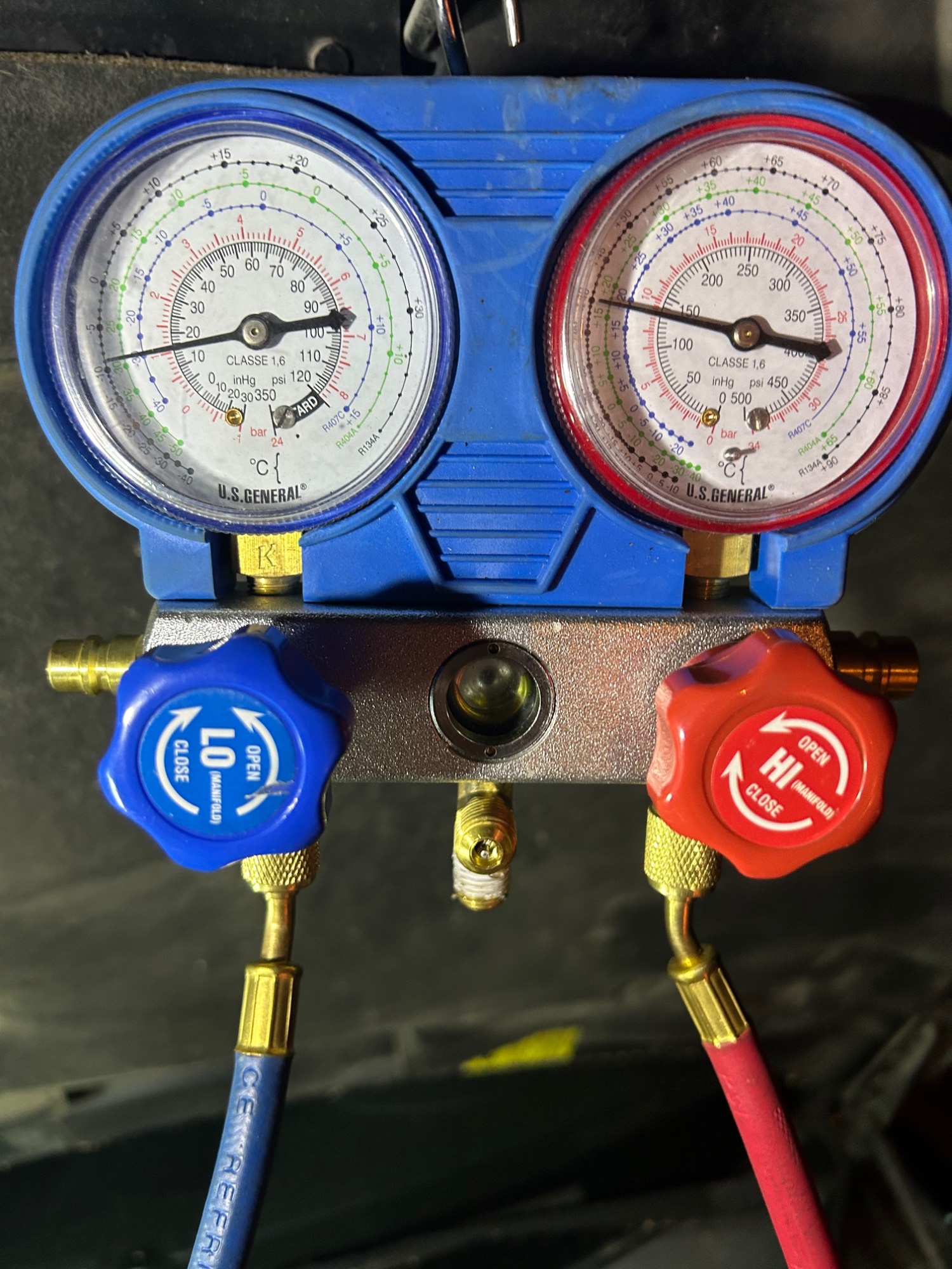

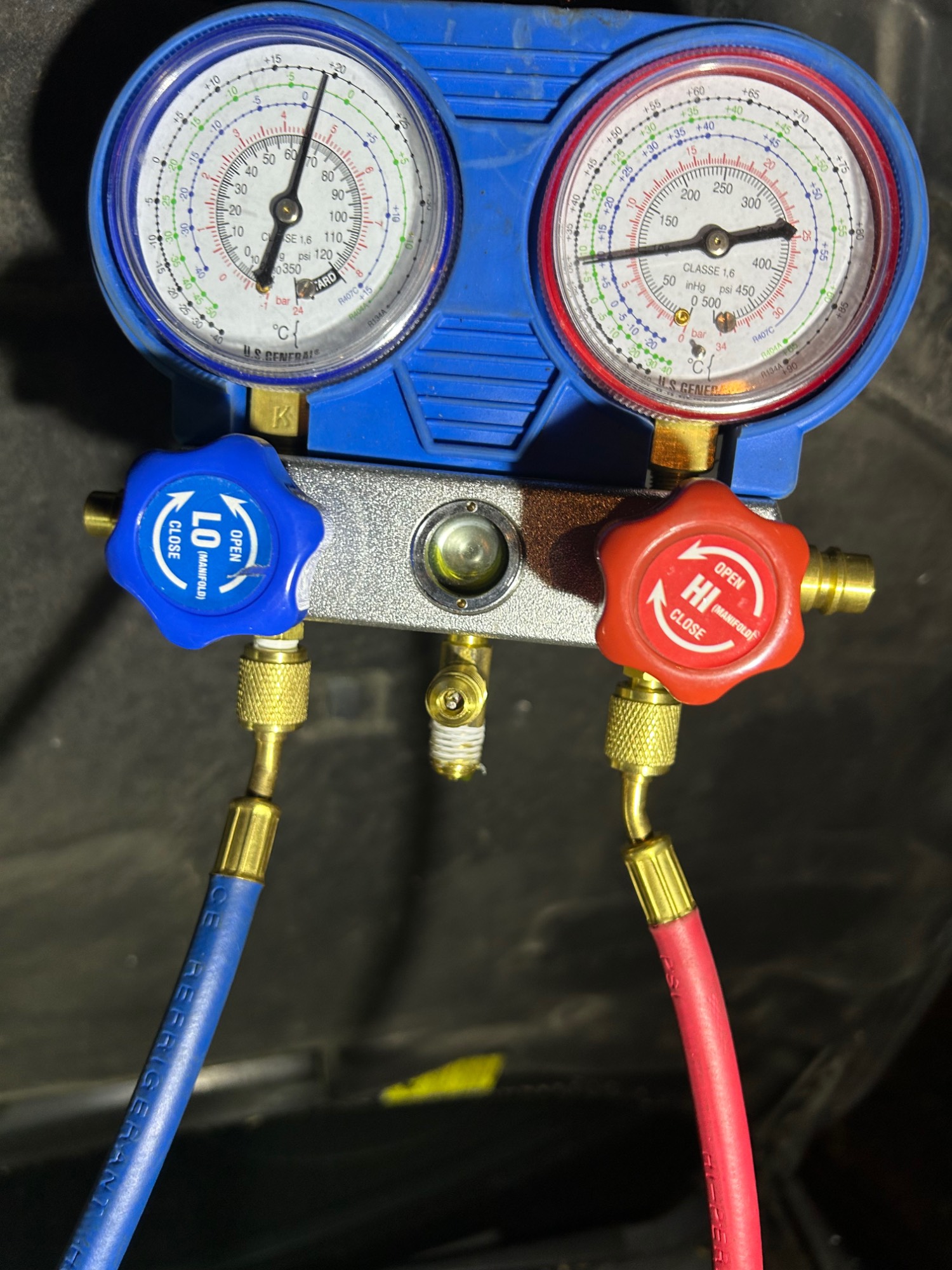

Was checking psi as it charged and ended up finishing off the open can I had, about 8 oz (2/3 of a can) added overall. Definitely colder now on the driver's side so a big improvement but it still seems warmer than the passenger. We'll see how it holds up under demand. Readings are now 32/175 at 75 F.
Is it peculiar that the static pressure (engine running, AC not running) readings are not the same on low (65 PSI) and high (100 PSI) side? Seem too far apart to just reflect gauge (in)accuracy.

erikv11 wrote: 20 Jun 2023, 22:15 Is it peculiar that the static pressure (engine running, AC not running) readings are not the same on low (65 PSI) and high (100 PSI) side? Seem too far apart to just reflect gauge (in)accuracy.
The high/low temperatures are different, so vapor pressure is different. But high side will eventually boil off and expand to the low side if left undisturbed.
