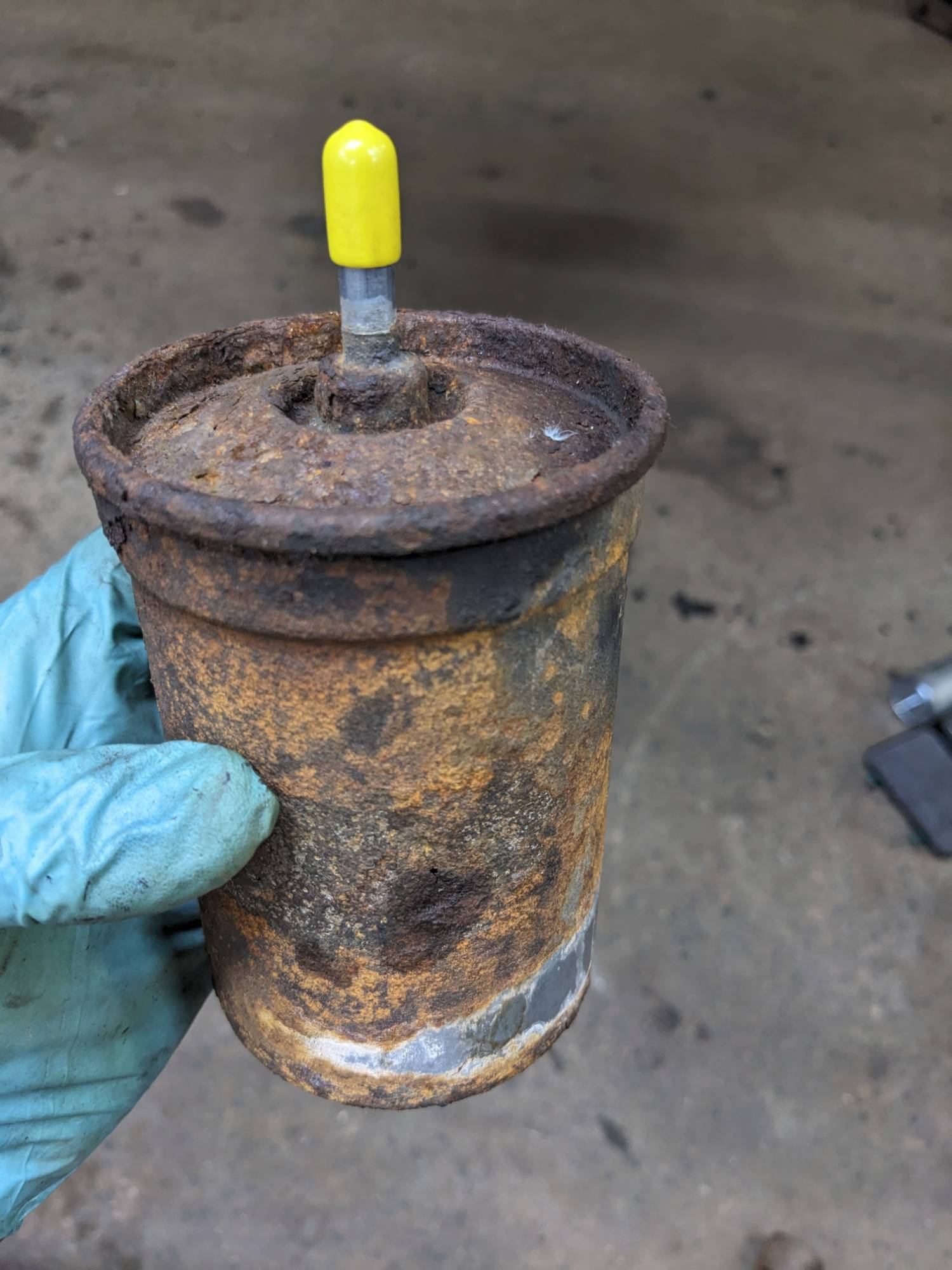

I found the source of the fuel smell which lingered around poor Geronimo. The excessively rusted fuel filter had a small hole in it. Good thing I had a new one ready to be installed. Of course, when I began unscrewing the bracket holding it, that put pressure on the breach causing fuel to start dripping out. And when I worked to remove the filter, a shower of fuel soaked rust fell all over me and my gas collection cup. I was so ready to do a clean job having learned the sequence from doing it on the G70. Things don't work that well on Geronimo.
The fuel filter is a little loose in the bracket. Perhaps a layer of bracket metal rusted away, opening its inner diameter. Any ideas how I could pad the gap between filter and bracket? I believe the bracket was recently discontinued (though I bought one in mid 2021).

- Fuel filter with hole
- PXL_20230708_015211974.jpg (273.8 KiB) Viewed 419 times

I hereby nominate that one for the Titanic part thread….amazing that it rusted and holed under the clamp, saving a major fuel spill
A strip of thin rubber sheet should do the trick for the padding. Trying to remember what I used
I just moved Evitas fuel filter job up the priority list
Is it too late to bag that one and send it to me for this thread?
viewtopic.php?t=95661&hilit=Fuel+filter+autopsy

HA! You can't fool all of us. You are going to reuse that filter to failure!abscate wrote: ↑08 Jul 2023, 02:48 I hereby nominate that one for the Titanic part thread….amazing that it rusted and holed under the clamp, saving a major fuel spill

Face the hole down , JB weld a hose to it, and feed it back into the tank! Free filtered gas!

I'll pull it out of the scrap metal bin for you. I spent a good amount of time draining the gas out. It would be interesting to autopsy this filter at likely 350k+ miles, 23 years, which ran the cheapest gas for many recent years. I have no way to store it so how can I get it to you? Could try the postal service if I properly disclose.

That filter looks a lot like the one on the 850 I was working on. I declined to swap it in fear something would break trying to remove it! I did at least wire brush the inlet/outlet areas and PB blasted them a couple of times, but don't think the owner has had it changed yet!

The filter is a 105k mile replacement item. Averaging driving, that’s 8 years. We probably have a lot of p80s in the 150-250 range on their second filter, when they should be on their 3rd or 4th

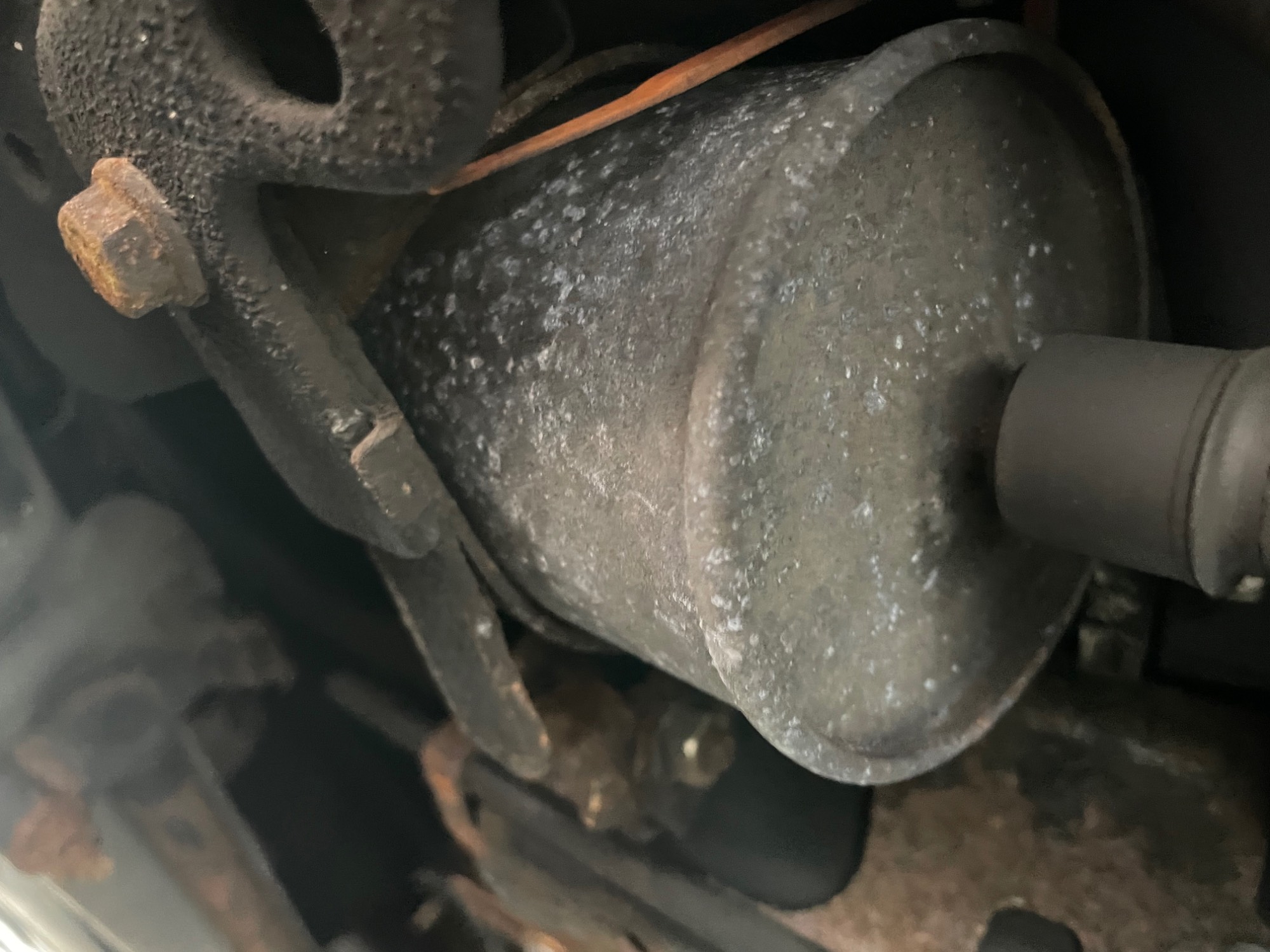

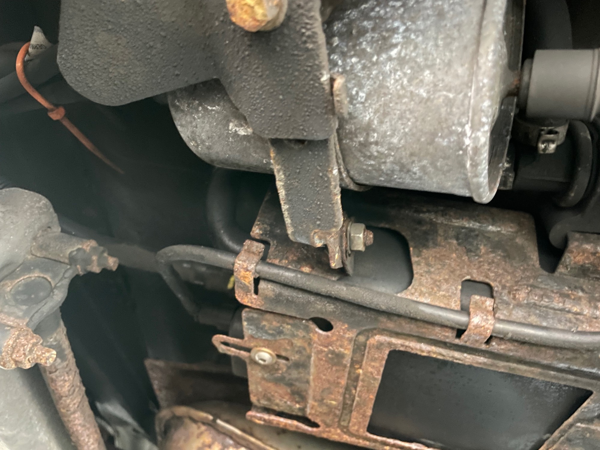

I inspected Evita as today, not too bad
- IMG_5348.jpeg (453.63 KiB) Viewed 313 times
- IMG_5347.jpeg (531.25 KiB) Viewed 313 times
