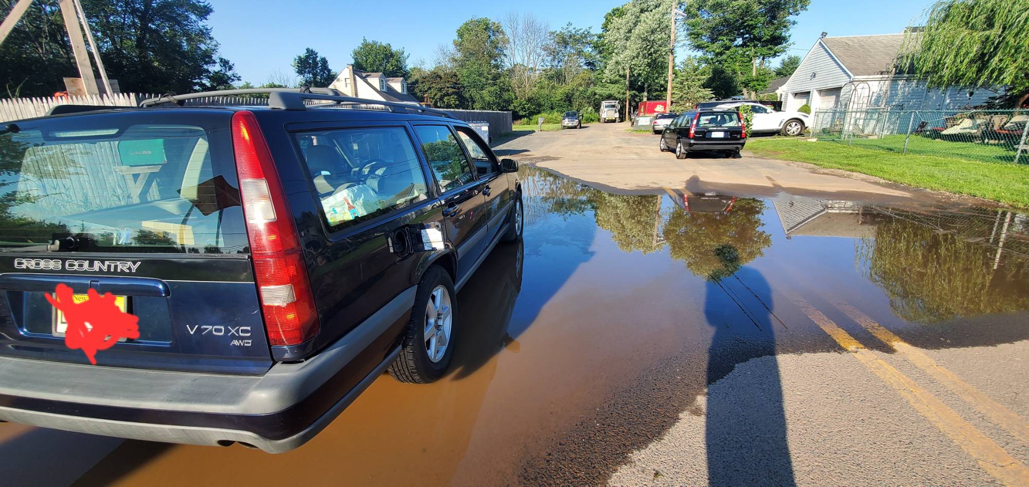

As far as other things, I went to buy another car today, which I knew was burning a bit of oil, but on the test drive it drove great, I figured if I nursed it home 100 miles I could tinker away at it.
Died due to lack of gas 3 min from sellers house, miles til 0 said 40 miles. The seller graciously came with 2 gallons in a can, and the car started right up after a jump. It drove great, I pulled into a gas station, filled it up with super (the attendant did, thanks New Jersey....) and started right up.
Check engine light popped on and engine running a little rough(upper torque bushing was shot), so I pulled into a lot, and parked on a bit of a nose down slope. After that, car would crank away, no start.
Tried jumping it, swapping idle air controller with my other 98 V70XC, unplugged MAF, spray cleaned MAF, checked for spark, heard the fuel pump kick on, a mechanic came over and tried, could not get the thing to start, just an occasional sputter.
It got dark and then it got late, didn't think to check the fuel rail Schrader valve before heading home.
Codes that came in were for cylinder 4 injector low signal, and cylinder 4 injector open circuit. I tried unplugging it and starting the car, but no dice.....
Picture of my latest mistake and my previous mistake.

jsrnsis wrote: 21 Jul 2023, 21:48 Picture of my latest mistake and my previous mistake.
Saw the pic, immediately thought it was an epic fuel leak. There's your "no start" right there. Good luck with it.

FireFox31 wrote: 21 Jul 2023, 22:21 Saw the pic, immediately thought it was an epic fuel leak. There's your "no start" right there. Good luck with it.
If you mean the giant puddle, it's my luck to end up in a couple inches deep of muddy water outside someones junkyard, if you mean the film on the mud, from where it was coming from I thought it was tire foam/road grime seeping off the tires or kicked up from the bottom of the puddle.

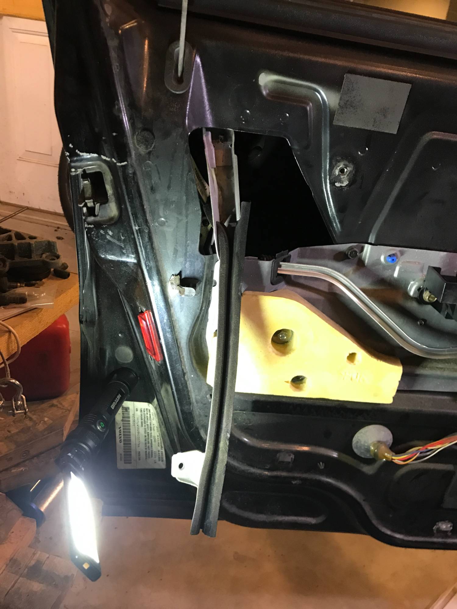

Drivers' side window wouldn't go all the way down on the new-to-me 850; that's an inspection fail in DE, plus a rattle on closing, which is a fail in my view anyway.
Some door card fasteners goofy or missing, a few bolts loose, new door speaker obviously installed by a Tuner Tunes Shop, and in the bottom of the door:
I was out of time, patience, and heart, so I put the track on the spare parts shelf and put the poor thing back together. Window goes all the way down.

Has the bracket broken off the back of the door? That is what usually gives a hint either the rivet or bracket has broken. The 850 uses a Torx bolt to hold the bracket if I recall and the V/S70's use a rivet. The brackets are interchangeable, but the mount on the door is. Rivet or bolt.

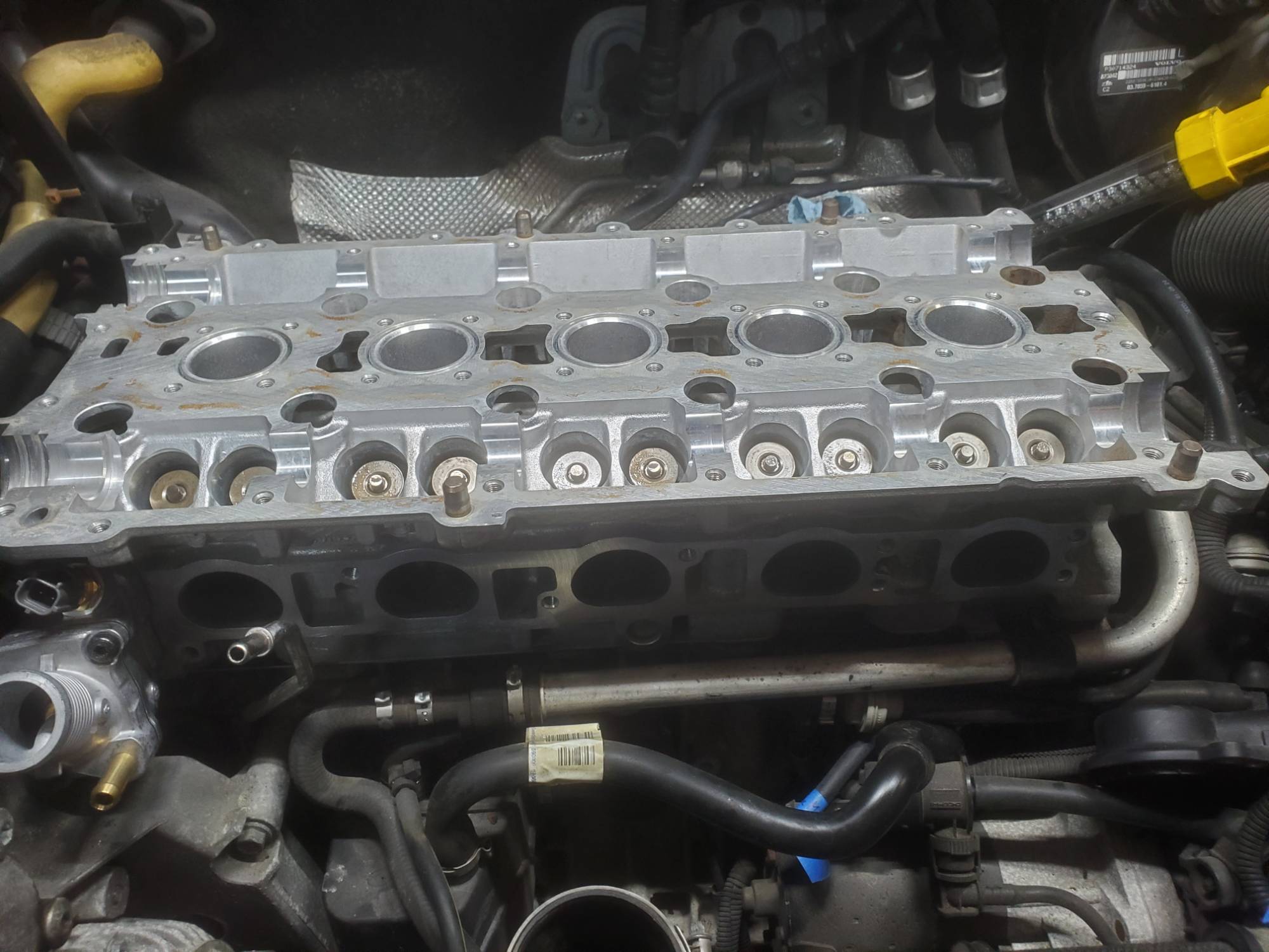

Today's milestone. Cylinder head is in place and torqued down. No broken bolts today. 36 inch breaker bar made quick work for the last torque step.
