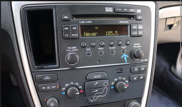

I think so.
Screenshot 2023-07-31 210055.png (517.62 KiB) Viewed 336 times
If you press on the button, it should pop out. Then you can twist it. If your volvo has fader and balance combined into one knob (label is "fader/bal", then you can pull on it after it is popped out and it clicks so you can ajust the other setting. I dont remember if it is fader or balance ajustment before or after you pull on the knob.

Thank you so much! I can’t believe I’ve owned the car this long without knowing those knobs actually turn. I’ve been wondering what they did. Such a stupid problem but it’s fixed now! Thanks again!
