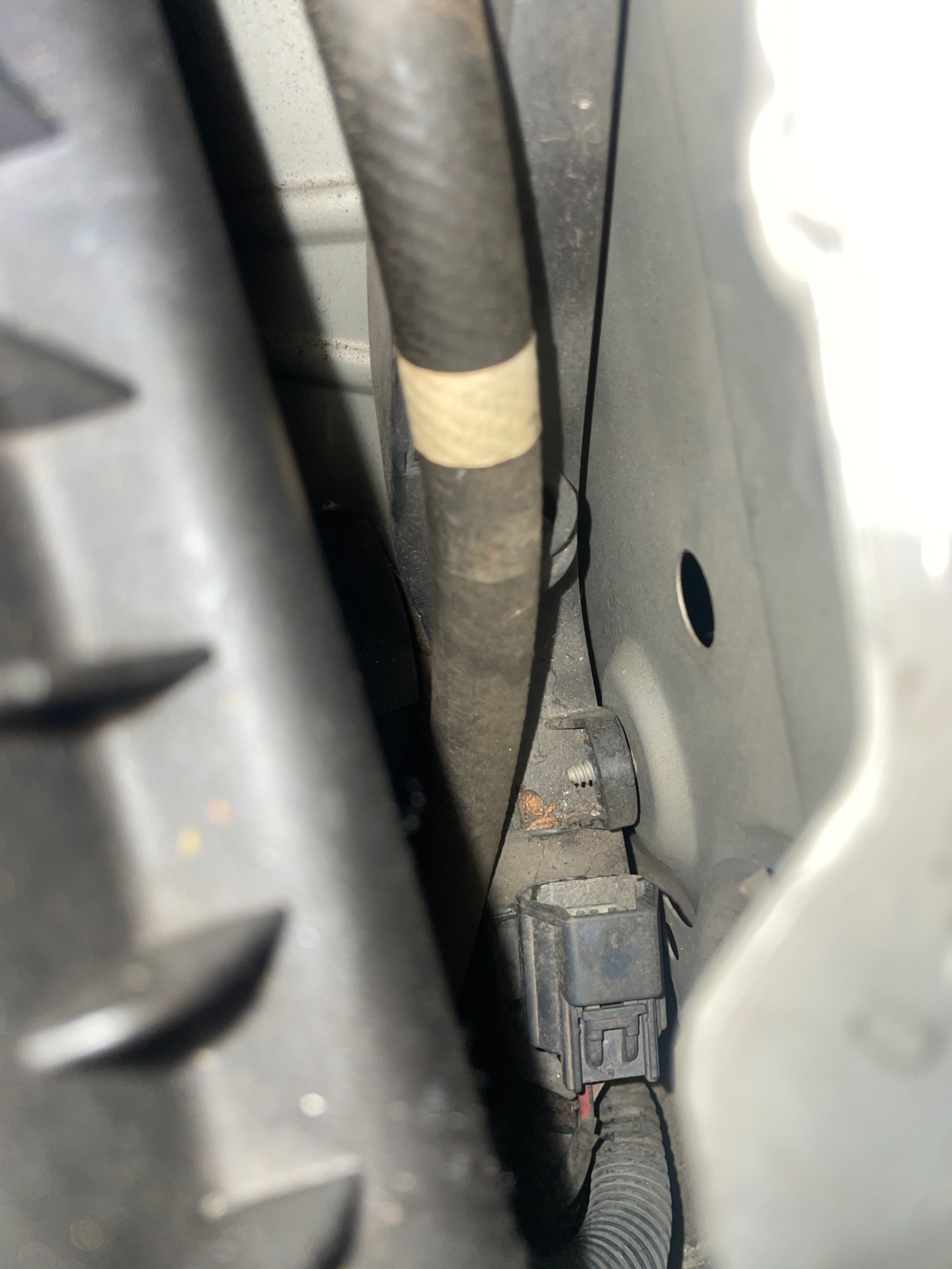

So my car has two minor but annoying issues. The first is the common: “alarm system service required,” and the second is that the lights don’t flash when I lock the doors. I’ve tried all the tricks I’ve seen on here such as reshutting all the doors and clicking the yellow button on the key fob multiple times, no dice. I found two connectors in the engine bay that aren’t plugged into anything, could anybody identify them? The first is right below the transmission cooler line coming from the radiator. The first is directly to the right of the airbox with the air filter. The second is right below the transmission cooler line coming from the radiator. Thanks!!
