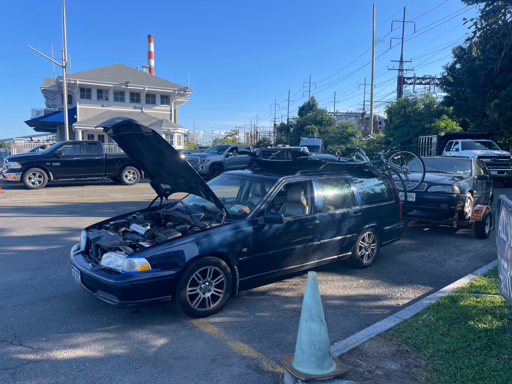

Gerominos fenders and hood were duly transported from NY to NY last night , getting closer to their destination
Volvo hoods are hard to load solo...
Cooling off a hard worked NA motor

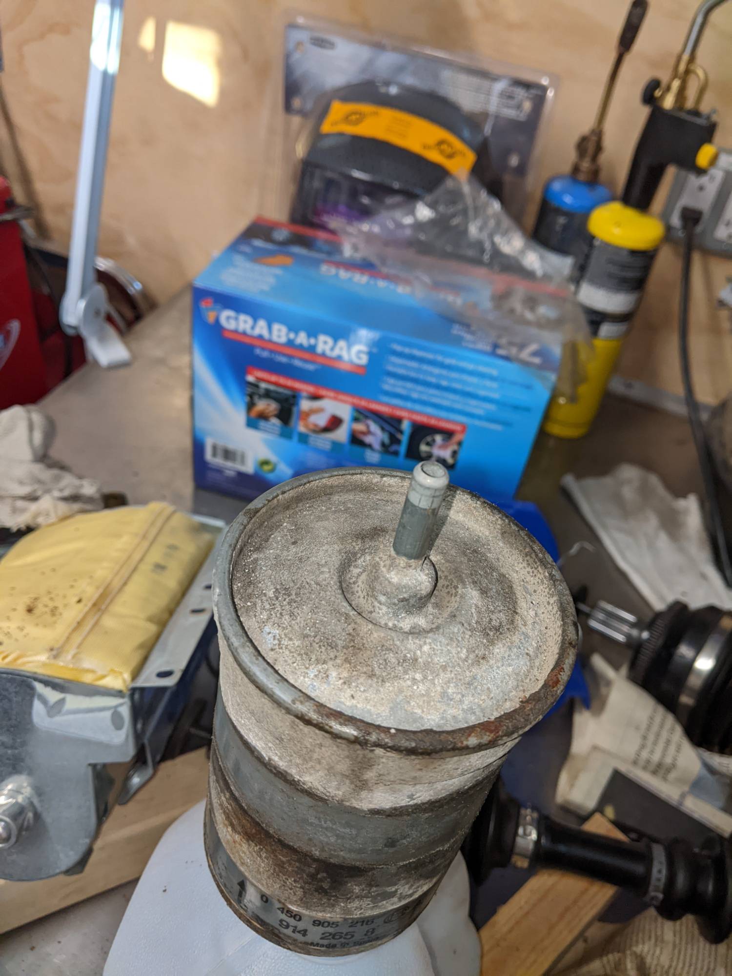

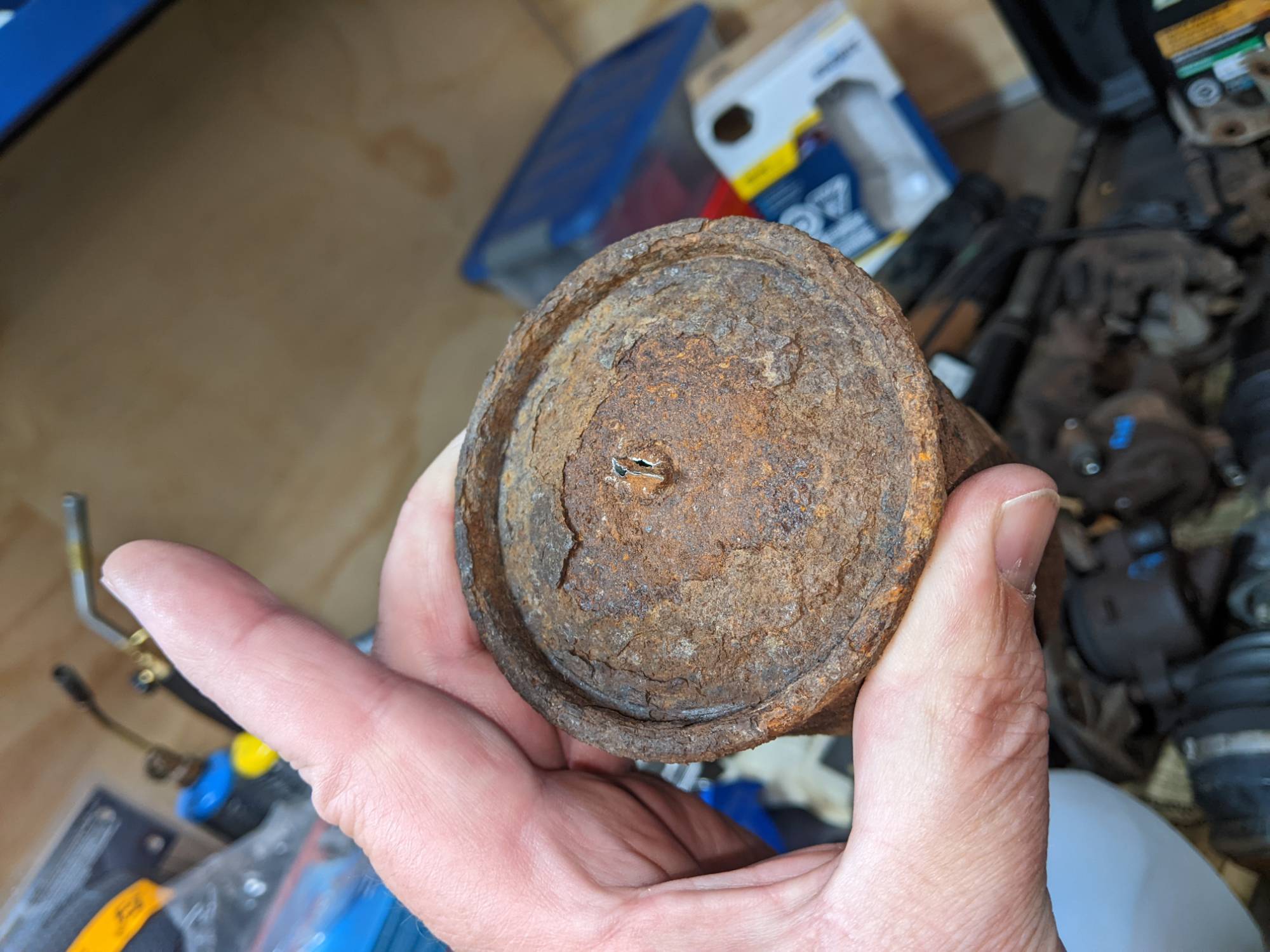

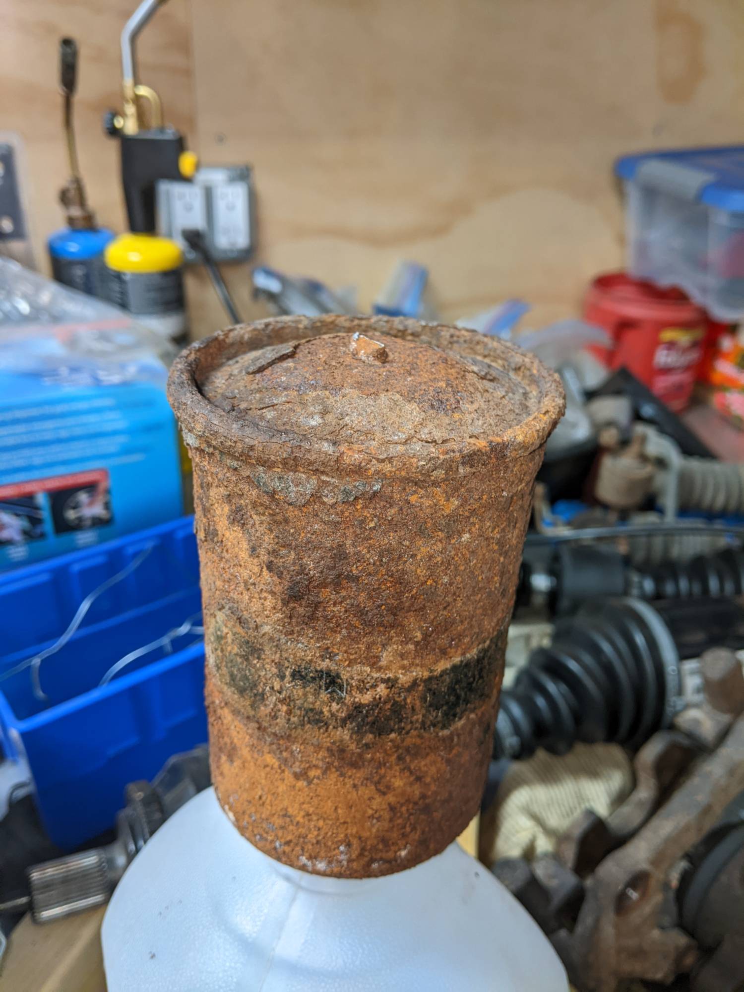

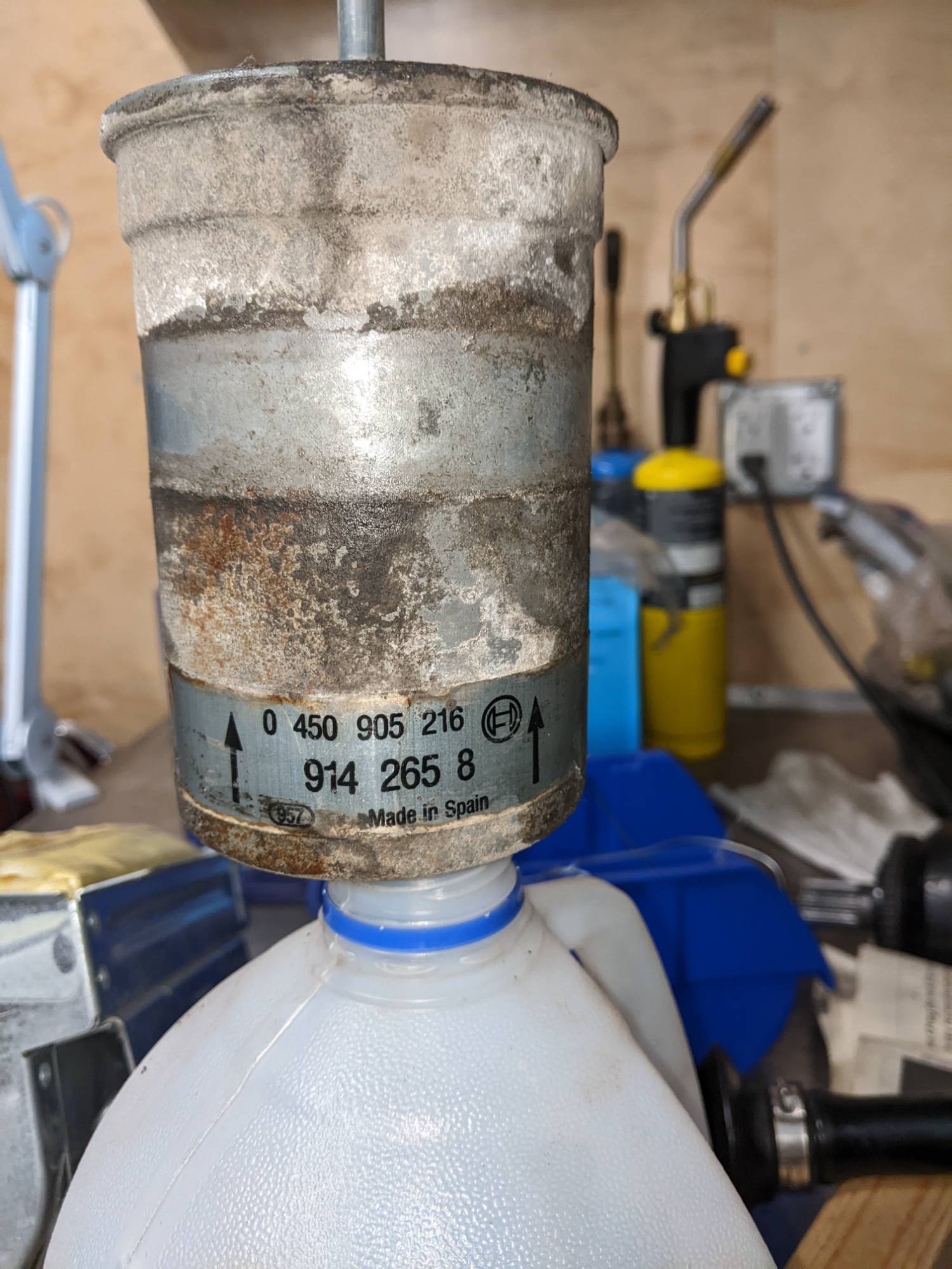

Firefox asked me to add the fuel filter pictures of the 2 fuel filters that we swapped out yesterday for comparison to the one Firefox removed that was pin-holed. The first 2 pictures are the 'Titanic' sourced filter from the 96 850 NA base. Brand is unknown
Next 2 are from the 97 850 AWD and had about 60,000 miles and 6 years under the car. In fairness the 850 one is tucked up high above the rear axle, where the FWD is just forward of the RHR wheel. The part number was 0 450 905 21which is a Bosch part number:
Both cars were fitted with new Mann WK 849 fuel filters. I both cases we had to pack out the circular holding brackets to keep the filters held tight as the bracket could not tighten far enough! The 850 bracket was actually ok and some surface rust on the outside but the inner side was still good and had the dimples that dig into the filter to hold it.
Hope this is of help.
