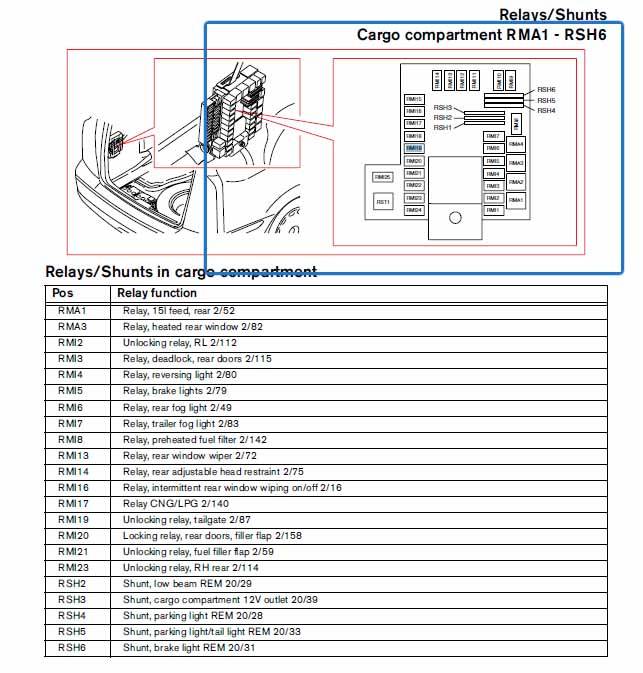

I've had my 01 V70 T5 for 9 years. Recently, I tried to lock the car with the remote and all 4 doors lock properly, but not the tailgate. One can just open the tailgate, and then sometimes the security alarm does sound. There's no audible click either at the tailgate when trying to lock the car. I've been searching a bit, and a few recommendations say that the harness wires may be broken where it passes through the left hinge area. The fuse is good. Other ideas?

Broken wires in the left hinge area is a known problem. Do you have any other problems with the tailgate? The wires going through the left hinge area will affect the rear lock, license plate lights, rear wiper, upper brake light, tailgate open (ground wire through switch in tailgate latche), rear defroster; do you have any problems with any of these other items mentioned? If so, likely broken wires in the hinge area.mp5802 wrote: 22 Aug 2023, 17:29 I've had my 01 V70 T5 for 9 years. Recently, I tried to lock the car with the remote and all 4 doors lock properly, but not the tailgate. One can just open the tailgate, and then sometimes the security alarm does sound. There's no audible click either at the tailgate when trying to lock the car. I've been searching a bit, and a few recommendations say that the harness wires may be broken where it passes through the left hinge area. The fuse is good. Other ideas?
There's also a relay associated with the rear latch, see attachment, RMI19
