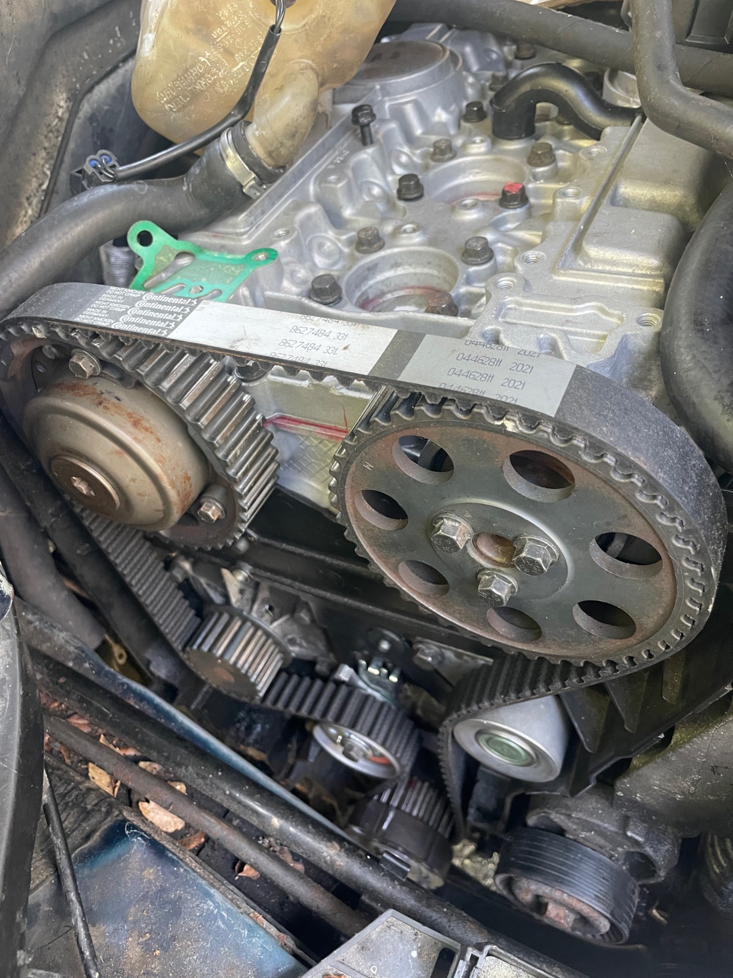

Braced my self for one hour in heat and managed to get her timed. Then went inside, faint from heat.

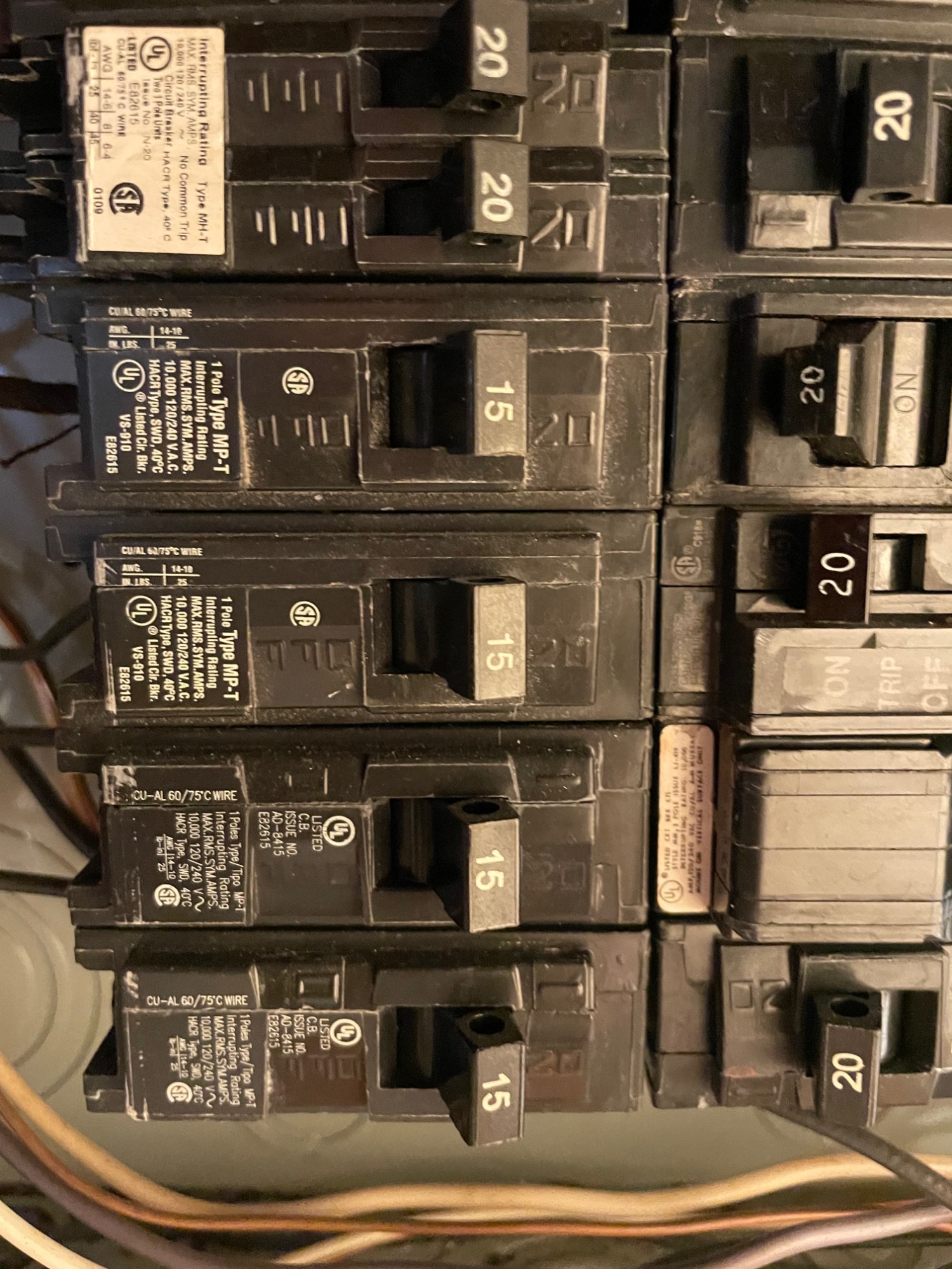

Went inside and replaced that wanky circuit breaker on kitchen side

No wonder those breakers a 'wanky' more like 'wonky' Half of them are upside down............!

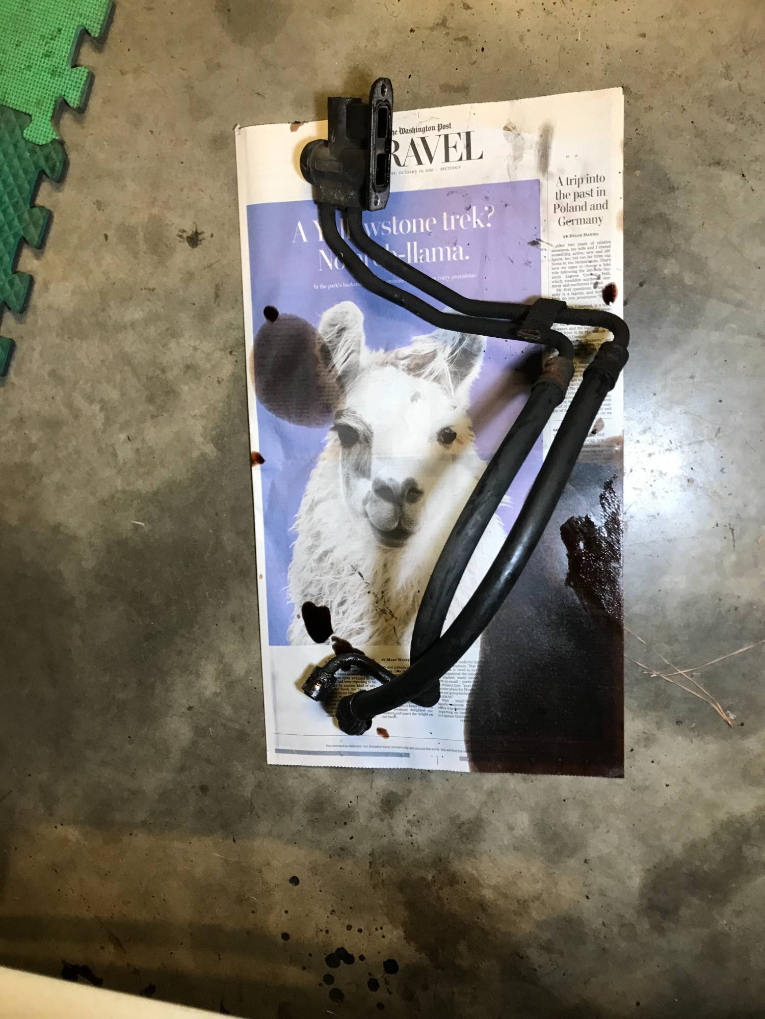

If I ever actually get to Gothenberg one day...
...and happen to run across the engineer who designed the oil cooler line clamp, somebody will have to hold my beer, because there's gonna be a scuffle.

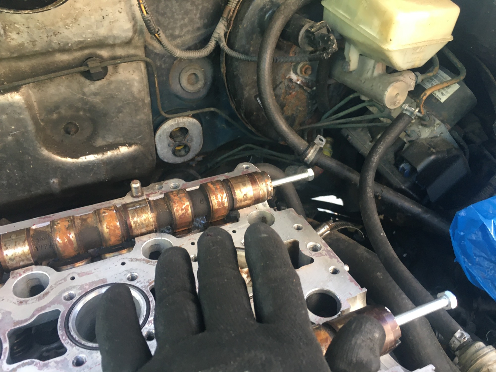

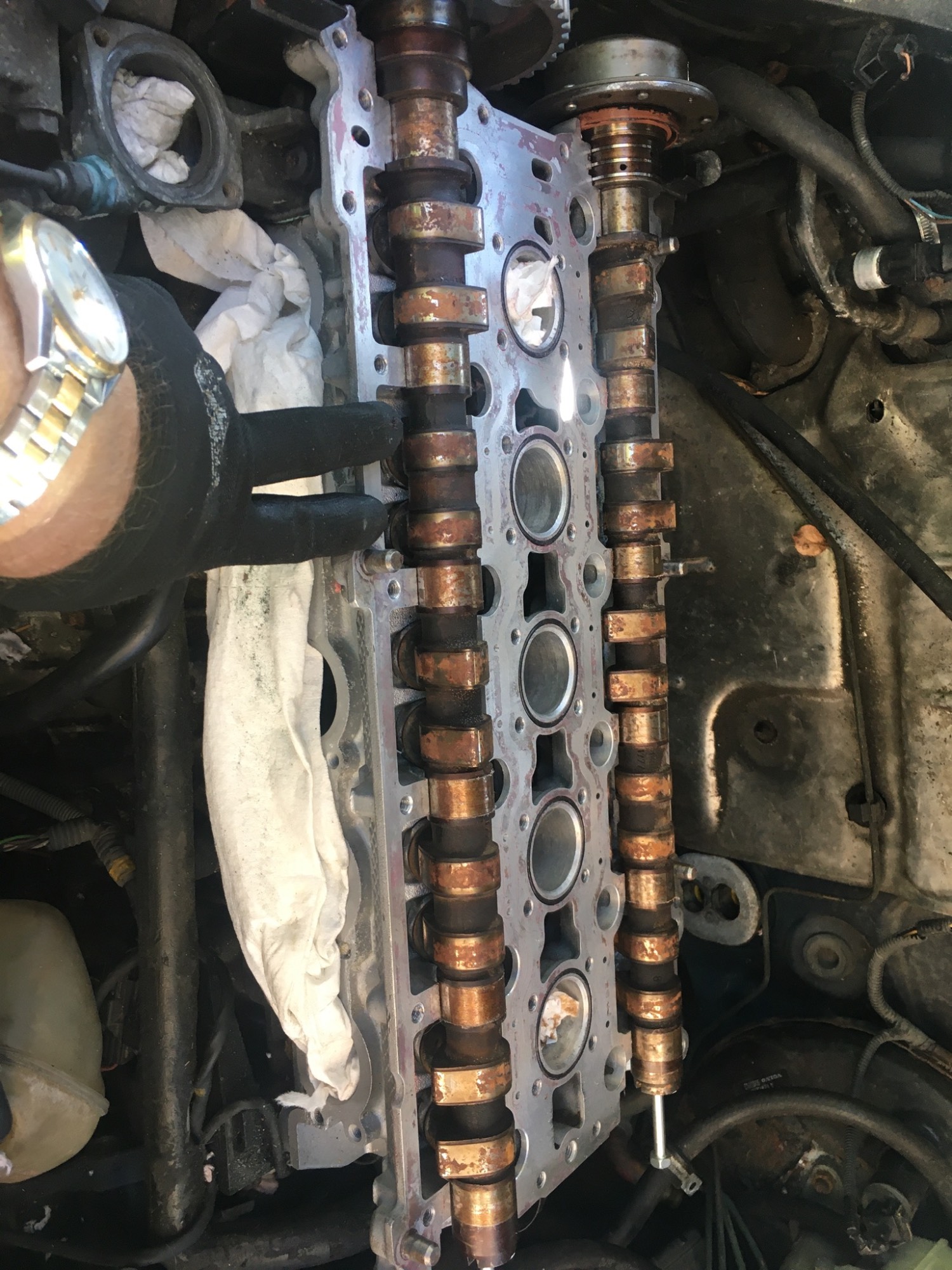

Zion, two small c clamps mid head will draw down the head easily. I actually prefer this method as I don’t like having spark plug holes open once the head is on. Once the head is down, eight bolts into the number 2 and number 4 cylinders will hold it down fine. Then zip in the other 35. Not very tight, the anaerobic sealer does the sealing work
Most put down too much sealer just a pea dab every 10 cm or so, then rolled to a film. You DONT need a bead like an RTV application
FYI the tension comes from intake 2 and exhaust 5 when the cams are at their marks on the RN engine, see pictures.
