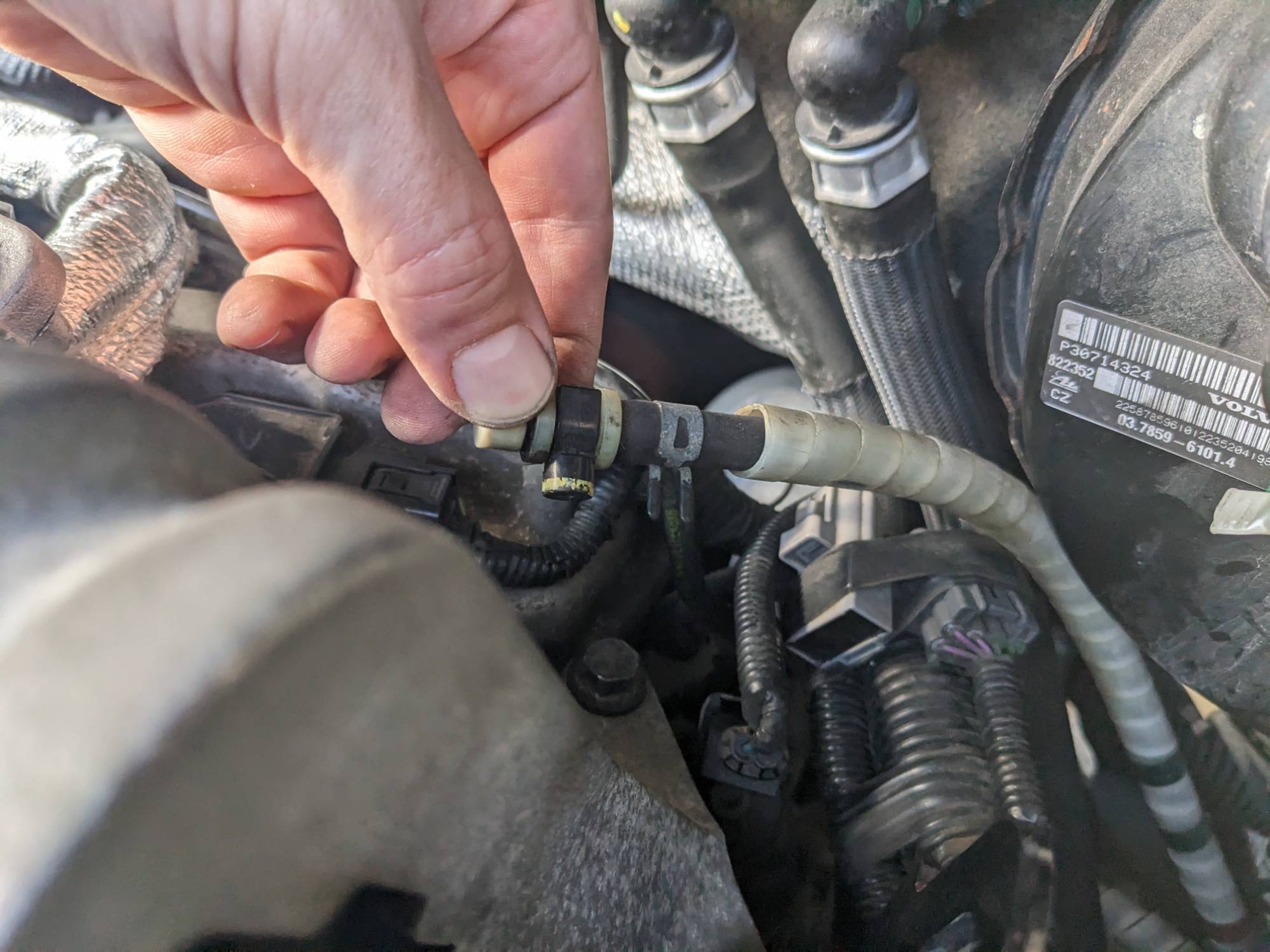

Investigating an occasional gas smell in the cabin and minor sluggishness. Noticed a hose that's not connected to anything :shock:
I see another similar hose beneath the starter but can't tell where its coming or going to without disassembly.
What hose is this and where is it supposed to connect to?
Is it damaged?
Thank you

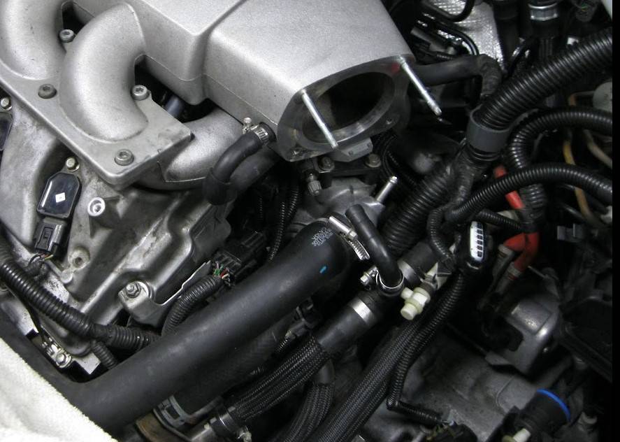

Sorry, just saw this. Hard to locate off the cuff, had to go back into some reference photos.
Guess it's a breather, probably for the transmission.
Breather Hose B8444S.jpg (70.48 KiB) Viewed 268 times

I agree, it's a breather for the transmission. Mine just kind of flops around in the vicinity.

Thanks for the pic. So if I'm seeing that correctly, yours is floating in space, not connected to anything too?
There is what appears to be a spring loaded valve on the end, and it comes from down near the transmission area so that lends to the idea its a trans breather hose.

Post by paz5050 »
Oh just saw Roger's post too. I guess its settled. Makes sense bc the car has been running relatively fine. Thanks lads.
