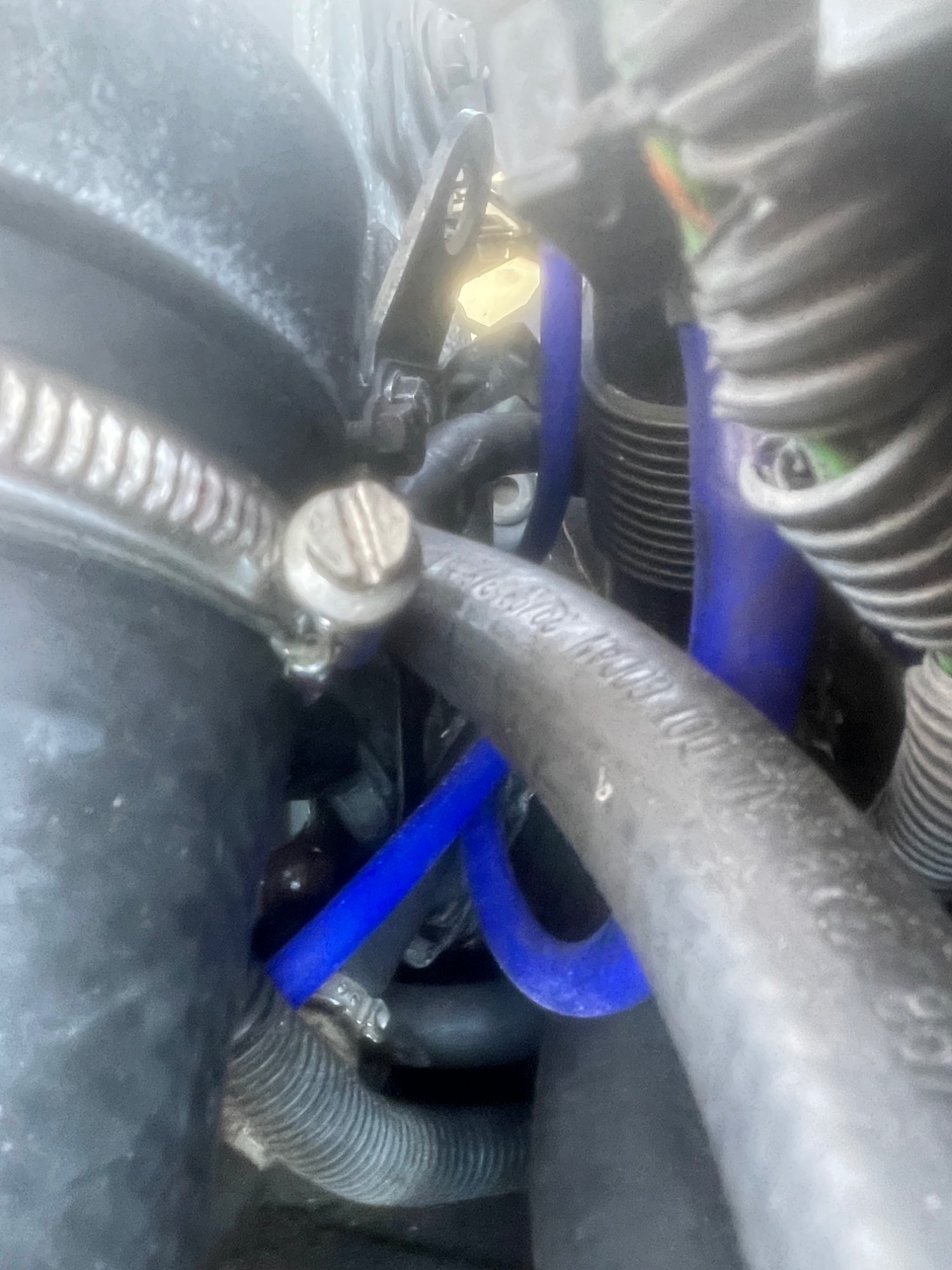

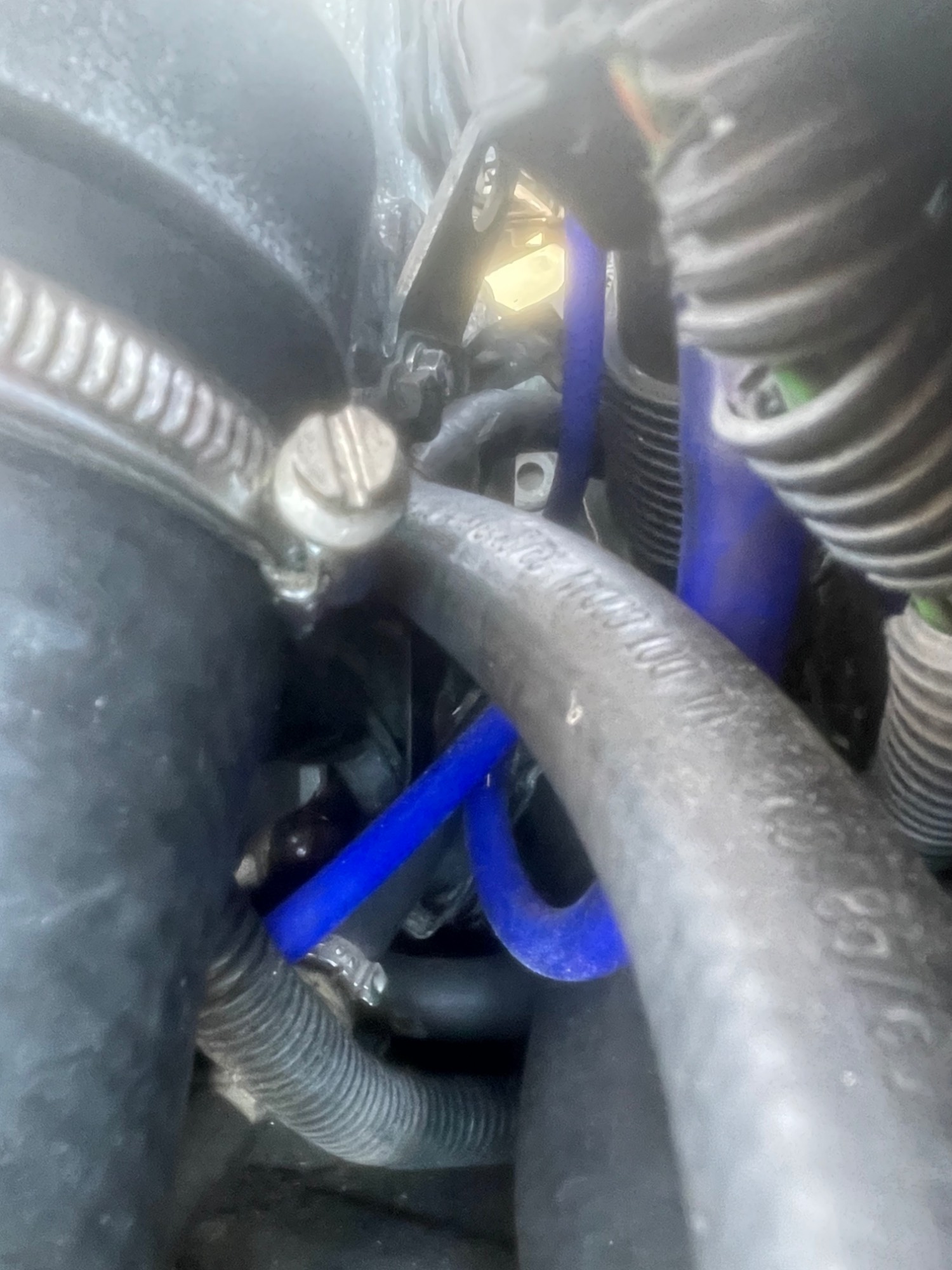

This is the coolant banjo off the PCV manifold that mounts on the rear of the cylinder head? I’ll snap a pic this morning

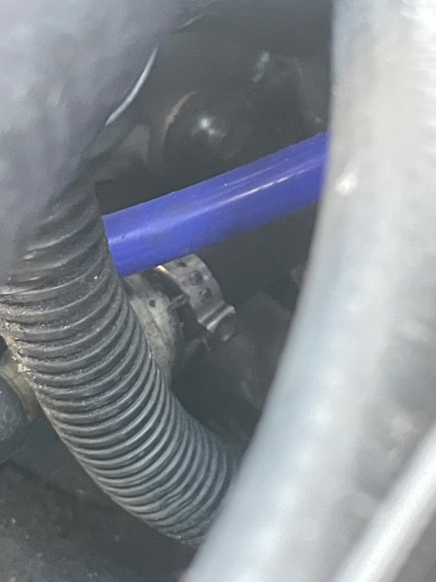

Well, not sure if picture helps. Let me try to scour archives , too.

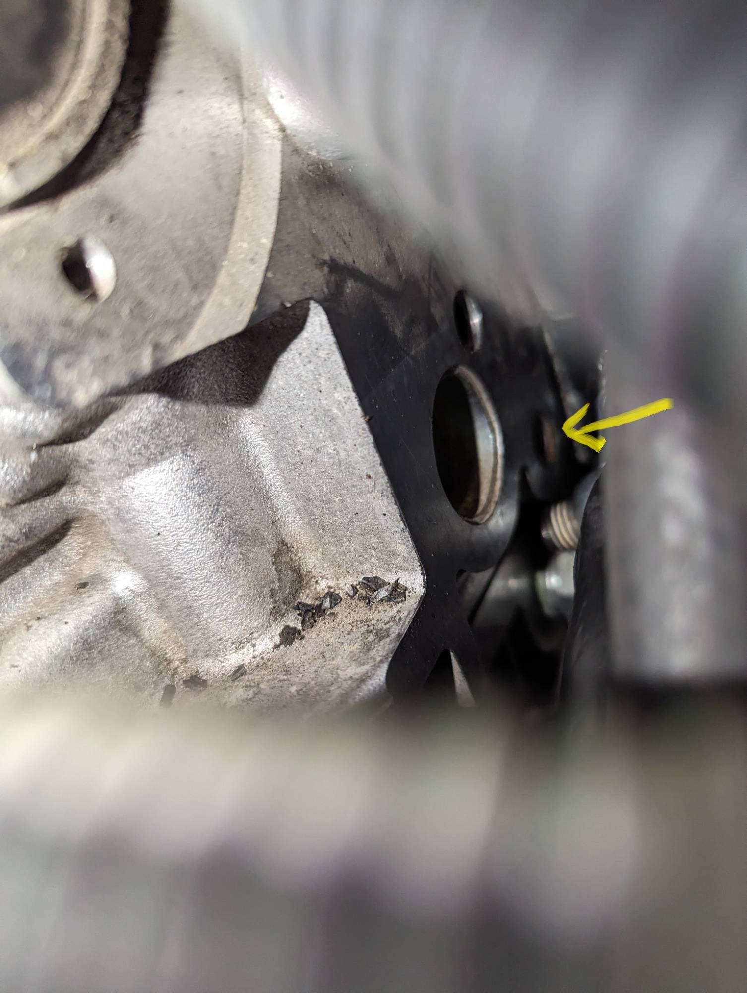

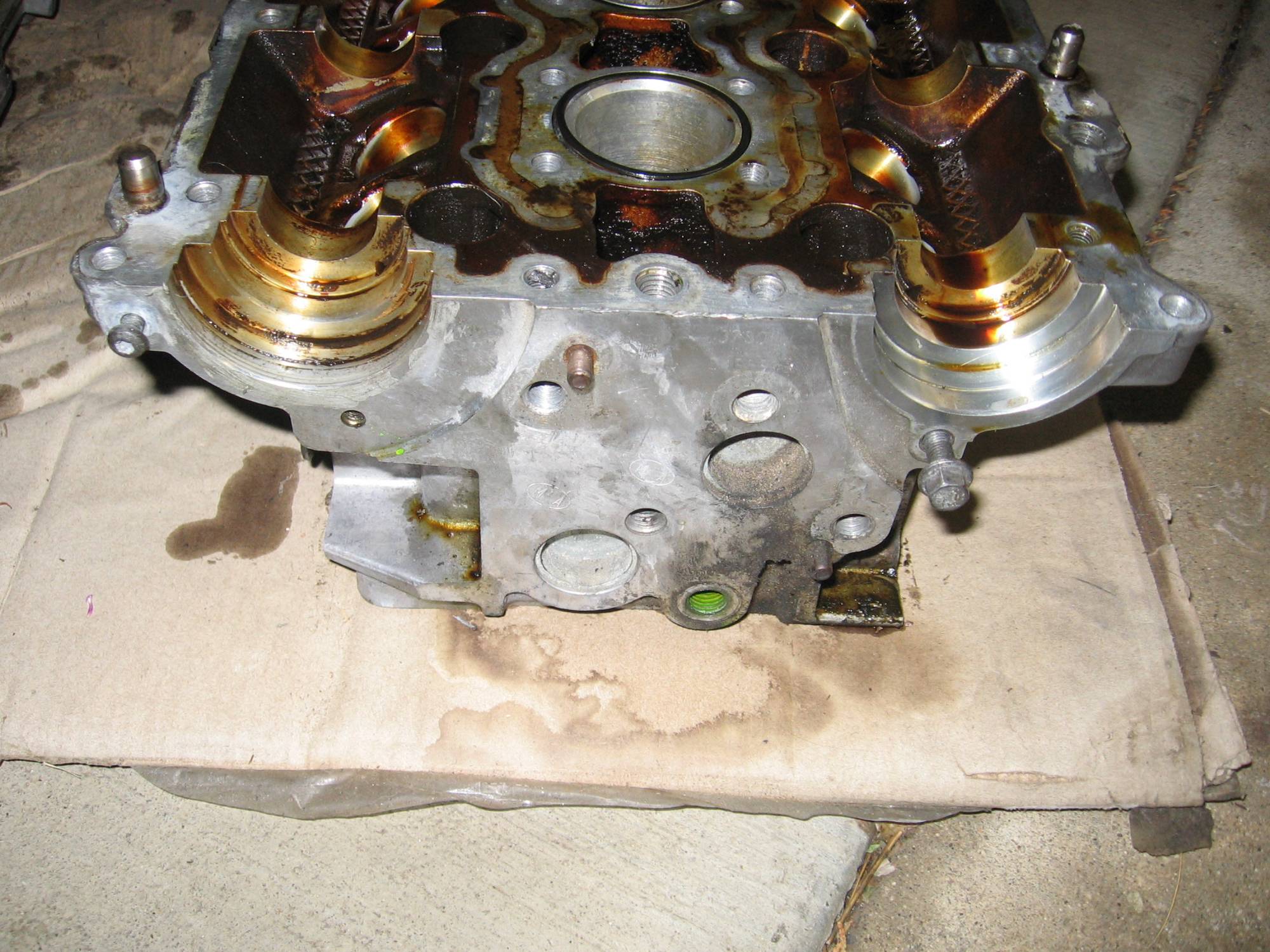

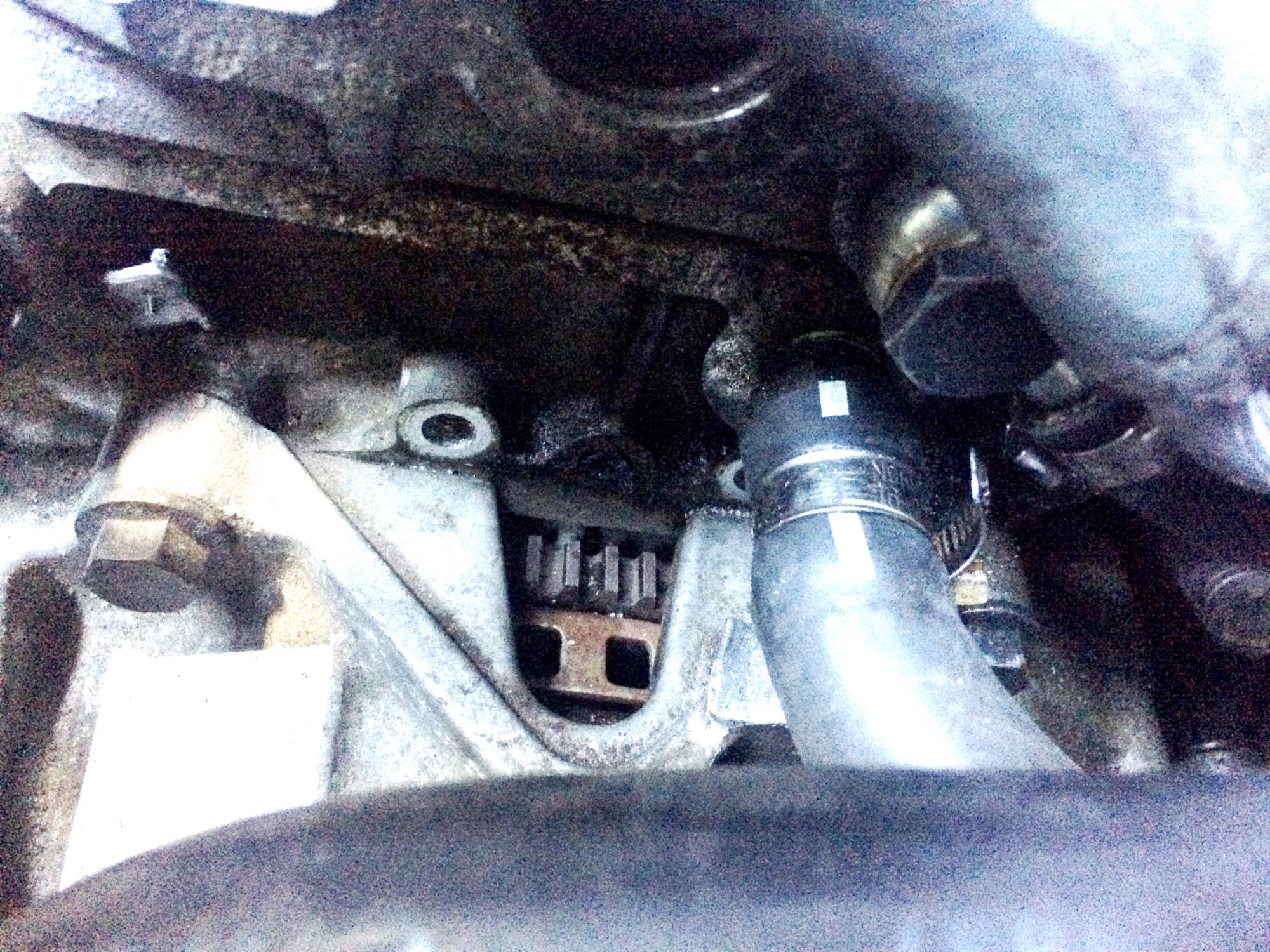

Flywheel Housing Port after removal of Crank position sensor and housing.jpg
The one with the coolant.

It looks like the banjo threads into the head and the heater hose right below it into the block?

I just checked also, but it is hard to see on a built up motor with the turbo. However, mine is plugged into the lower hole as Abscate says.
