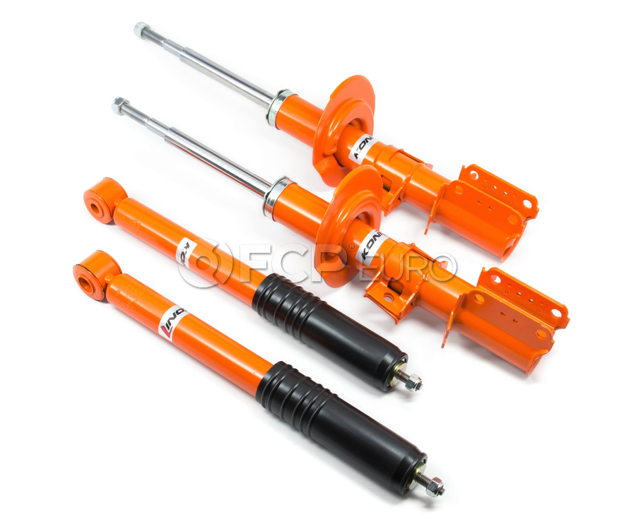

Go with FCP Lifetime KONIS. The SRT has been excellent on our 08 C30 T5.
Volvo Damper Kit - Koni STR.T 87501060KT1 - $498.48
https://www.fcpeuro.com/products/volvo- ... lvostrtkit

Only 2 tiny issues with those. 1.) I already bought the blistein HD rears and 2.) these lowers the car, which for rallycross is suboptimal. The struts and springs I got make everything stiffer but shouldn’t reduce ride height.
I’ll explore the brand though, and they’re a cool orange so I’m already digging it.

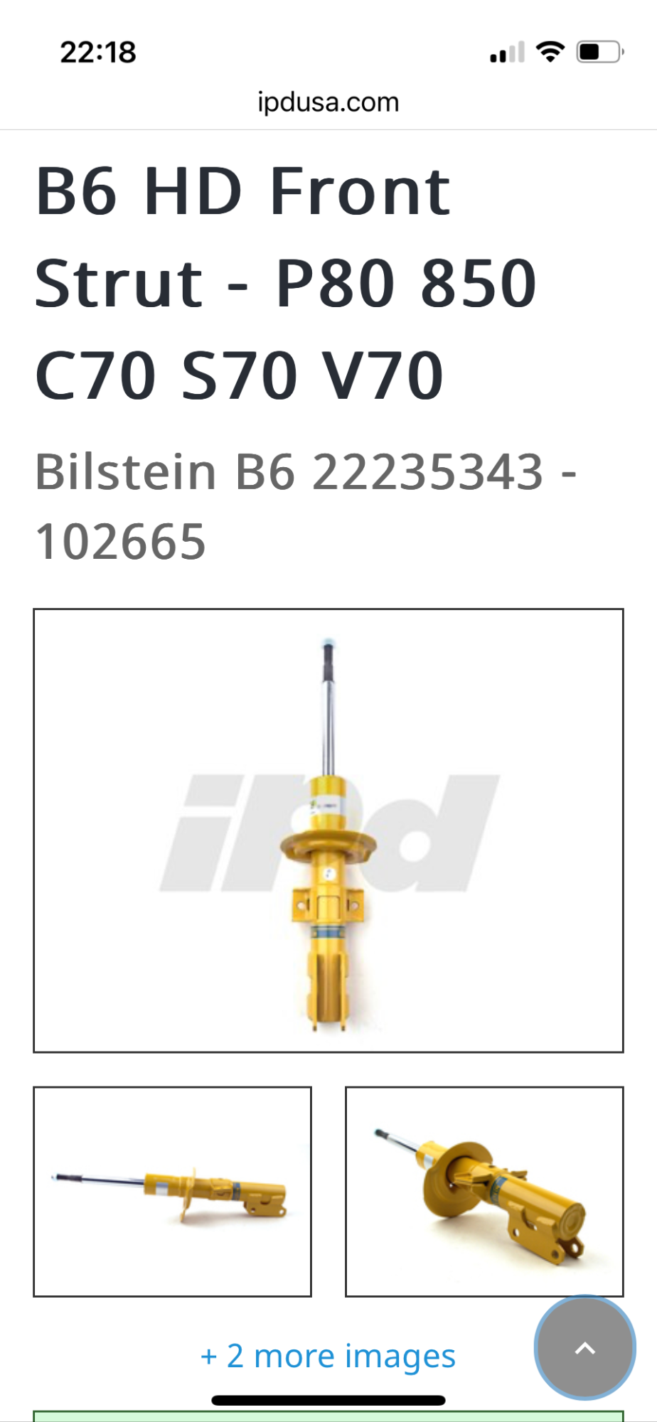

I had a set of B6 on the front of my 00 V70R when I bought it 12 years ago. They only lasted about a year longer before I hit a frozen ice rut turning into my street. I was at snails pace to cross it but it blew out as they were so hard. I spoke to IPD as I was going to swap over and they recommended going for B4's for road use as the B6's are designed more for race tracks and they found them way too hard for daily use. I had found them 'jiggly' on our far from perfect roads.

.tjmartin317 wrote: ↑10 Jan 2024, 05:55Only 2 tiny issues with those. 1.) I already bought the blistein HD rears and 2.) these lowers the car, which for rallycross is suboptimal. The struts and springs I got make everything stiffer but shouldn’t reduce ride height.
The KONI's are for stock height and should work with stock height progressive or stiffer coils. We have Bilstein HD in the back and KONI STR.T up front on our 08 C30 T5 2.0 M66. This car has the factory Sports Suspension which is around 1.2 in lower than stock C30 coils.
What we found is the KONI provided a smoother front end steering feel besides smoothing out the road. Our Whiteline rear sway bar handled the oversteer. I would say the rear shocks won't change the dynamics as much, being Bilstein are good shocks to begin with. Unless the shock is bad, the different brands front and back shouldn't create wallow in turns.
