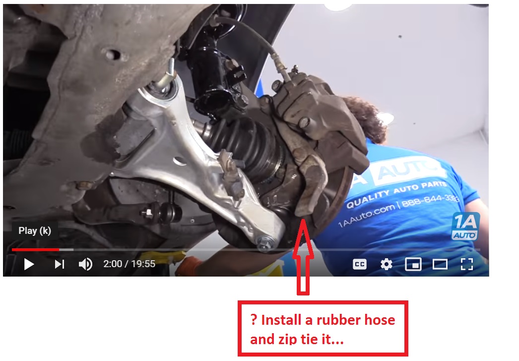

Question re 2004 V70 Steering Stopper PN 31212191.
My Front wheels are rubbing the liner when in full lock.
I was going to buy new steering stopper until I saw the comments in the youtube video that people simply:
- swap R --> L
- swap L---> R.
Has anyone done the swapping R and L?
Does it work?
Photo shows my existing steering stopper (BLUE arrow).
Youtube video has interesting comments...

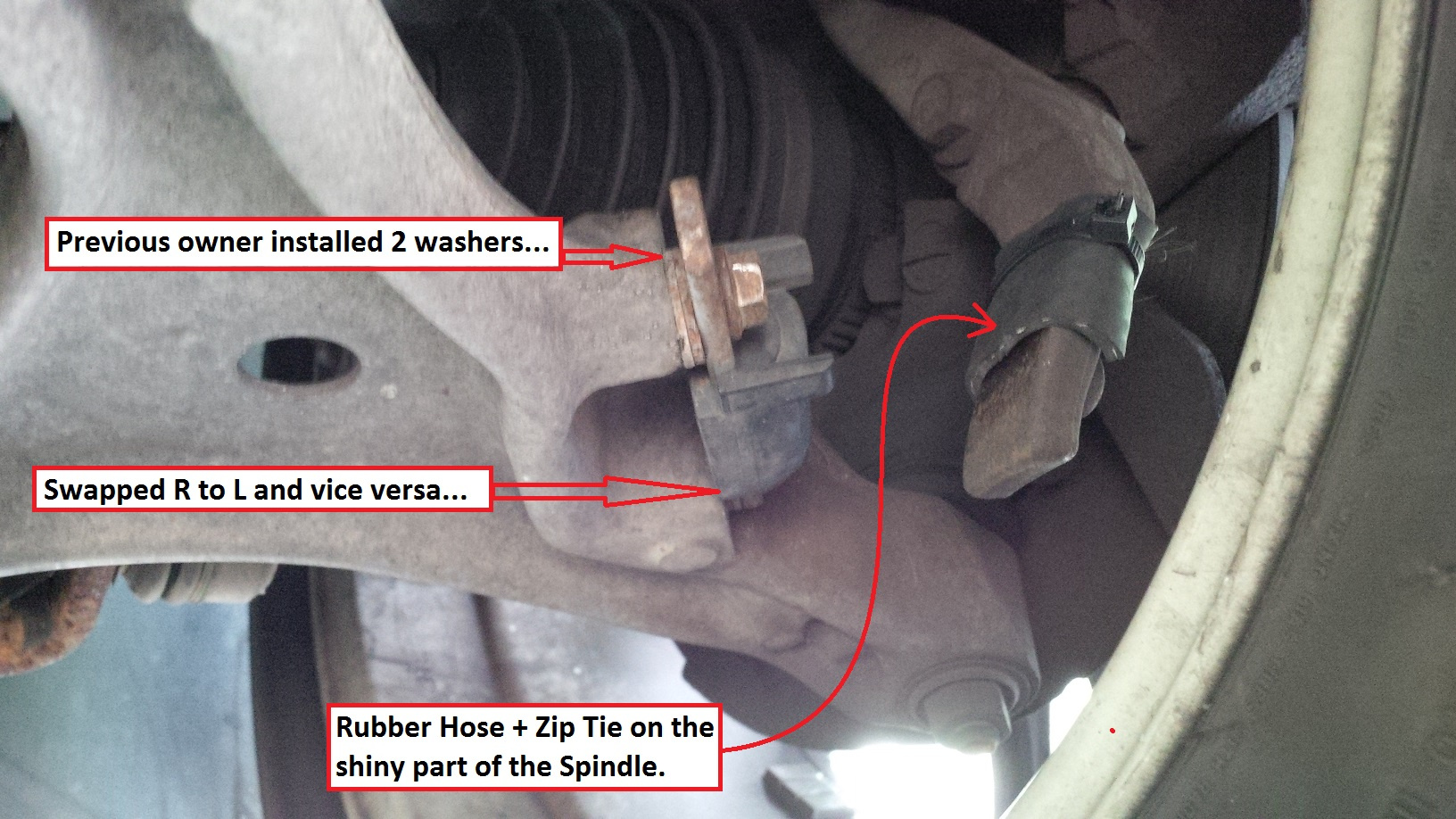

I just came up with this idea and wonder if anyone has tried it...
Get a radiator hose of appropriate diameter (I don't know the exact size).
Cut a small piece and slide over the caliper side and zip tie it.
This will add another 5mm of cushion.
Here is a photo of my thought. Any advice?

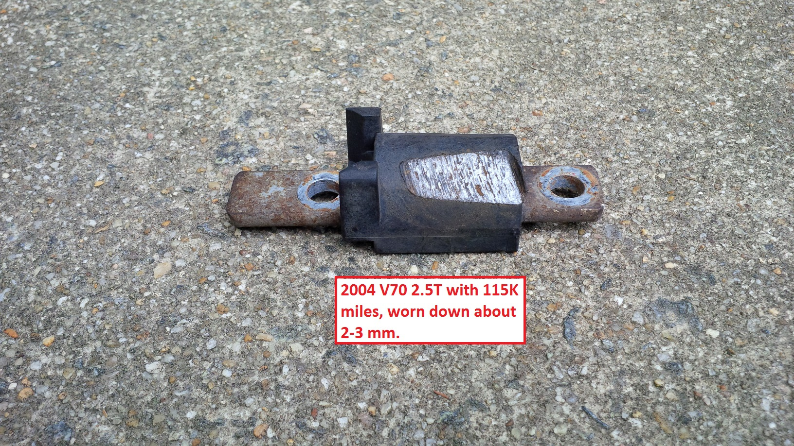

I finally had a little time to play with the 2004 V70 with 115K miles...
- The stopper is worn about 2-3 mm down.
- P.O. installed 2 washers. Curious...does anyone know if the car came with these washers or not?
- Swapped R to L and vice versa (12-mm bolts).
- Installed rubber hose + zip tie on the Spindle as shown. Actually, this is a nice touch bc when I go to full lock, I can feel the
"softness" of the rubber cushion. Don't know how long the rubber will stay there LOL...Will report back later.

Post by cn90 »
Long-term report...
The hose mod (very easy to do with car on the ground) works great. No more tire rubbing.
- I do not have the bigger hose. I just used what I had
lying around and cut it length wise + Zip tie. You can
use electrical wire or hose clamp too.
- If you happen to have the correct hose size (please post it),
you simple slide it up and done with.

Alright,
So I have a little time today to play with the 1-inch heater hose ($2-$3/foot at local auto parts store).
Cut a 1.5-inch section.
Even with lubricant, it is very tight and I could barely push it up.
I guess you can use a socket etc to push it up.
I ended up cutting it length-wise and zip tied it as the photo above.
The bottom line is: the 1-inch hose is a tight tight fit.
You may be stronger than I am and may be able to push it upward.
