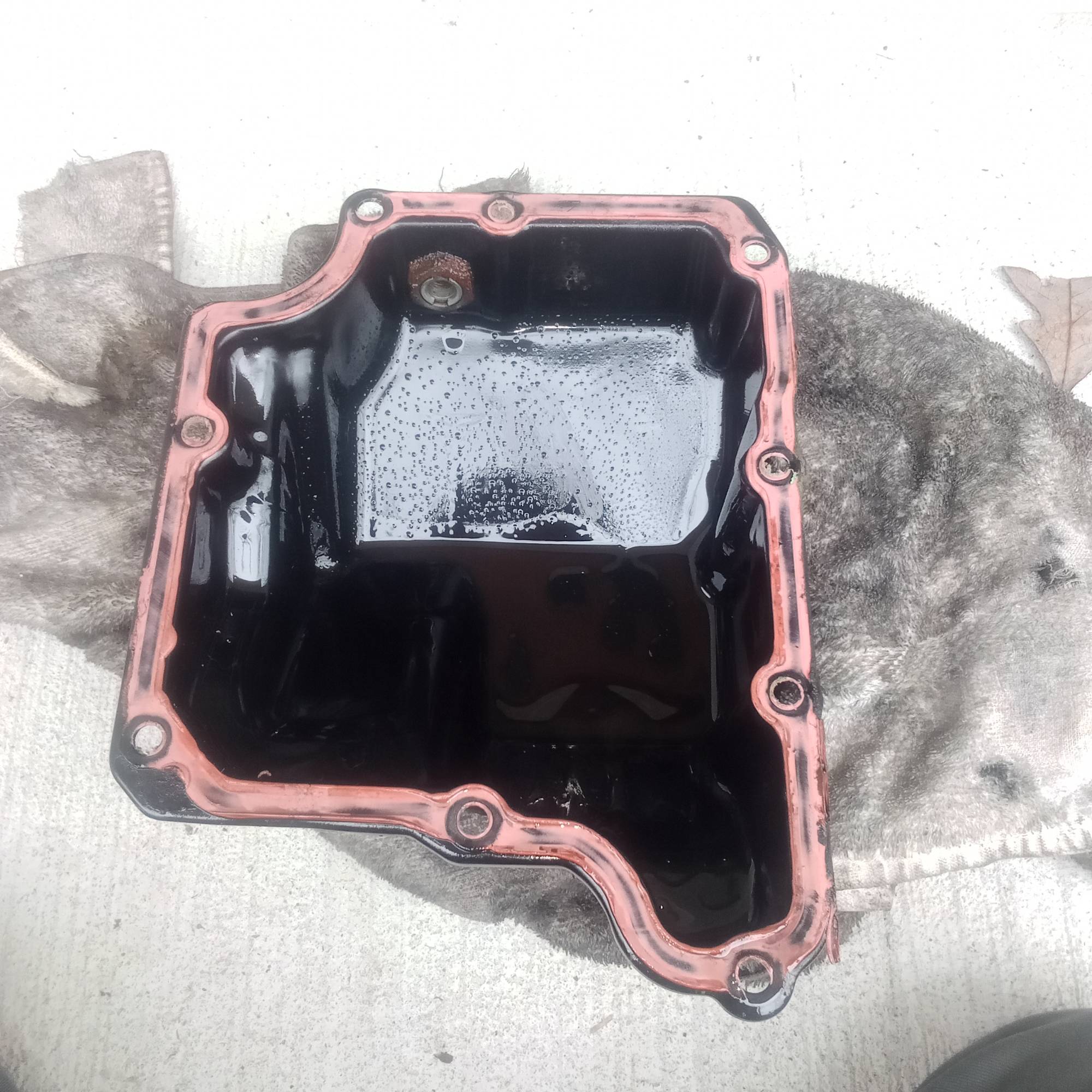

Got the cover off. I found I didn't need to remove the dipstick but I did need to drain the coolant and disconnect the bottom hose. Also had to release the ziptie holding the temp sensor cable. The screw that was between this cover and the smaller cover next to it was by far the hardest. Had to use an L-shaped torx wrench with a box wrench on the short end gripped by a pair of Visegrips and gripped again at 90 degrees by another pair of Vicegrips. Will be going back with hex head bolts and lock washers. The screws that came out had a white-green crumbly material on them. A thread locker of some sort? Maybe felt necessary since the lock washers were flat. Someone had definitely been in there before. There was no gasket - just a pink sealant. OK to spray the valve body with carb cleaner?

Ah, your S70 is a GLT, so a 4 speed auto in 2000! That makes more sense now. The NA and the V70R had 5 speed autos in 2000.

I came across this document when looking for the torque spec on the cover bolts (this doc says 7-11 ft-lbs). I'm guessing you would want to go to the higher end with a gasket vs just sealant (this doc calls for just sealant). After much searching I found and purchased a Duraprene gasket from transpartsonline in Cal. Their part number is 89300AF (asked but did not get a clear answer on why the part number isn't 89301AF as called out in the Aisin Warner parts breakdown).
