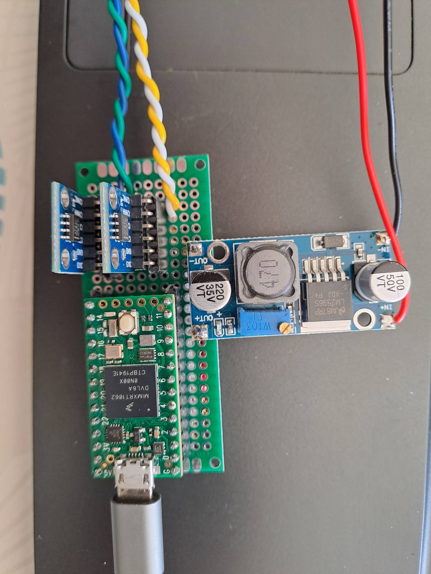

Dear all,
Many thanks for your work and for sharing your knowledge !
Like some users on this forum, I tried the cem cracker on a Volvo V50 2011 (CEM 31327215) using VP230 as CAN transceiver and a Teensy 4.0.
Unfortunately, without success. I have tried with and without the clock line set to 180MHz. I've got 3 different first pin all the time.
Any idea why ?
I followed the main schematic on the github page.
No 120 Ohms Terminator on my transceiver side.
I use external DC-DC Bulk converter connected to 12V OBD, VIN to USB line cutted on Teensy.

Post by vtl »
al1Volvo wrote: 22 Mar 2024, 05:14 Dear all,
Any idea why ?
Christian's one_pass branch seems to be better with P1: https://github.com/cmolson/volvo-cem-cr ... e/one_pass
No need to cut anything on Teensy, it switches to external power automatically.

Post by al1Volvo »
Just succeed with Christian's branch !
Code: Select all
pin[2] choose candidate: 36
Candidate PIN 57 30 36 -- -- -- : brute forcing bytes 3 to 5 (3 bytes), will take up to 2012 seconds
Progress: 0%..done
found PIN: ** ** 57 ** 30 36
PIN is cracked in 602.38 seconds
Validating PIN
PIN verified.
done
Resetting all ECUs.
Do you know what tool should I use now to get a dump of the flash to edit the car config please ? using OBD if possible.
I saw the CEM config tool from T5Like but it seems to be dedicated to P2, is it right ?
Again many thanks for your great work !

Well after a while of soldering, programming and testing I finally managed to read the 29LV200bc chip on my test ECM. I am getting at times a few flipped bits, likely from crosstalk but not often. So far reads are 99-100% correct.
However because of the very long wires I believe it takes much longer for voltages to settle and because of that I have to introduce several millisecond delays between each address read resulting in half hour dumps. Still better than nothing
As soon as I complete all code changes to also erase and write the chip I will do all these mods to the actual bricked ECM and restore it to be reflashed once more.
The hw and software changes in Arduino mega were installing a 3.3v regulator for CMOS logic levels and downclocking the device to 8mhz. This means I could altogether avoid logic level shifters of which I would've needed several as the 29lv chip is not serially shifted for data and addresses and needs all pins connected.

First of all, big thanks for the hard work everyone putted in this project. I don't have any programming knowledge but I have automotive knowledge (I'm a mechanic).
With the help from your beautiful project I accomplished to clone a damaged CEM for a customer what saved him a ton of money (and gave me some more knowledge =D)
Now, for the future, I like to turn my breadboard frankenstein creature into a nice solid piece with a LED screen. With a the info here that wouldn't be a problem.
Here is my question, I understand now a little bit how everything works. Also that for P3 I need to load my teensy with the other branch. But how is it possible that modunlock (who get the info from here) gets everything (p1, p2 and p3) from 1 device?
When I gonna build my device I'm gonna build another one for a friend of mine and I don't have any commercial meanings with the project but its just curiosity.

Scoloo wrote: 24 Mar 2024, 09:43 First of all, big thanks for the hard work everyone putted in this project. I don't have any programming knowledge but I have automotive knowledge (I'm a mechanic).
if (p1) { use p1 branch}
else if(p2) {use p2 branch};
To sum it up and ELI5 it.
