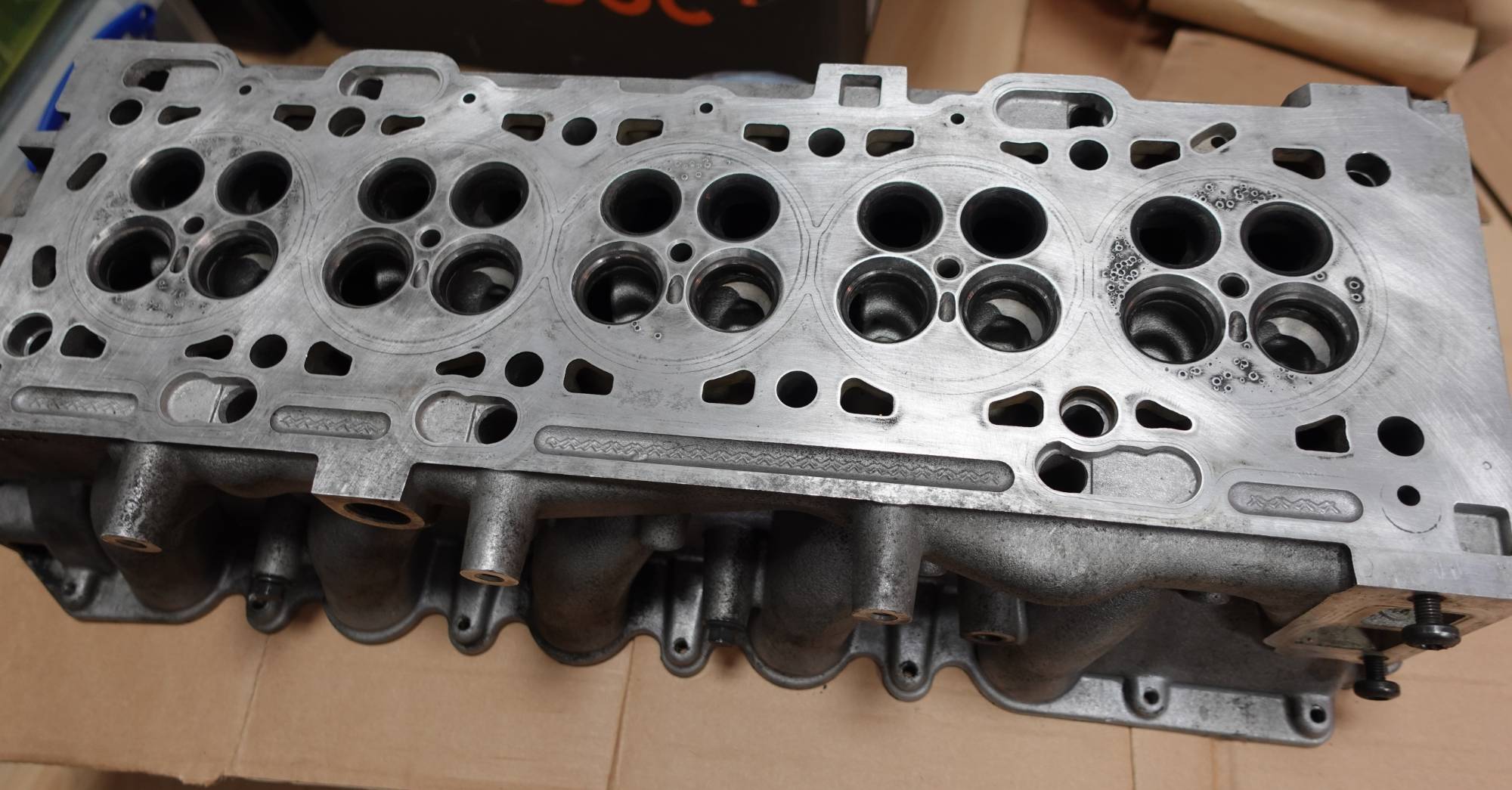

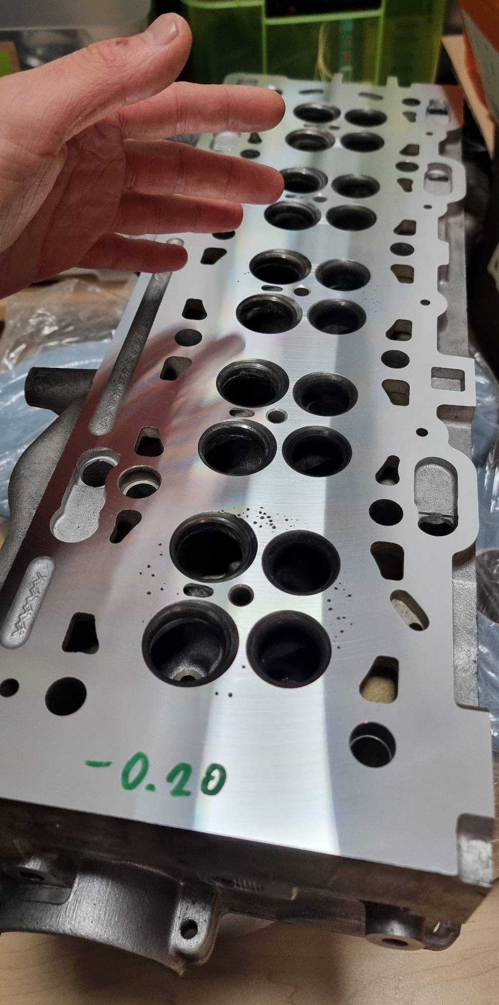

Today I got my head back from the shop. They had to remove 0.2mm because the head was twisted.
Already ordered a new head gasket, previous one was 1.05 (2 holes), new one is 1.25mm.
A real pity I have to roughen up this shiny machined surface for the gasket.
This old head wont last forever tho due to the damage the previous owner did to the injector clamp threads.
Before vs after: milling for just 50 bucks (€) in a professional motor repair shop was a real steal!

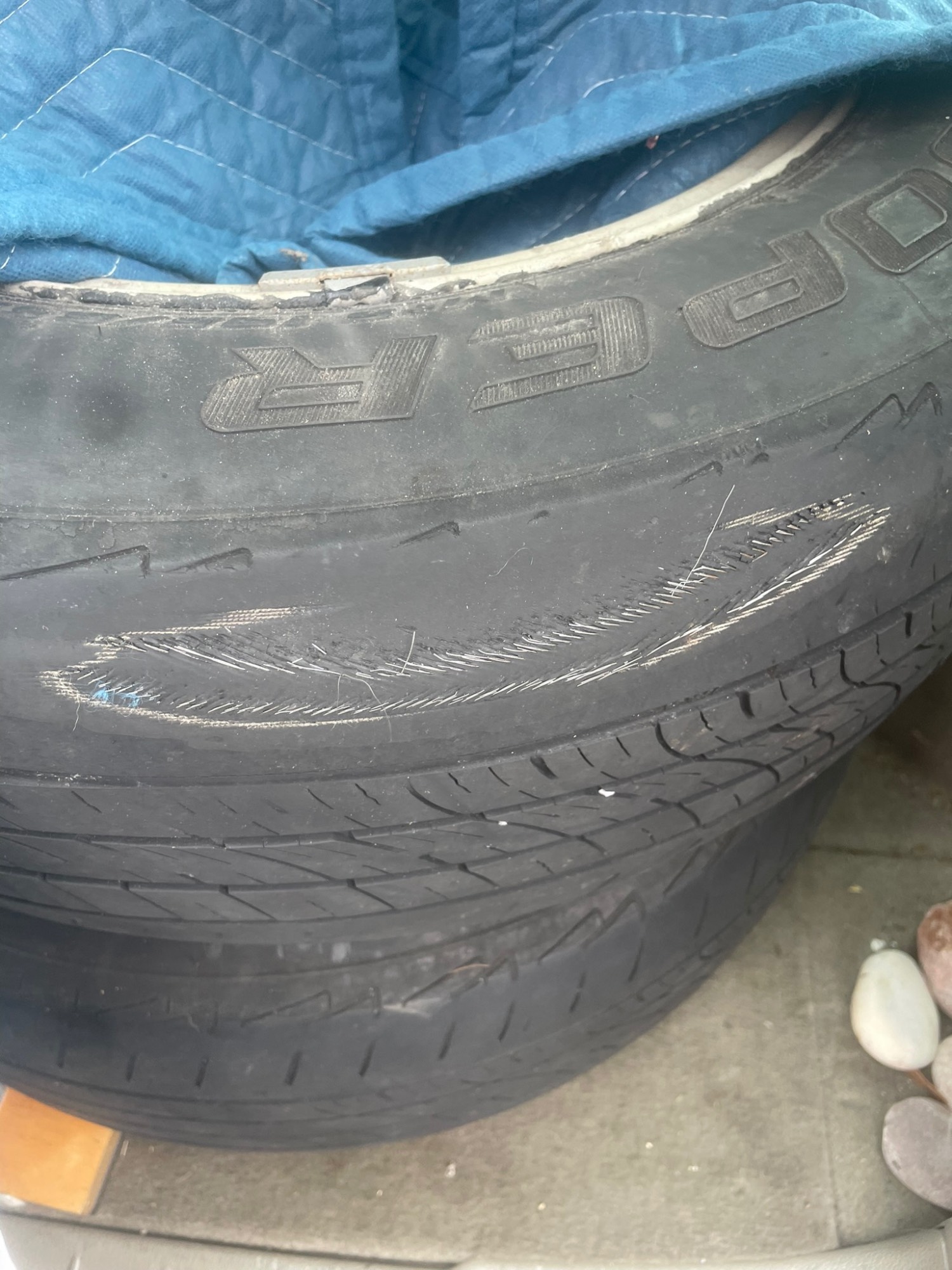

Solved by high speed ( 70 mph) drumming sound on Catherine, the 2005
I’ve not taken too Many road trips but I was getting some noise in back at 70 mph, which I cured by driving at 65 mph
I checked back tires in December, and they were at 2mm tread on the inside , so I ordered new tires and just around to install. Found this…ugly.

Any idea what caused this? Broken cord causing it to rub in that one spot?abscate wrote: 14 Mar 2024, 03:22 Solved by high speed ( 70 mph) drumming sound on Catherine, the 2005

Extra points for getting 95% of tread life from this tire. Maybe aim for 90% in future.abscate wrote: 14 Mar 2024, 03:22 Solved by high speed ( 70 mph) drumming sound on Catherine, the 2005

What's on the inside you can't see so won't hurt you or your pocketbook!

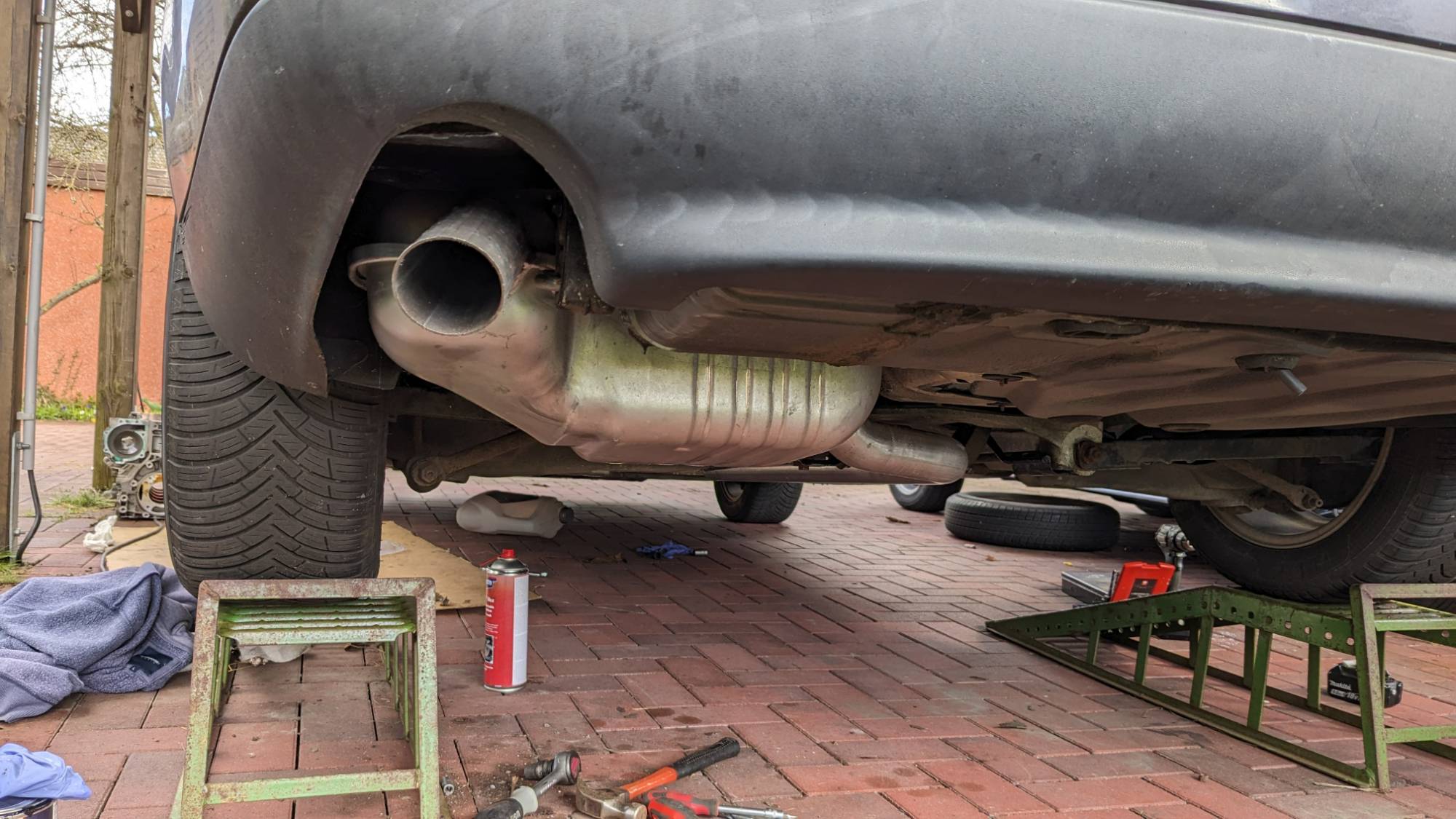

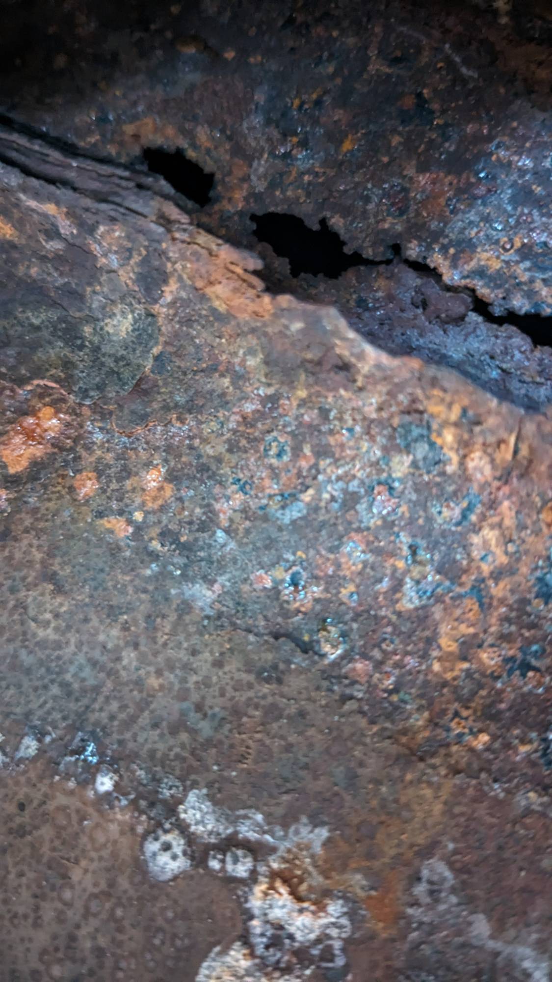

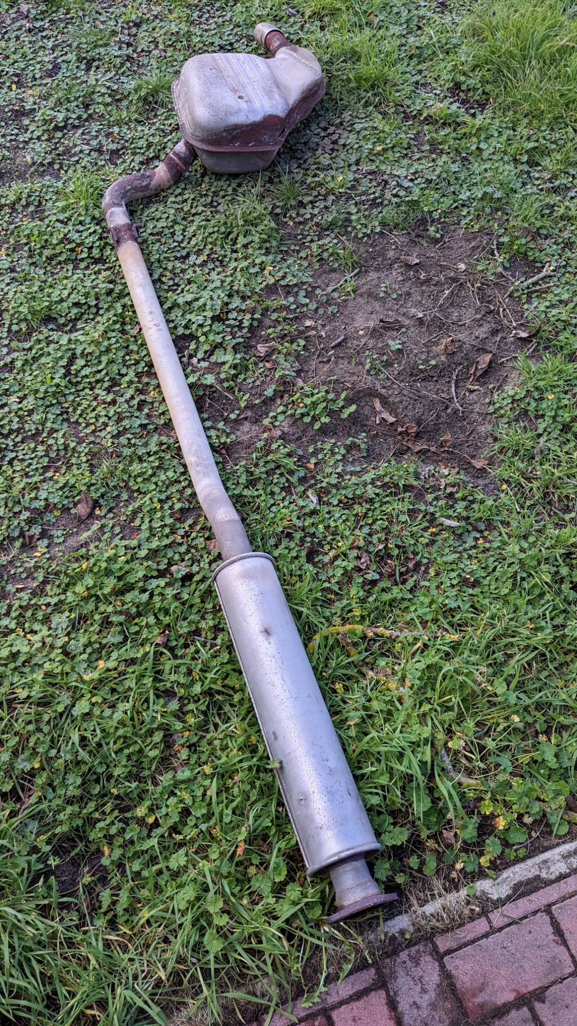

In January the rusty exhaust of my S60 decided to finally develop a hole in the rear muffler. As you typically do in such cases, I ignored it
Unfortunately the hole didn't decrease in size and the exhaust got progressively louder. Therefore I ordered new mufflers from IMASAF and procrastinated for another month until Saturday, when I finally ripped the old exhaust out:
It went smooth so far, but one of the four bolts of the front exhaust guard (VIDA calls it "bracket") stripped. I expected the bolts close to the downpipe to strip but not one in the chassis
Then I decided to open the can of worms and remove the heat shield as well. It was a good and bad decision. Good in a sense that I uncovered a lot of rust, which had to be treated. And bad in a sense that I uncovered a lot of rust, which had to be treated. The spot welds of the rear heat shield came apart in the process, so I had to rivet them back together.
All the surface rust was ground down with a CSD disc and painted with Brantho Korrux 3in1 (the German equivalent to POR15 essentially).

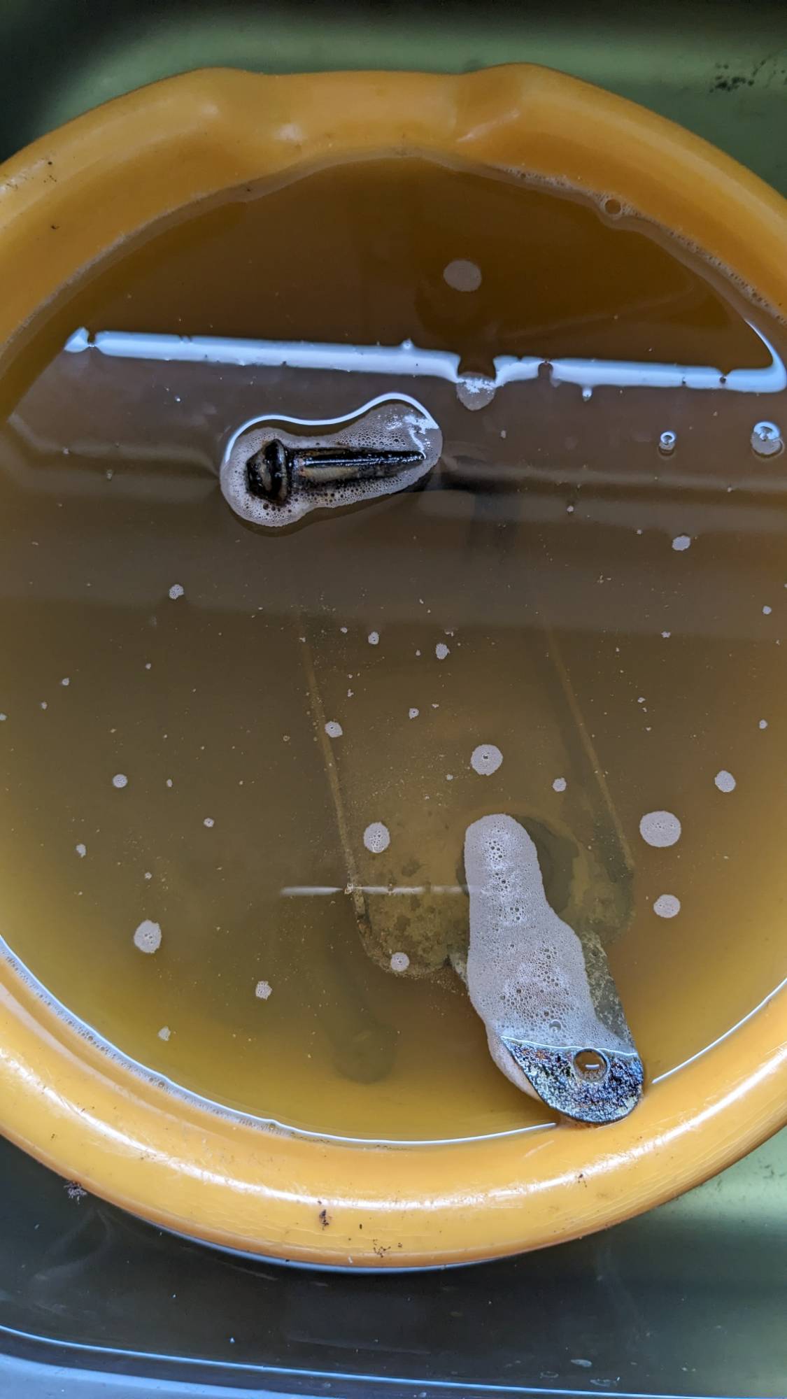

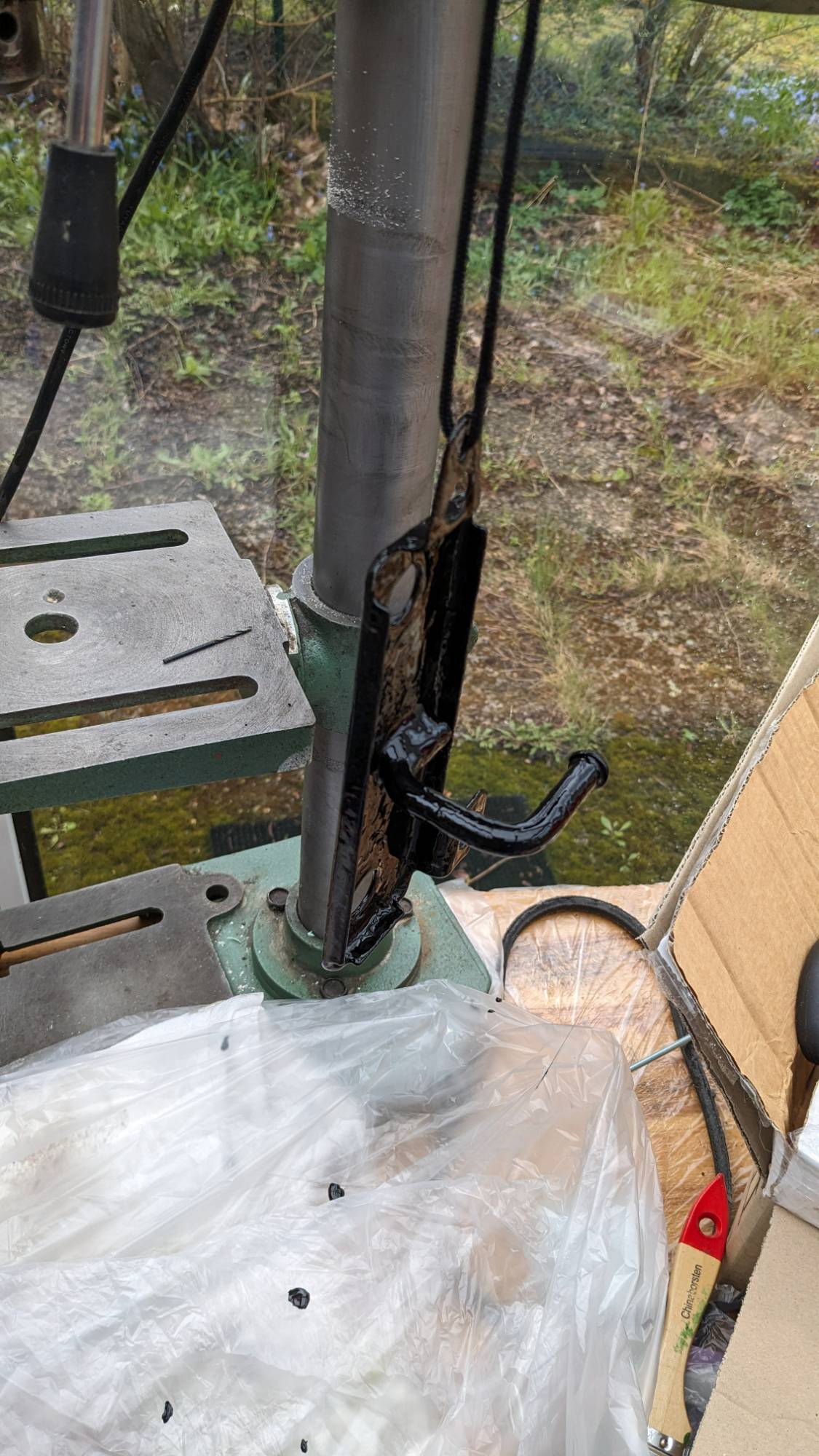

The exhaust hangers were derusted in citric acid, neutralized with soda and then painted with Hammerite. The next time (if there is one..) I'll make new exhaust hangers from Stainless.

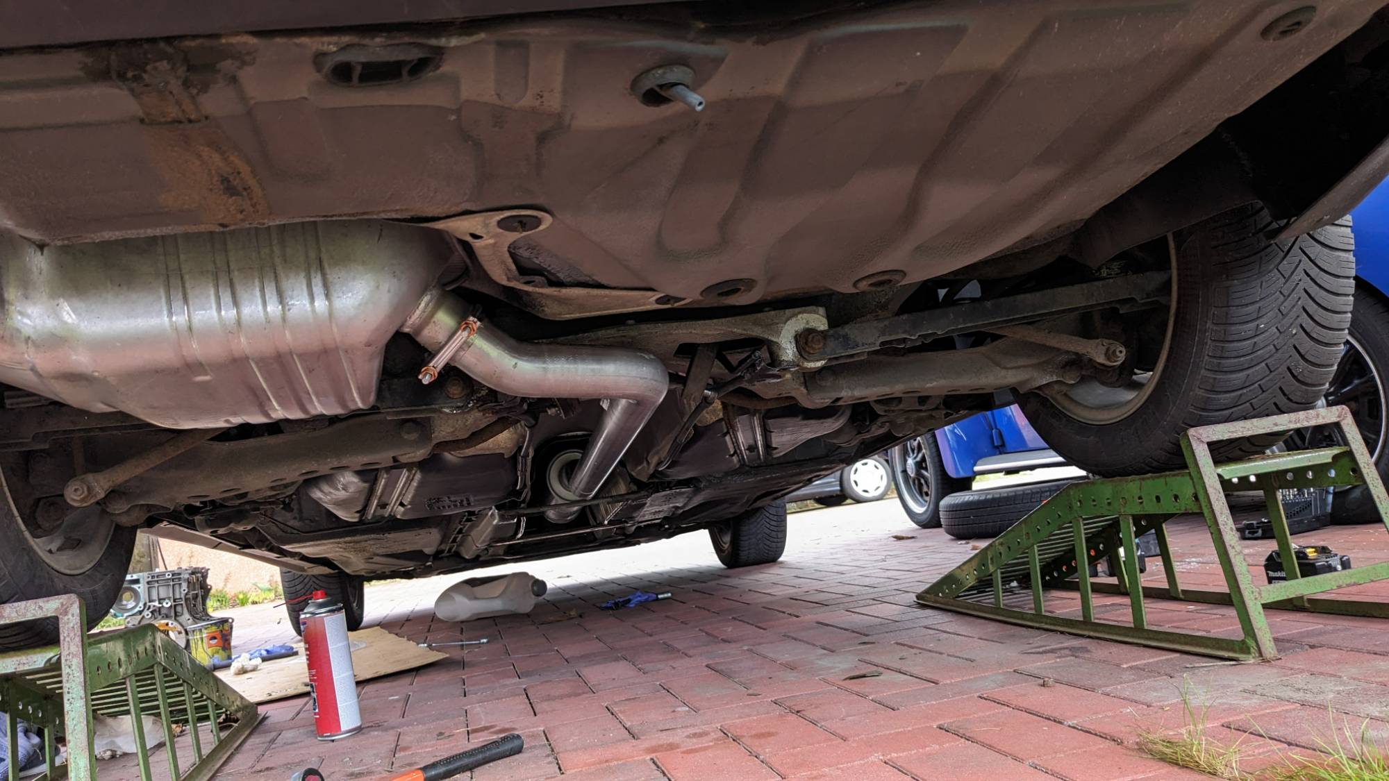

The installation went quite smooth and the IMASAF exhaust fits very well.
All in all the "just swap the exhaust on a Saturday" took three days and was significantly more work than expected.
If there only was a 1:1 replacement exhaust for P2 Volvos made from stainless steel (with TÜV approval)...
