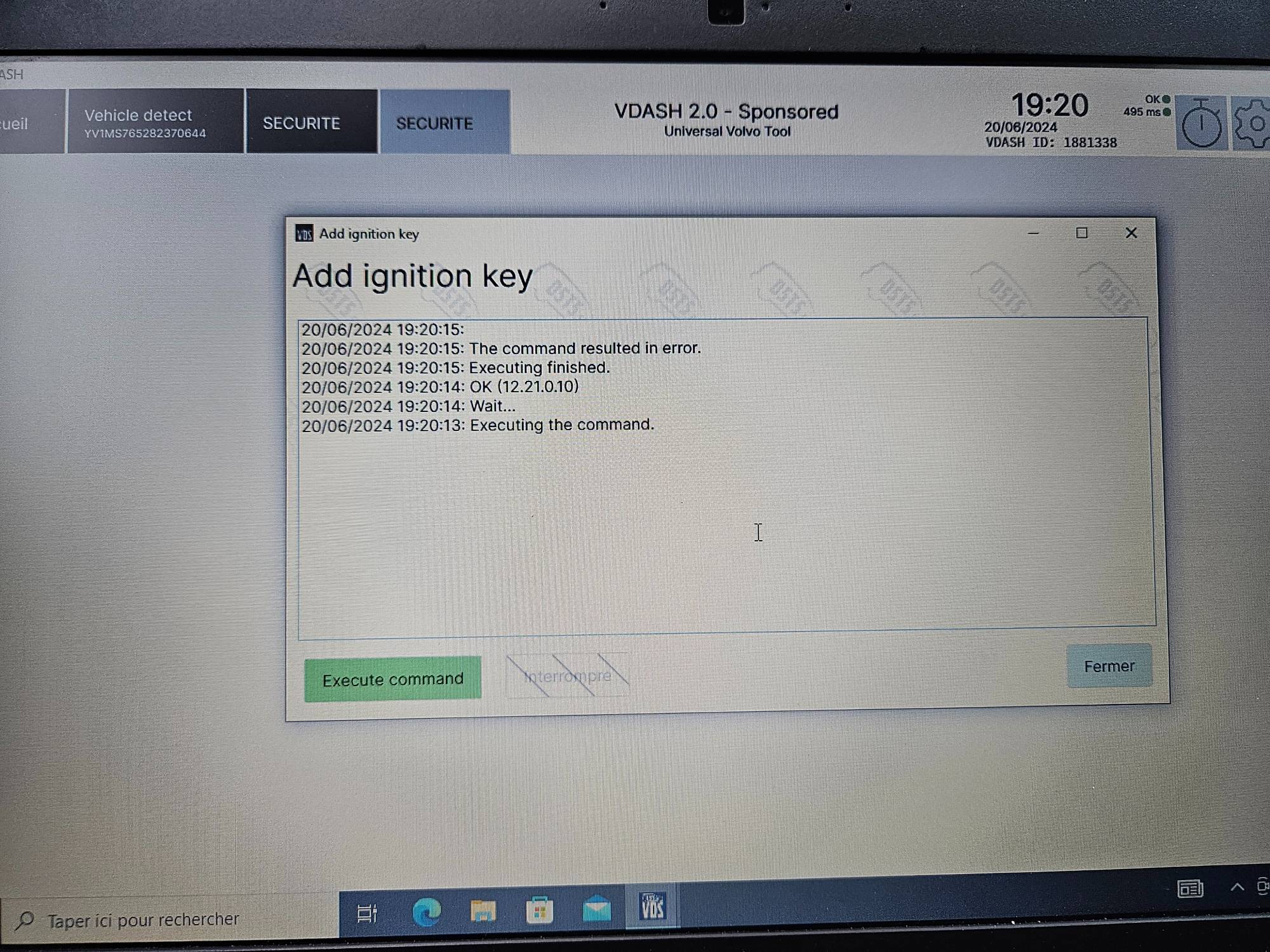

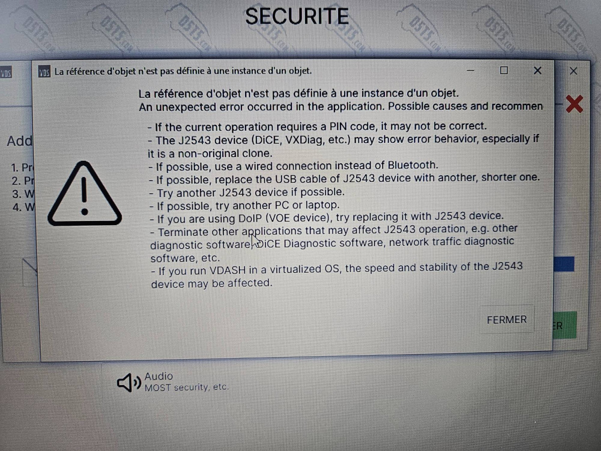

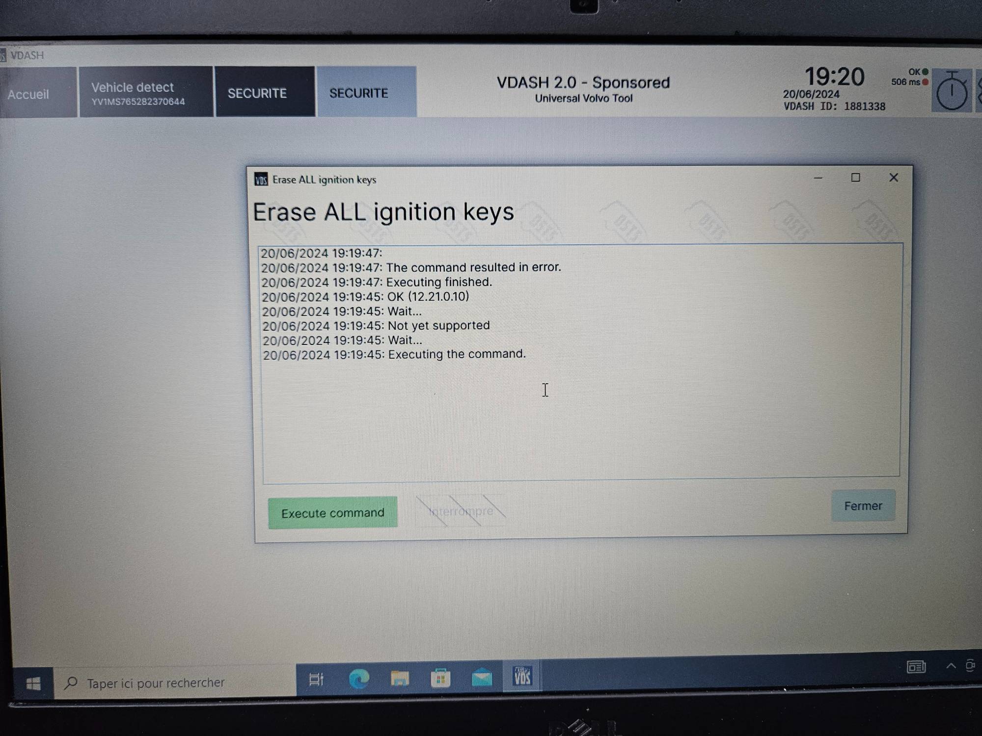

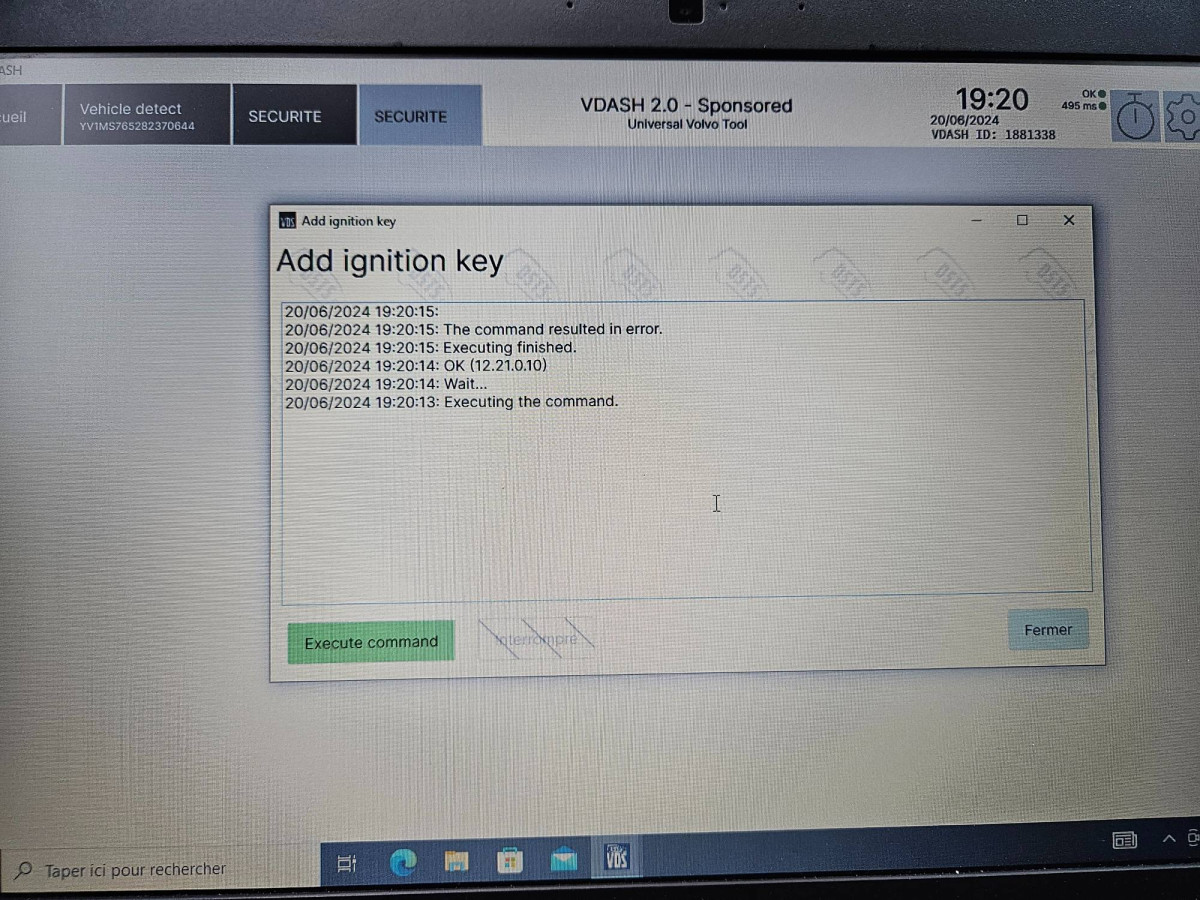

Alliottom59
Posts: 11
Joined: 2 June 2024
Year and Model: 2007 S40
Location: Nord
Has thanked: 2 times
Been thanked: 1 time
Post by Alliottom59 »
@wormland Thanks
I just tested it doesn't work
here are the photos of the errors
PS: in vdash I cannot delete the bad immo pin code, perhaps a code conflict
