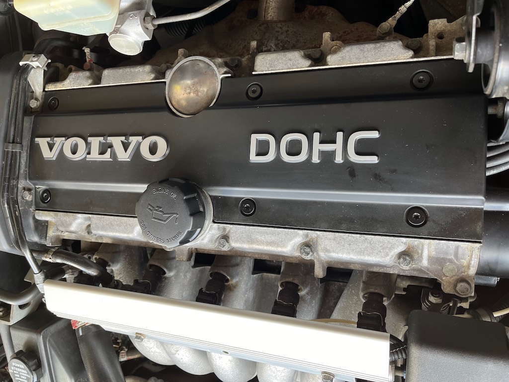

Bit of tinkering today and painted the 6 Torx bolts that hold the plug-lead cover in place. Not sure why I never done it sooner as I did the V70 ones last year

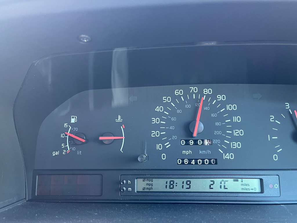

The clock turned over 64,000 miles on the road home this evening
