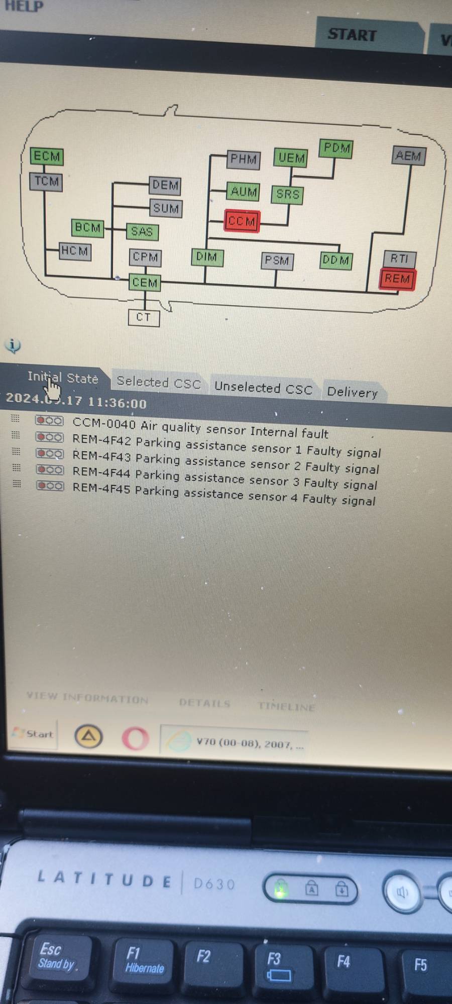

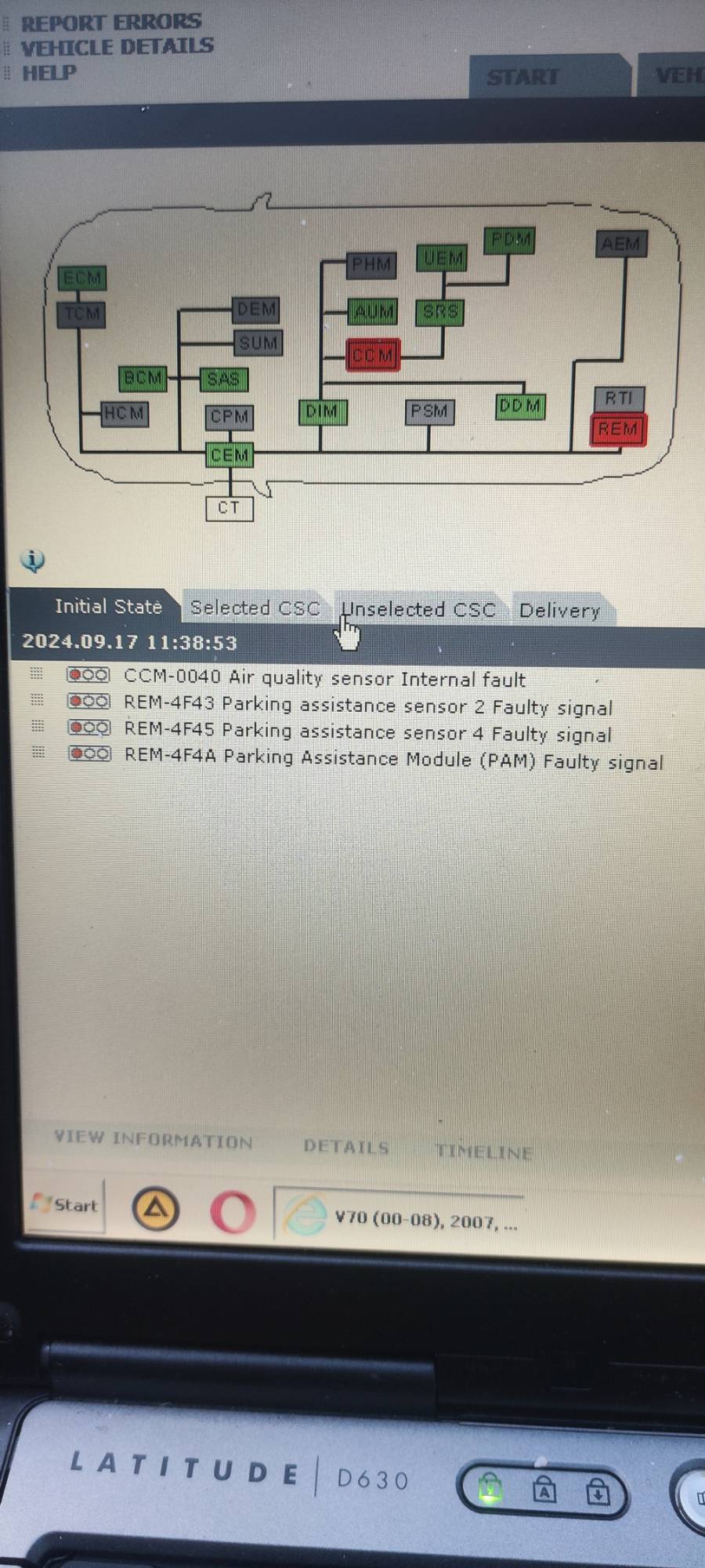

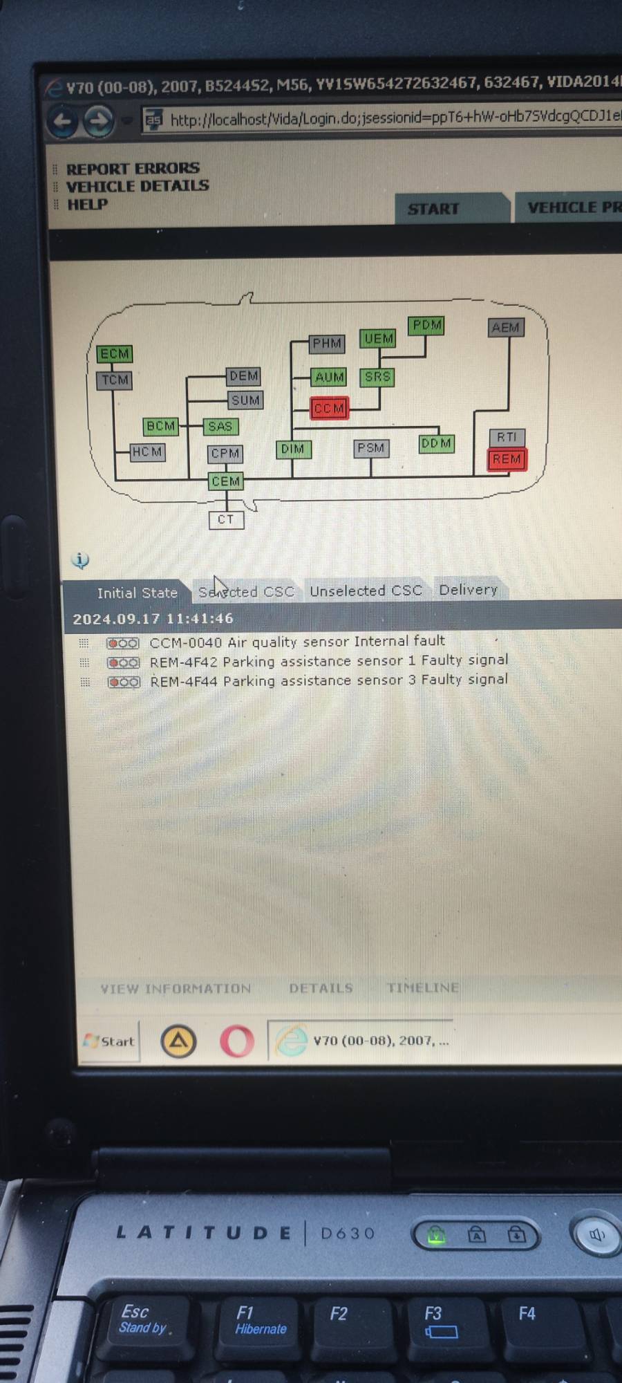

Hello all. I have problems with parking assit system . I have 3 PAM With my original it show i have 4 bad sensors . I buy one more junkyard used it's connecting but show 1 and 3 bad parking sensors 2 and 4 working i replaced sensor 1 same problem nothig changed . Then i buy another one PAM ad that PAM show connection problems but with that PAM shows bad 2 and 4 sensors 1 and 3 working . How ca i solve this problem ? buy 4 th PAM ?

The units fail, but often it is just the connections at the sensors and the plugs that get corroded. Trying to follow what you have done, it sounds like you may need a 4th. Try finding a good electrical contact cleaner and soaking the connections and brush them with an old tooth brush. Let them dry out and try again. Same with the plug connectors on the cables.
