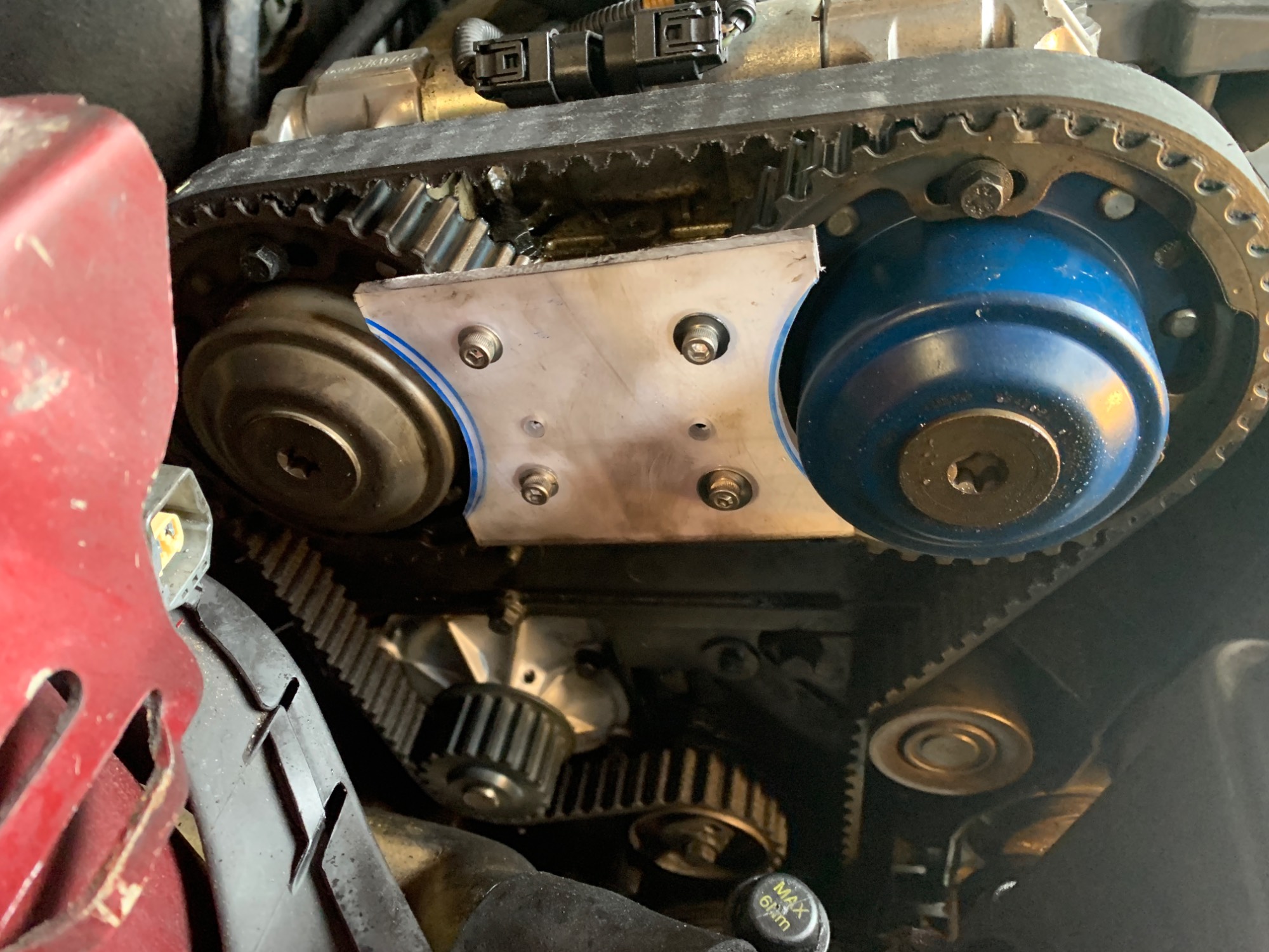

Ay- I did the belt, water pump ect on my 03 XC70 a couple of summers ago. It went fine for me. I did build my own cam lock thing, 4 bolts that indexed to gear notches. I marked the old belt with 2 dots of paint and transferred those dots to the new belt. It went well and the car started with no CEL. Way easier than the T Belt I did on my wife's 03 new Beetle turbo!! Dave

clever enough to make a video with measurements.

Post by deano1 »
Dave
That cam pulley lock system you made is genius!
I've seen other push in type and would create a false sense of security
Especially when dealing with the dual VVT normal procedure end up locking opposite end of camshaft which creates extra work but allows access to cam seals.
If cam seals are not leaking your rig could be used and timing problems would be thing of the past.
Cheers

i was going to make my own until....
https://www.aliexpress.us/item/32568033 ... _shipto=US

Perfect. Thanks for posting that. AliExpress is so great for stuff like this.
