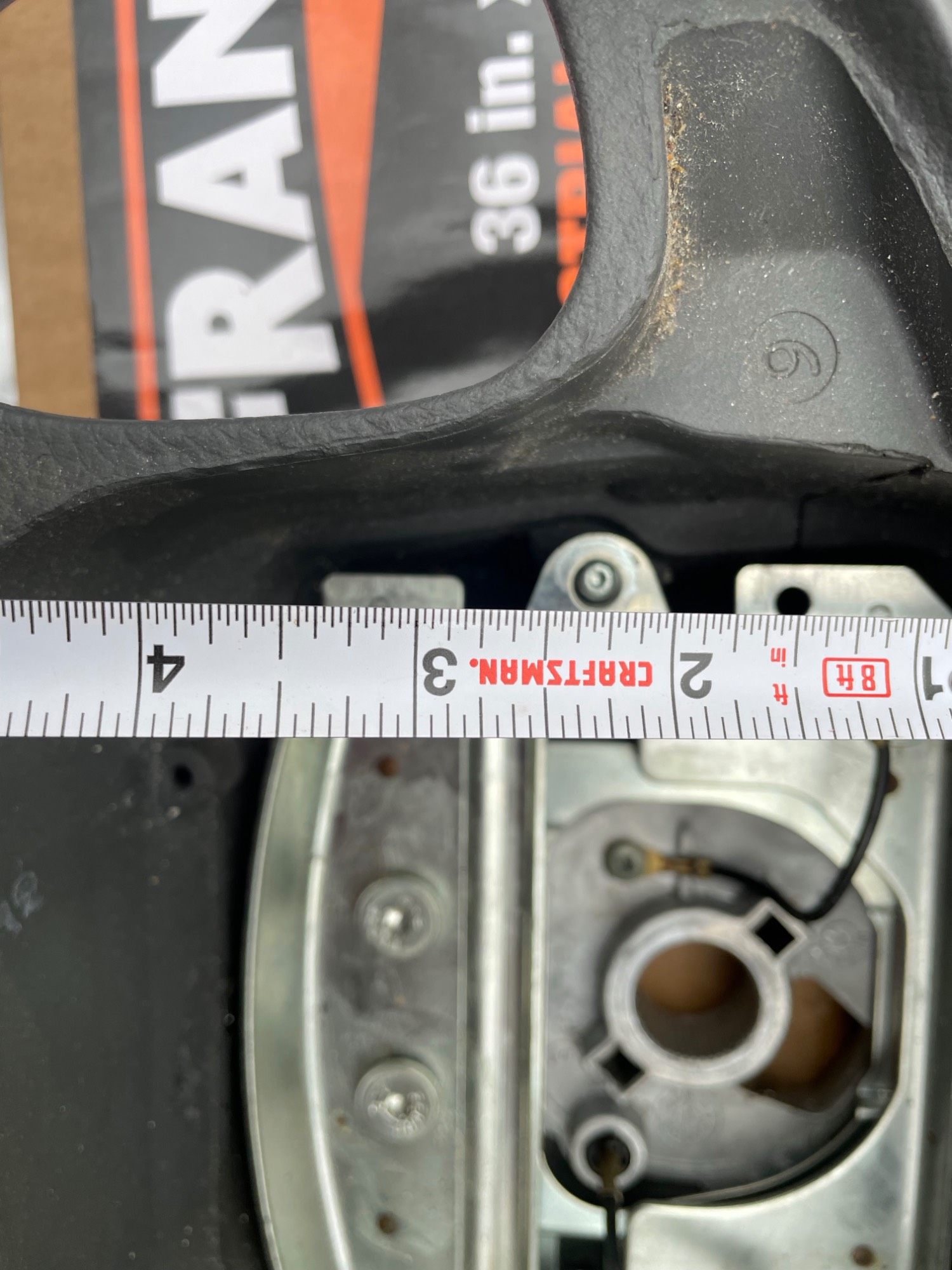

Hope these measurements might be useful….I have tipped the camera to correct for parallax to get the distances correct +- 1/16 inch or so.
Caveat - I think those Torx are captive in that metal plate, so you may have to cut them to the rear (REAR is rear of car) of the plate to release the airbag. Thats going to make a mess. I would circle hole cut through the airbag and grind off the screws from the rear of the steering wheel, I think - then use my replacement
