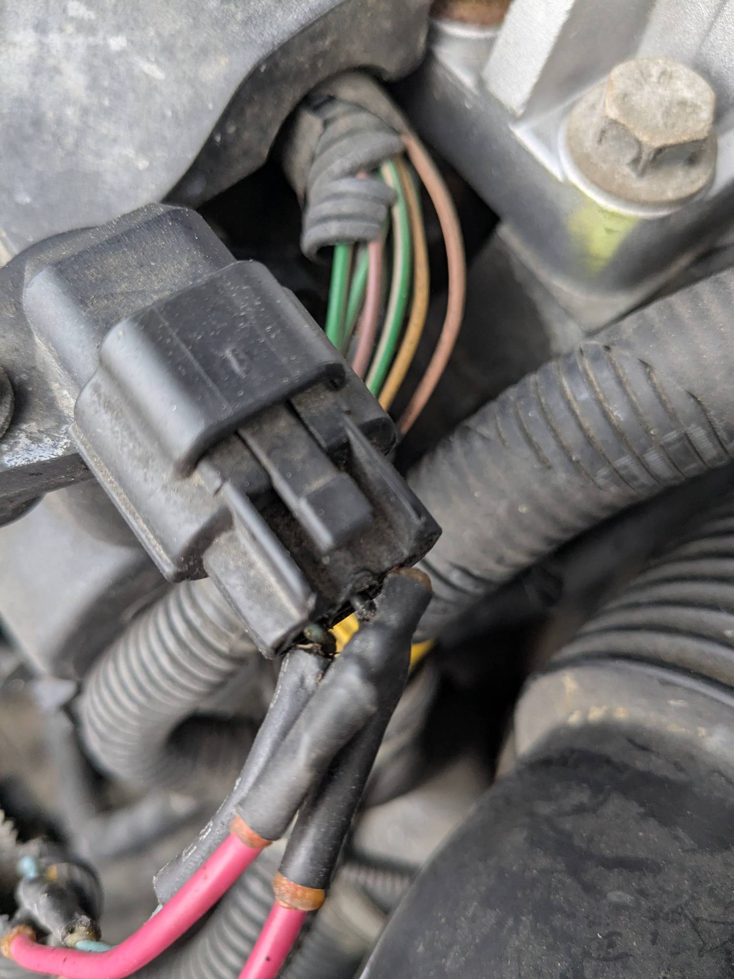

2004 Volvo xc70, 130k miles.
Finished a head gasket replacement and now am seeing OBD code P0016, description "Crank-Cam position correlation"
There are no other codes and I've not yet set up the Vida-dice system. I noticed though that the intake cam position sensor wires are particularly worn - see below.
Should I re-solder the wires, or is this a sign that I screwed up the alignment of the VVT cams when I put the timing belt back on?
P0016 power train code, camshaft sensor wires?

I had this problem on the 02 XC70 I was helping with. Being an 02 it only have a cam position sensor on the exhaust. I see yours has inlet and probably exhaust.
I tried swapping a bunch of parts as the code is not specific. We still had it at the end. The only ting I did not have time to do was check the timing belt. A new one had been fitted by a non-Volvo shop a few months previously.
Hopefully you can find the issue, but it doesn't do any harm to check the timing belt is timed correctly.

vida will give a more definitive code than that.
On mine it said "cam signal out of range", no kiddin, the cam sensor was loose, it couldn't get a steady signal.

scot850 wrote: ↑18 Mar 2025, 23:09When I had the head of I reset the timing per the standard instruction. VVT hubs were pulled off the camshafts in the process, so I guess that could be the issue.Hopefully you can find the issue, but it doesn't do any harm to check the timing belt is timed correctly.
Is there a sensor or diagnostic reading that would show this error?

beewstew wrote: ↑19 Mar 2025, 07:26sounds about right, pre-load on CVVT hub off a tooth or something,scot850 wrote: ↑18 Mar 2025, 23:09When I had the head of I reset the timing per the standard instruction. VVT hubs were pulled off the camshafts in the process, so I guess that could be the issue.Hopefully you can find the issue, but it doesn't do any harm to check the timing belt is timed correctly.
Crank gear is keyed to the crankshaft so that eliminates the crank if its on the mark at set up.
see link below.
viewtopic.php?t=49689
