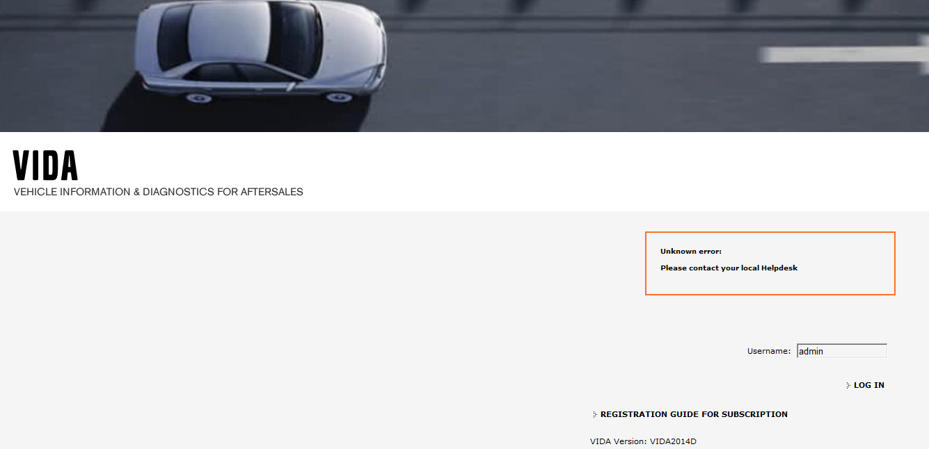

Hello, I have an issue when trying to install Vida. I've been trying many times now, also reinstalling windows but everytime SQL Server 2008 gets stuck while at: "SqlEngineDBStartConfigAction_install_configrc_Cpu32", can anyone help me with this? Thanks in advance!

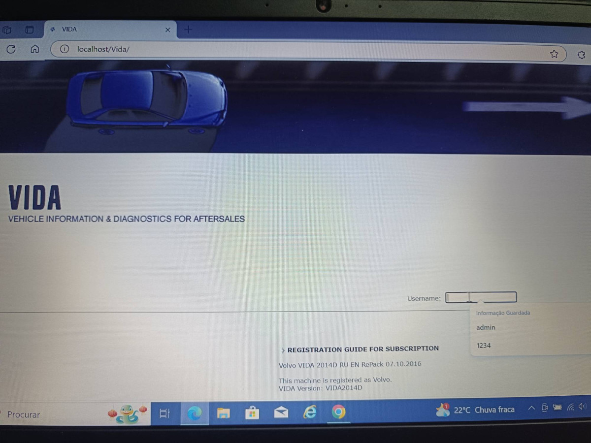

Hello everyone,
I was able to access, view the tabs with the diagnostic options, manually configure the vehicle data, but I can't get the Mongoose to communicate with Vida. Does anyone know if I can get a hardware model compatible with Windows 10? After I bought it, I looked and found that the Mongoose cable is only compatible with Windows 7 32-bit with at least 3GB of RAM.
I thank you.
I thank you.
Thank you for helping us out. And also thanks to the users that posted their issues because that was how I was able to figure out what the problem was.
I kept running into "Vida not Ok" and that was because for some reason my laptop wouldnt allow the SQL to communicate with the Vida installation. The solution is to install windows 10. I reset the whole system and did a fresh install.
The issue that i am running into now is that my Clone Dice will not connect to Vida. the box says "not selected". I updated the vida drivers on how you instructed , and still nothing. I am running edge with IE Tab. I also downloaded VX manager and it still doesnt connect. Only one green light is lit on the DICE, the firmware light.
Do these Chinese clones work with this system or do they have to be manually installed on an old laptop with Windows 7 pro. Is there a way around it? on device manager it shows up as "Unknown device"
this is the clone that i am talking about https://www.ebay.com/itm/286371755033

Windows 7,8,10 or 11?icecream21 wrote: 11 Mar 2025, 12:32 Hello, I have an issue when trying to install Vida. I've been trying many times now, also reinstalling windows but everytime SQL Server 2008 gets stuck while at: "SqlEngineDBStartConfigAction_install_configrc_Cpu32", can anyone help me with this? Thanks in advance!
