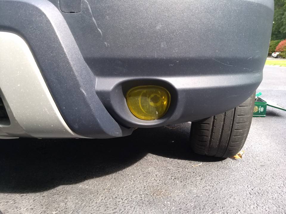

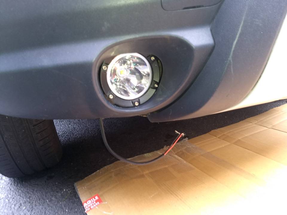

XC70 has a wider fog lights pattern, which helps a bit. Replaced them with 10W CREE flood lights, which are not street legal, but I don't use them with oncoming traffic. And too many deers around to be in a small car at night anyways.
