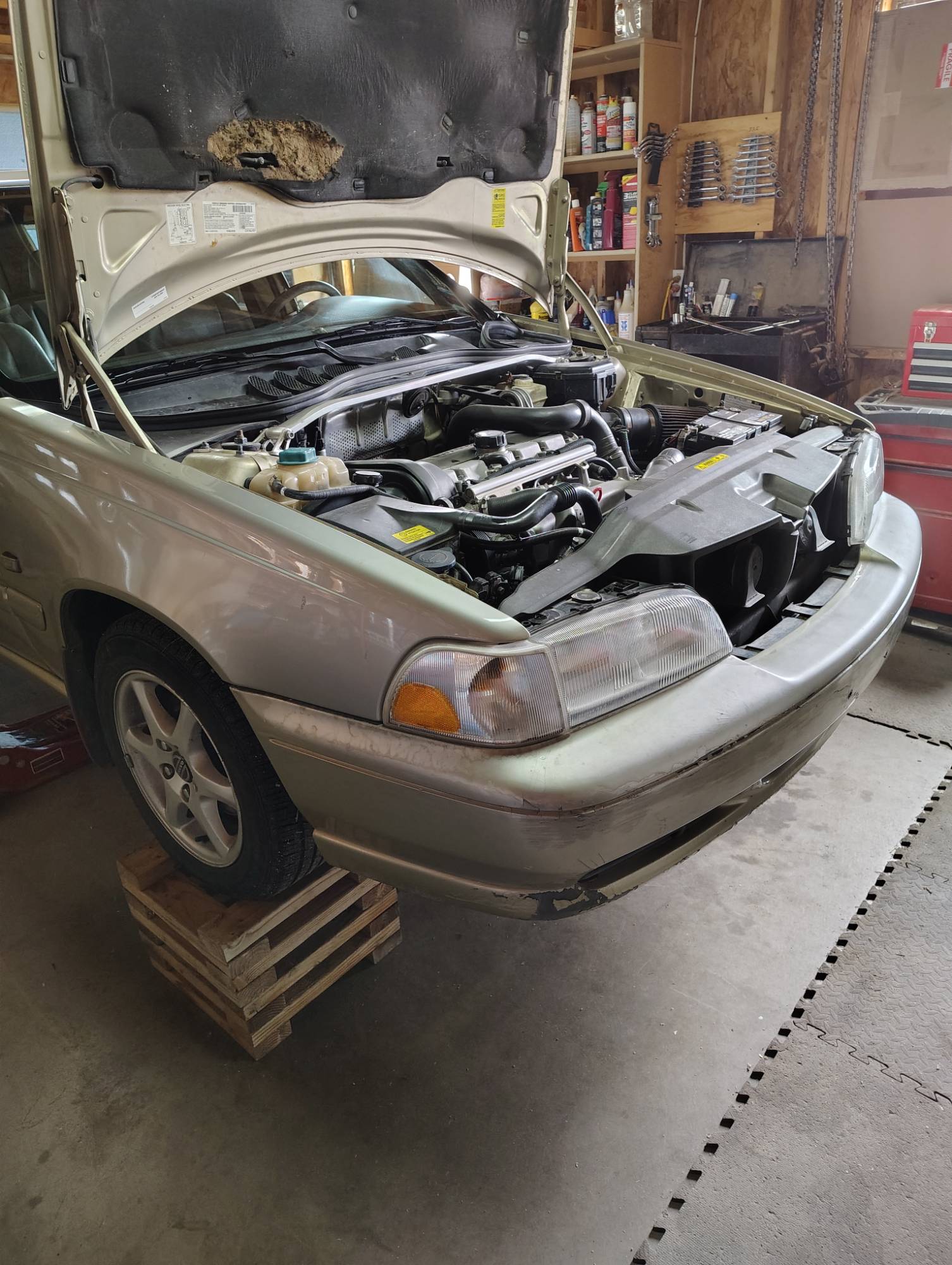

Working with clean components can make the difference between a fun job or a miserable job ( plus I can find leaks easier ). Besides I had the time
Reset the timing belt tensioner and pumped out all of the gas, but now I think I should get a fuel filter, considering that its been sitting for 4 years. Probably jelly inside at this point.

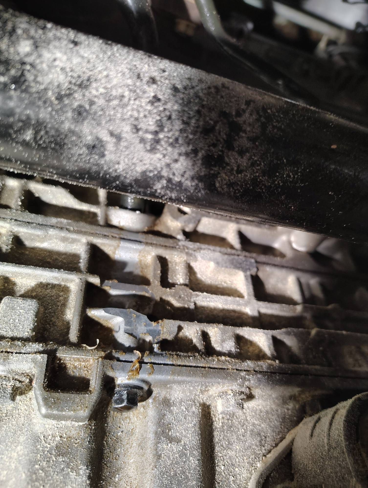

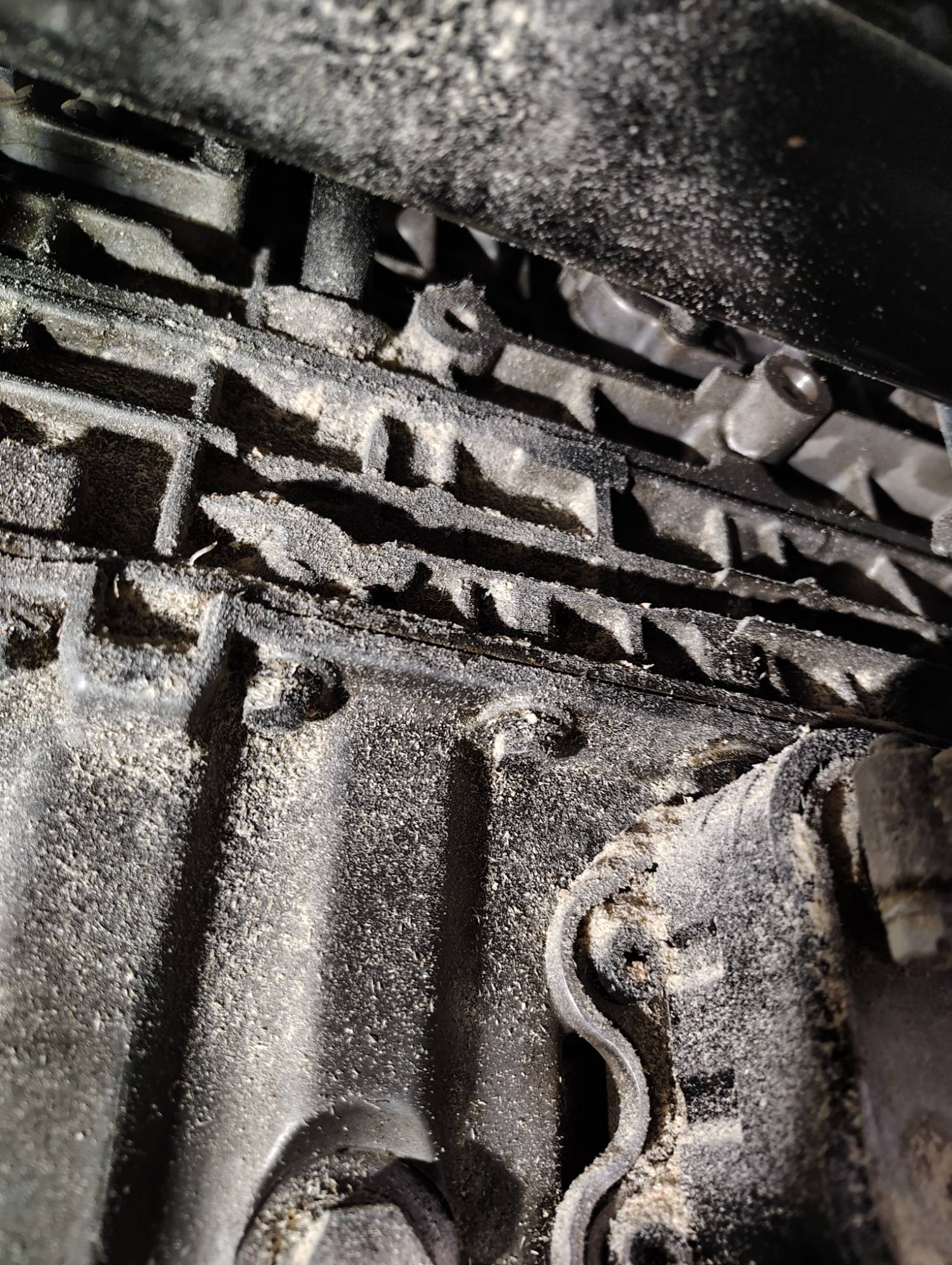

Went about trying to find the oil leak. I wiped everything down and let the car idle for 1/2 hour, giving it varied throttle. Tried getting the turbo to engage as well. Rolled underneath while it was idling and could not find a leak. Let it sit for a bit and repeated. Still no leak.
So while I was glad that it looked like I wouldn't have to drop the pan, I still knew there was a leak somewhere. Enter saw dust.
I threw a good bit of it on the back of the engine, and took it for a quick spin around the block. Back under it, and mystery solved.

Sveedy, how in earth did you get the top end of the motor this clean? Looks like iceblasted ...
