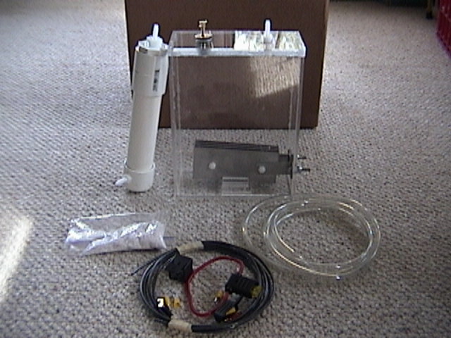

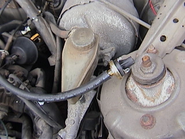

Please view the photos from the last to the first as this is the way the program uploaded them. http://hhotek.com/index.html
is where I purchased my kit from. They have improved kits now.
The cell kit was $270 with approximately $60 in additional hardware. All fittings are sealed with silicone as well as the electrical connections. The improved kits have sturdier cells as well as more complete hardware. My Electrolyte ratio is one gallon of water to 2.75 tsp of Potassium Hydroxide, KOH.

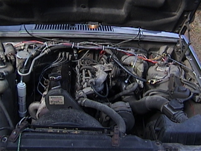

- New kit. But , had to buy extras to complete the install with extra safety measures.
- new kit.JPG (83.46 KiB) Viewed 2599 times

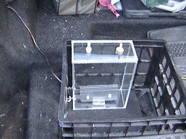

- Empty cell in position in 86 740 trunk
- cell setup trunk.JPG (87.65 KiB) Viewed 2597 times
- Bubbler/spark arrester 1/2 filled with RV Antifreeze
- bubbler.JPG (95.58 KiB) Viewed 2597 times

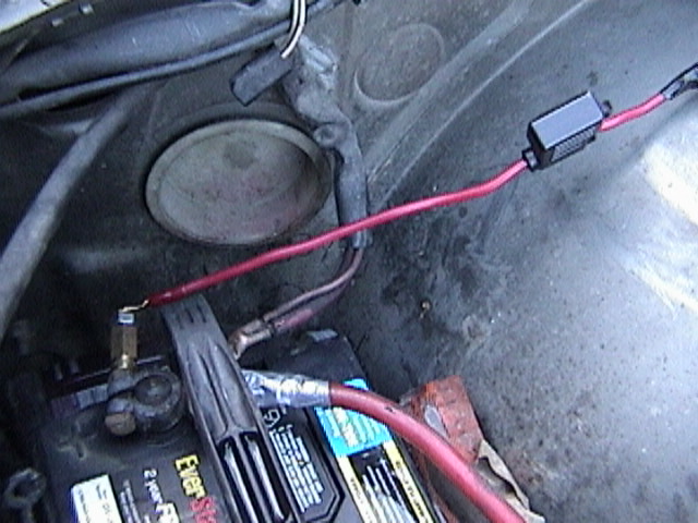

- 30 amp Thermo fuse take off
- term takeoff fuse.JPG (94.86 KiB) Viewed 2597 times
- Overall install, hoses from cabin, to bubbler to air tube.
- complt install2.JPG (89.47 KiB) Viewed 2599 times
- 2" N.O. Vacuum Switch from brake booster
- vacuum switch.JPG (87.11 KiB) Viewed 2597 times
- 30 amp relay and the vacuum Switch
- relay vacuum switch.JPG (86.56 KiB) Viewed 2597 times

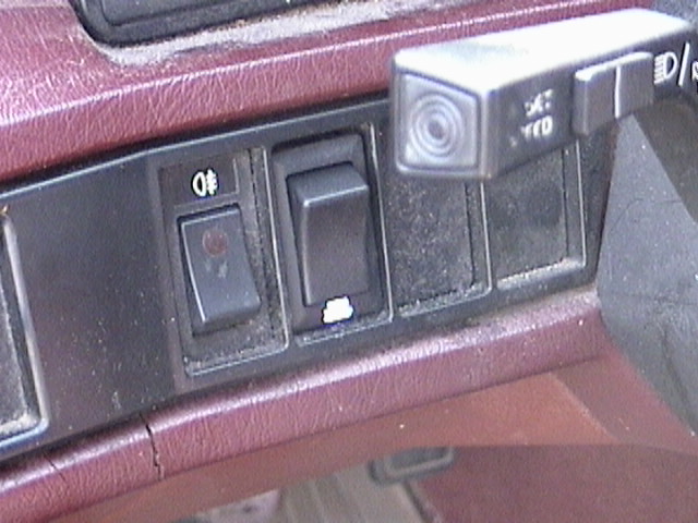

- Dash power switch. Got lucky and it was perfect size.
- cmplt instll7.JPG (88.46 KiB) Viewed 2597 times
- Cell energized. Approximately 1/2-3/4 liter per minute @ less than 10 amps.
- cmplt instll8.JPG (93.91 KiB) Viewed 2597 times

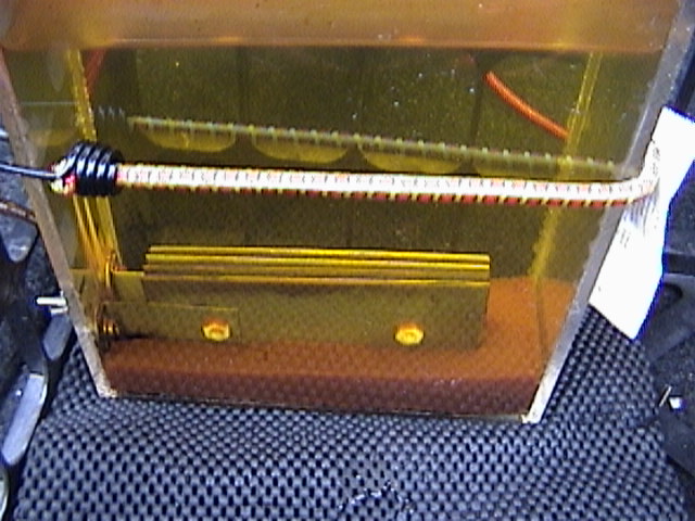

- Morning after use of cell. Typical by product is iron corrosion from stainless steel plates.
- cell bro substance.JPG (88.19 KiB) Viewed 2601 times
