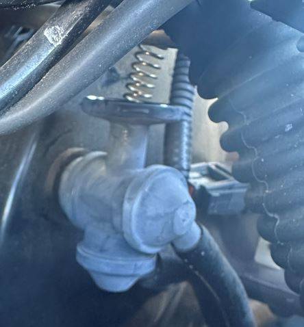

After 24 years this hose failed at the Brake Booster end - just crumbling due to age. Please see attached.

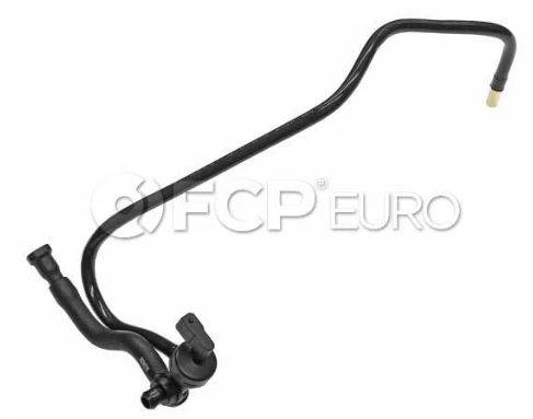

I have checked all my sources (more than a dozen) and can't find the part anywhere = Part # 30616993, pic attached.
Does anyone have a source or way to create a new piece where it crumbled ?
Desperate ! Many thanks for any and all help.

- Brake Booster Hose 30616993.JPG (11.88 KiB) Viewed 6429 times
- Brake Booster Hose Failure piece.JPG (25.13 KiB) Viewed 6429 times
