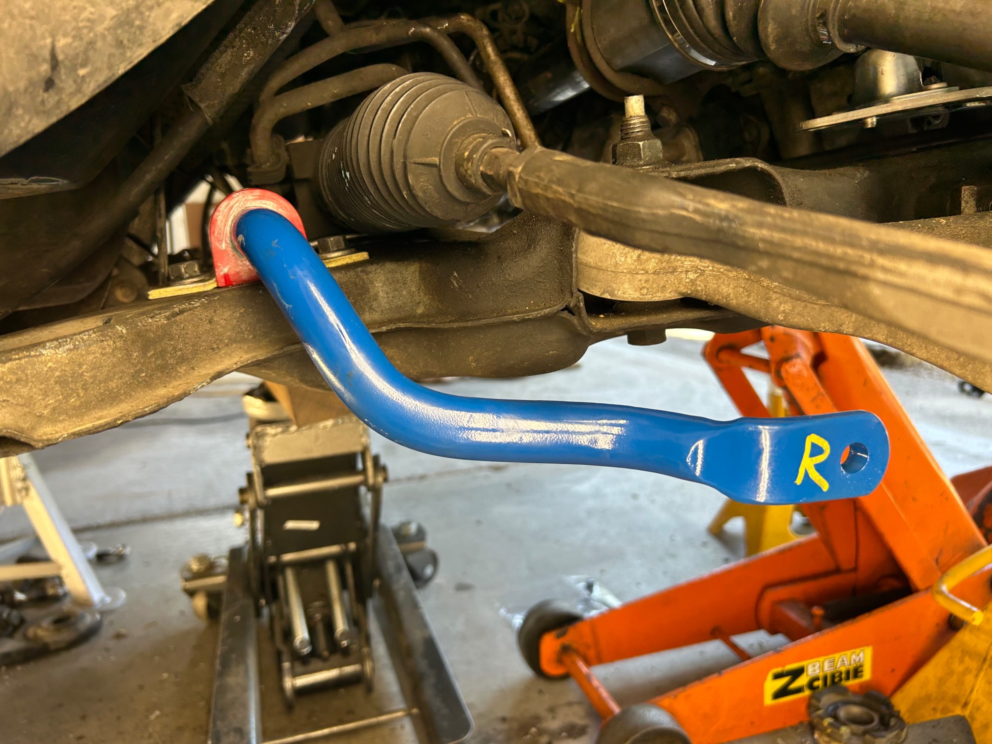

I managed to replace the sway bar. I have now twice reused the subframe bolts and one of them felt like it had less resistance when I was torquing it down. I opted not to do 130 degrees not that I had the power do it either way.
I have also vacuumed up the AC system to prepare for AC radiator replacement.

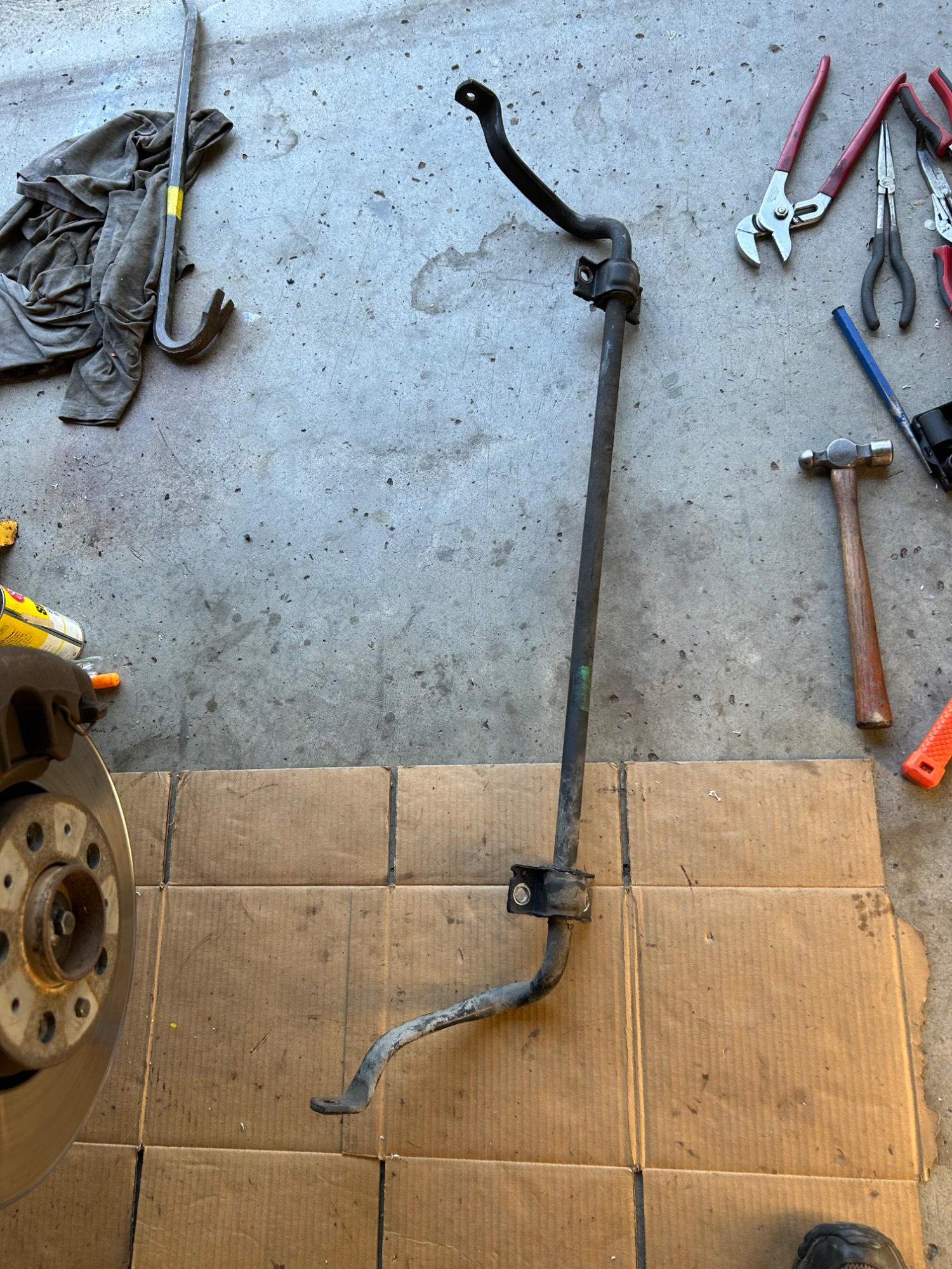

I found a replacement fast, but it was a hassle to replace..BlackBart wrote: 03 Jul 2025, 13:36 I just got my non-rusty bar out. I could have shipped it to you!

I’ll say! Getting it out was a pain! I had to hang the back of the subframe way down and kind of man handle it out the back.
