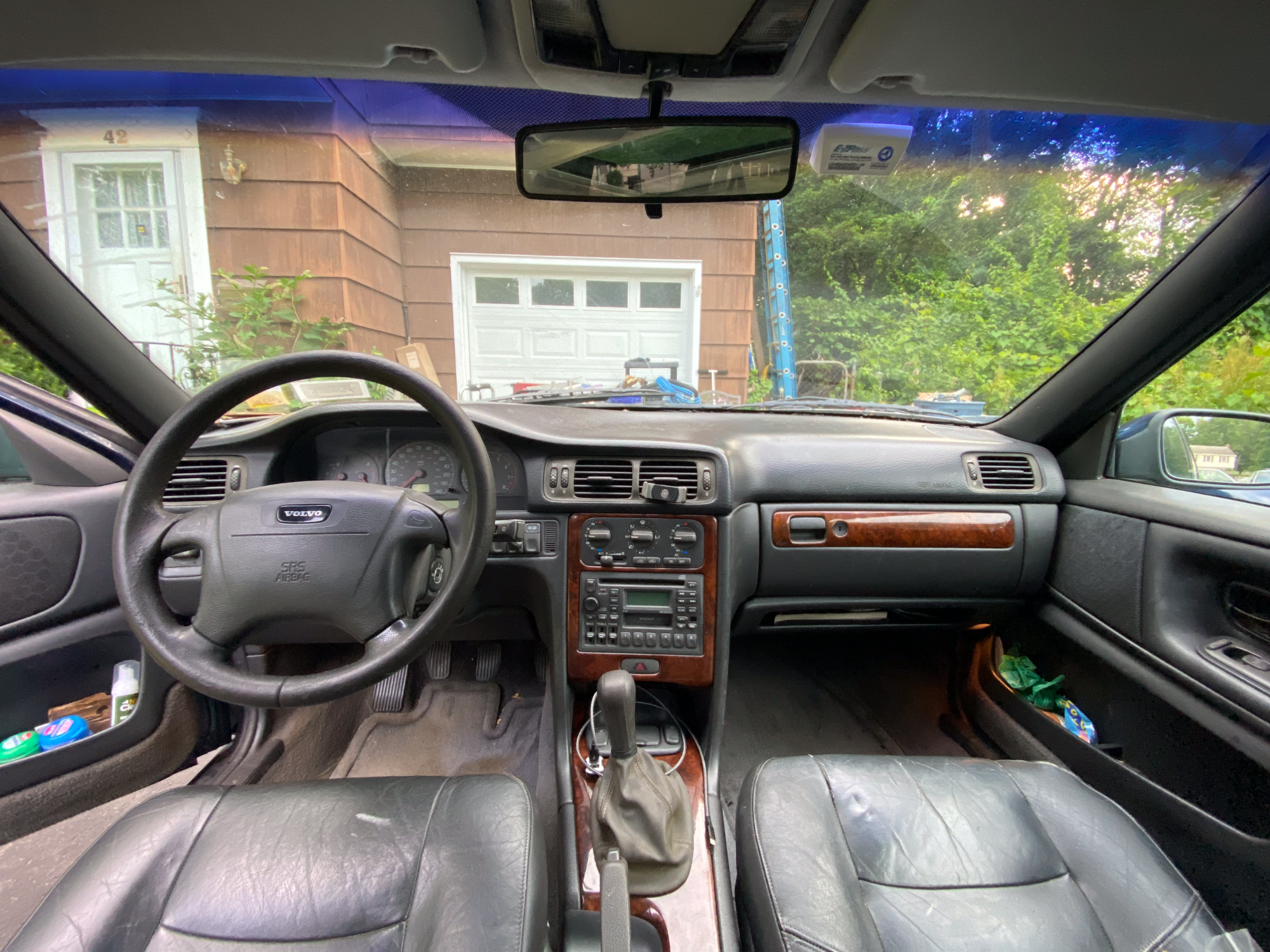

Quick wipe down and vacuum of the interior. Not as bad as I thought although from the seat fabric it looks like the po owned a pet raccoon, or one made it its home when it was in the field

chaosrob wrote: 06 Aug 2025, 12:39 Quick wipe down and vacuum of the interior. Not as bad as I thought although from the seat fabric it looks like the po owned a pet raccoon, or one made it its home when it was in the field
Looks fantastic! Cleaned up nice given how long it was sitting.

Didn't get much done today, I peeled the auto zone cover off the steering wheel, was a bit of a chore as it was baked onto it pretty well. Surprisingly wasn't damaged underneath. Washed it really well and I guess I will see if it gets sticky.
I ran the codes as well and it came back with a P0751 andP0733 for the trans and of course 02 sensors since there are not any. I cleared the codes and fired it up and driveway tested it, the trans codes didn't pop back on but not sure how long you have to drive it for them to pop if there is an issue. When I originally started the car it had the console and ob2 port disconnected and removed, not sure if that will throw any codes with the trans or not.
Tested the heated seats and the ac, both work. The ac was a huge surprise

Think about putting a wood interior into that, rob. The charcoal leather really looks nice warmed up…even better with a 5 speed swizzle stick and four pedals

TY. I actually prefer the current trim to wood, wood looks good in estate wagons and fancier trims imho but sportier ones it looks a bit out of place to my eye
abscate wrote: 08 Aug 2025, 04:20 Working AC required in MO!

Nice! Working AC is shocking given how common AC issues are on these. Of the 4 I’ve owned, not one has had working AC when I bought it.
At least one of those trans codes usually comes back immediately. Drive it for a bit and see what happens, but it’s pretty likely you’re in the clear. The 4 speed in these is super robust.
I have both sets of trim (green ‘98 has walnut in a tan interior, blue ‘98 has R metal mesh w/ the R black leather/suede), and wouldn’t change either. The metal w/ black is definitely better for a sportier feel. The wood is classier, especially w/ tan.
Gotta find a set of Karelian Birch or Black Marble if you want something super cool/rare that stands out.
