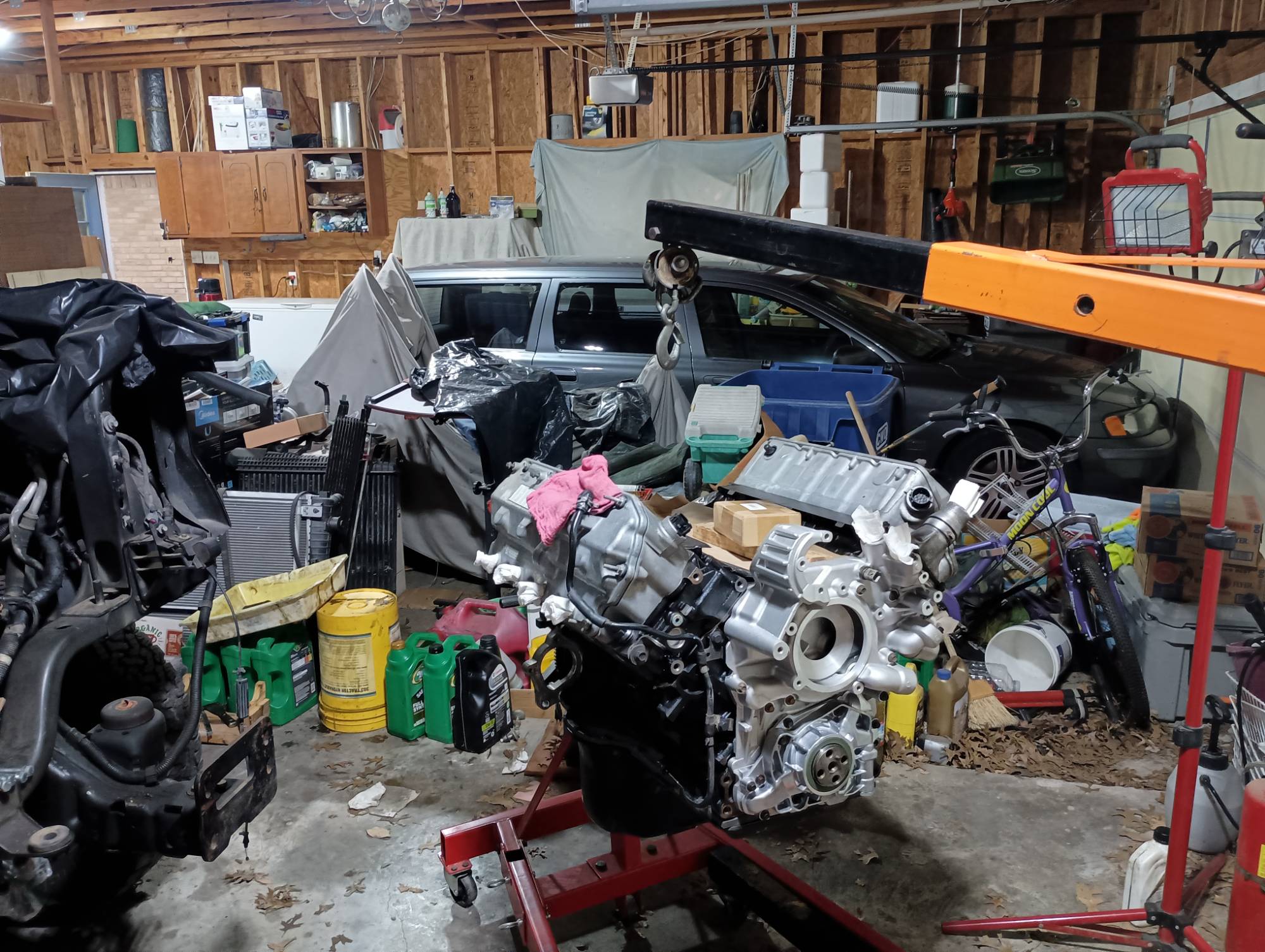

VTI - I intend to zero time it. New bearings, rings and if needed oversize pistons, resized rods and crank grinding. Won't know till it comes apart and I mic it. Doesn't look like these OHC engines have cam bearings.
Do you know of a quality head shop recommendation?
The 04 has been garage kept with regular maintenance so a lot of low time parts will transfer (PCV, exhaust cam phaser, engine mounts). While 280k miles, the body and interior are clean enough to drop a fresh power plant in. Once the electrical gremlins (can bus issue) were resolved, these things are cheap to maintain.
The wife's 04 Volvo (in the background) is number two in the queue. I'll start that project after I complete the 08 Ford 6.4 PSD I'm currently rebuilding.
