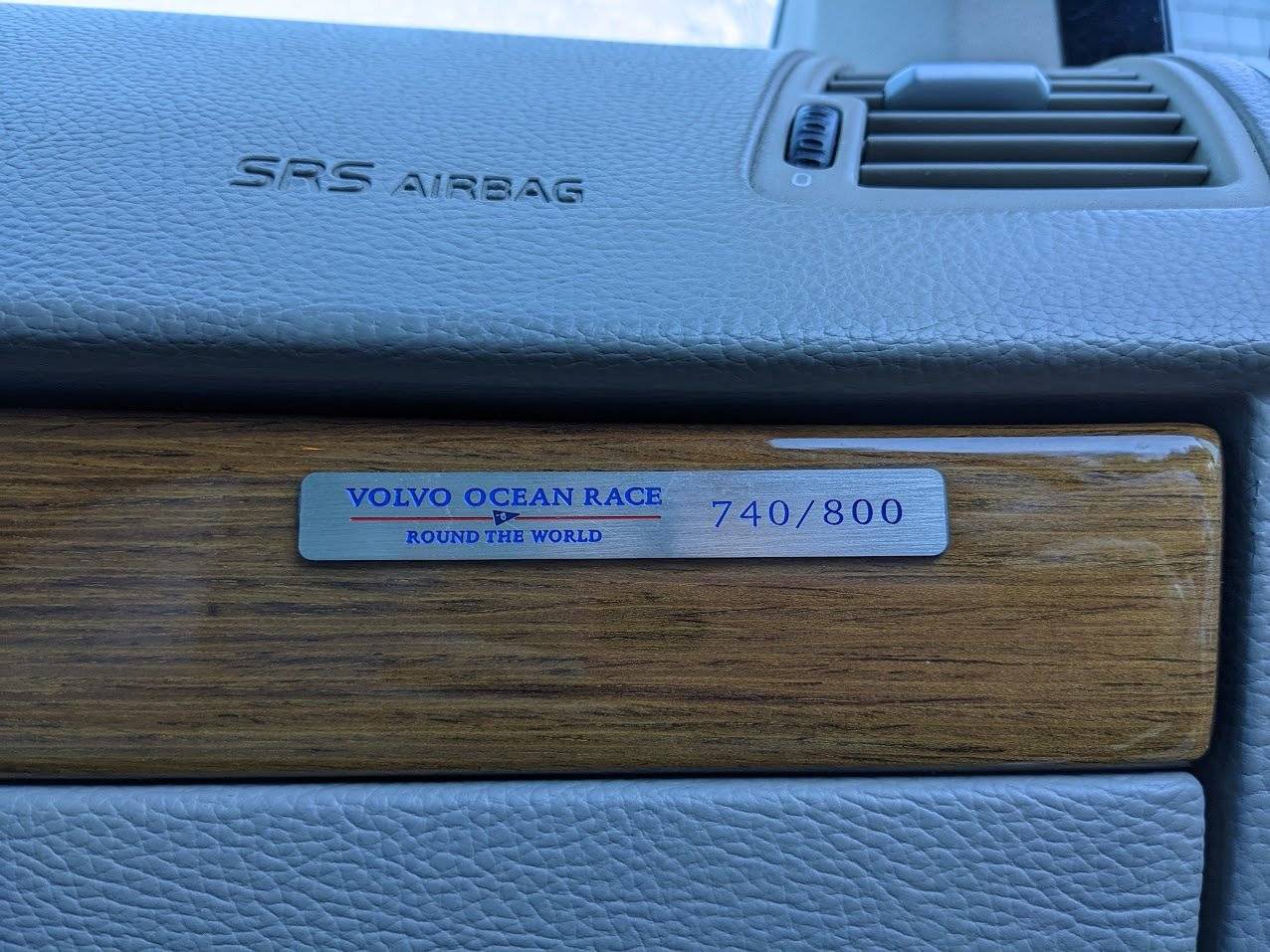

Next time someone sees a Canadian Ocean Race that's NOT a V8, please get a photo of the glovebox. I'm looking for the 800 limited edition plaque or lack thereof. Looks like this:
There's a guy with a 2.5T Ocean Race in Slovenia, no plaque. I have a certificate as well.
Appreciate noting the distinction of US versus North America market segment. There's a limited series of 800 Ocean Race X90s, maybe it's just USA, maybe it's just the V8 subset. Volvo corporate is of little help, they still cannot tell me how many 07 and 08 XC90 V8 Sports were built before the R/D moniker came along in 2009 and the I6 was added to the badge.
