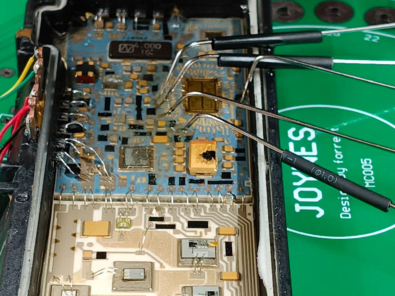

Rereading this topic, I came across a message from dikidera on restoring the ETM Magneti Marelli bootloader. I also restored ETM, but I used a tool to repair SD cards. It is convenient to aim the needles under the microscope.
