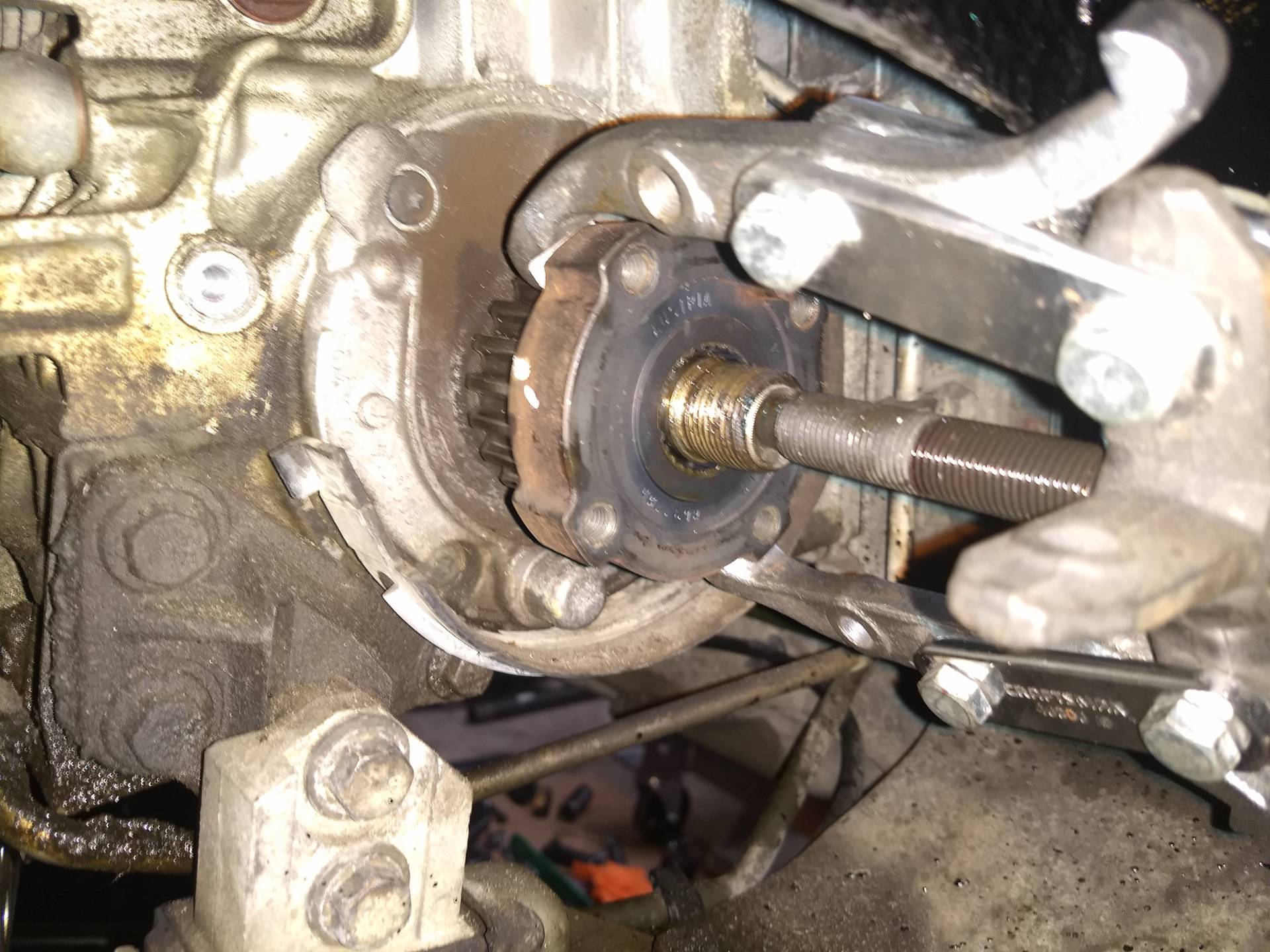

Post a photo of the crack (different angles) once you have it out...

Use a coin for puller, it'll go much smoother.

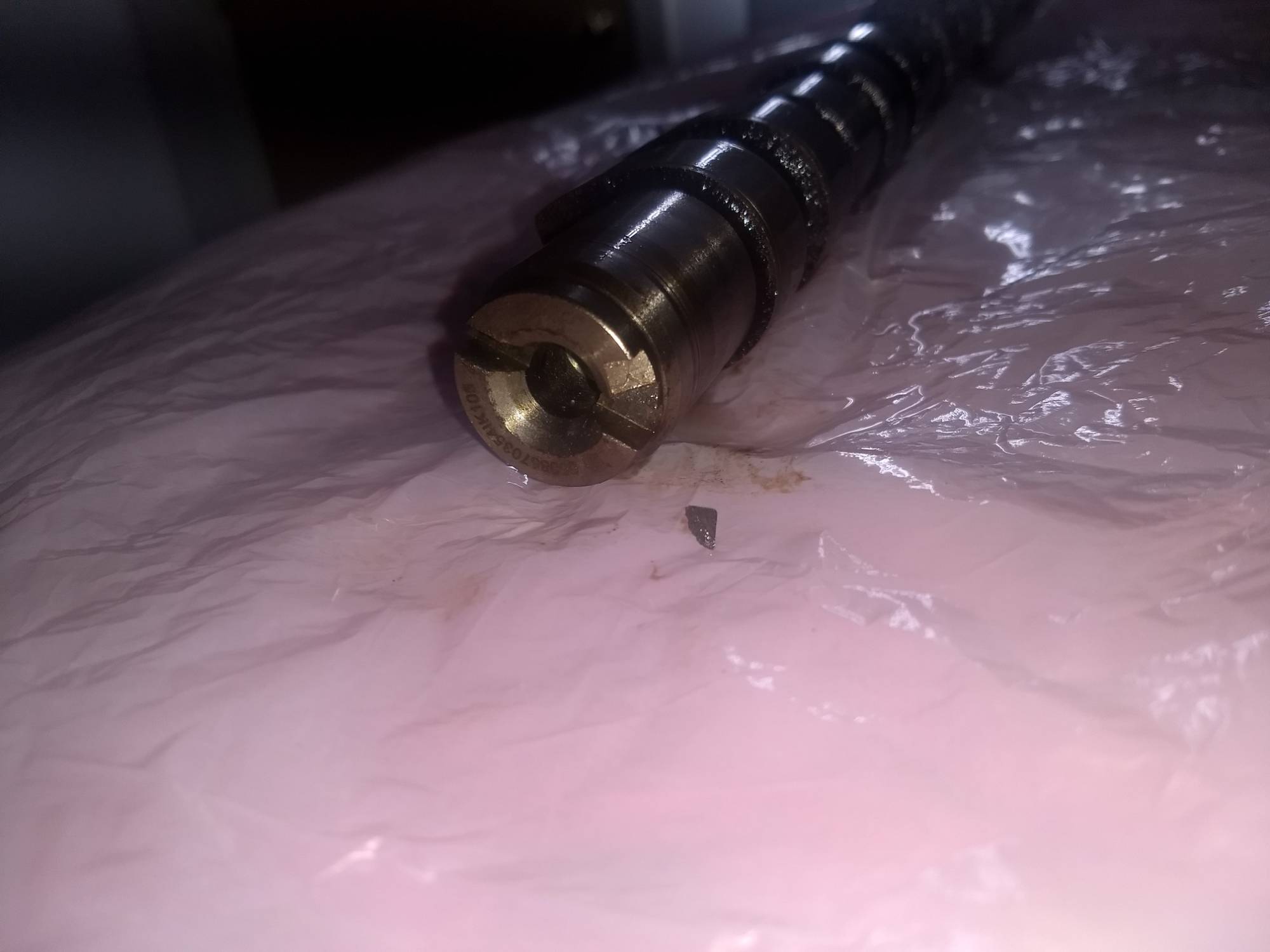

Cheap Amazon locking tool ended up in chipping off a chunk of camshaft... Be aware.
