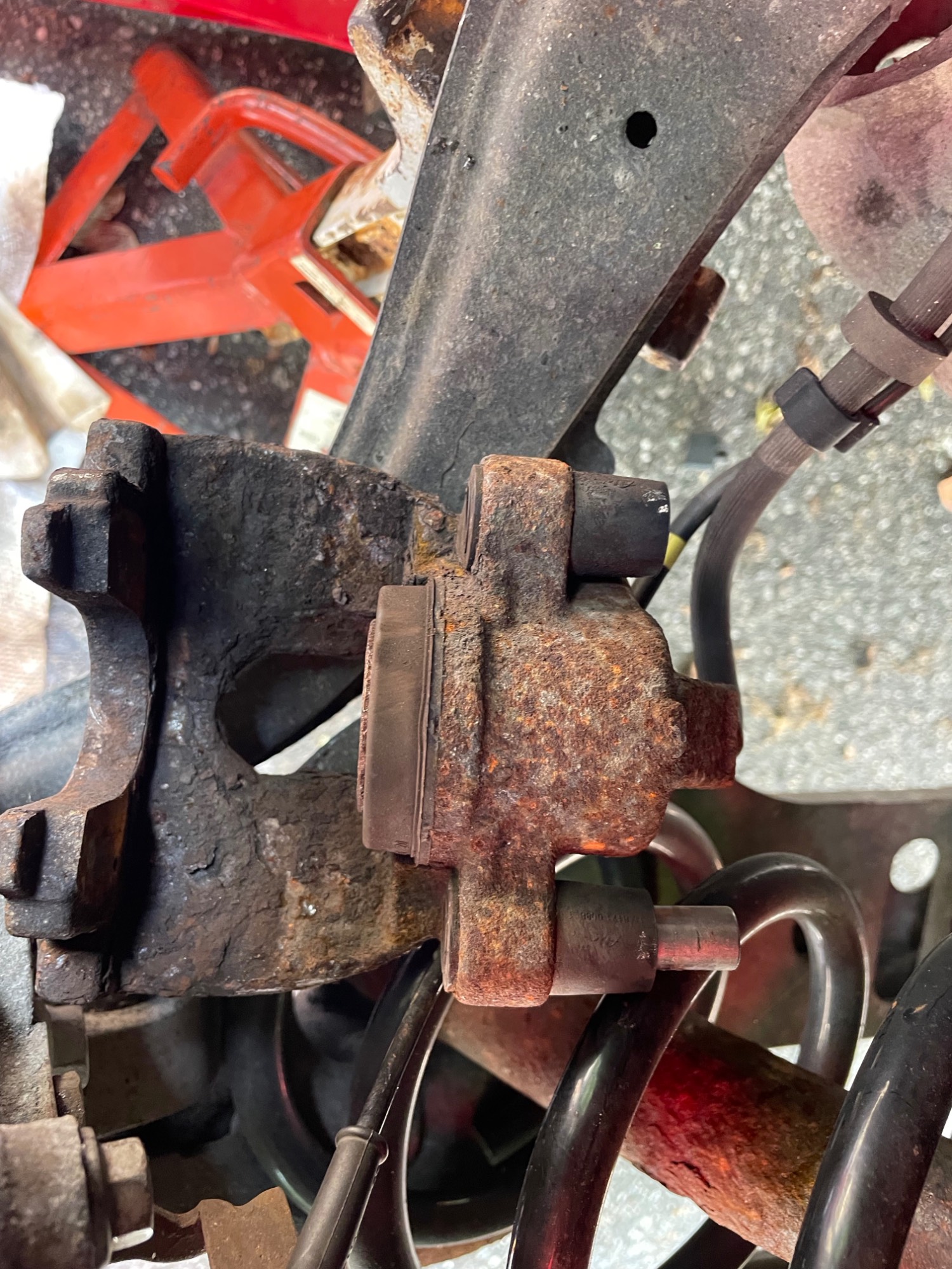

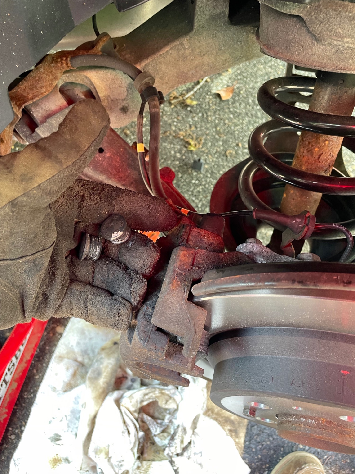

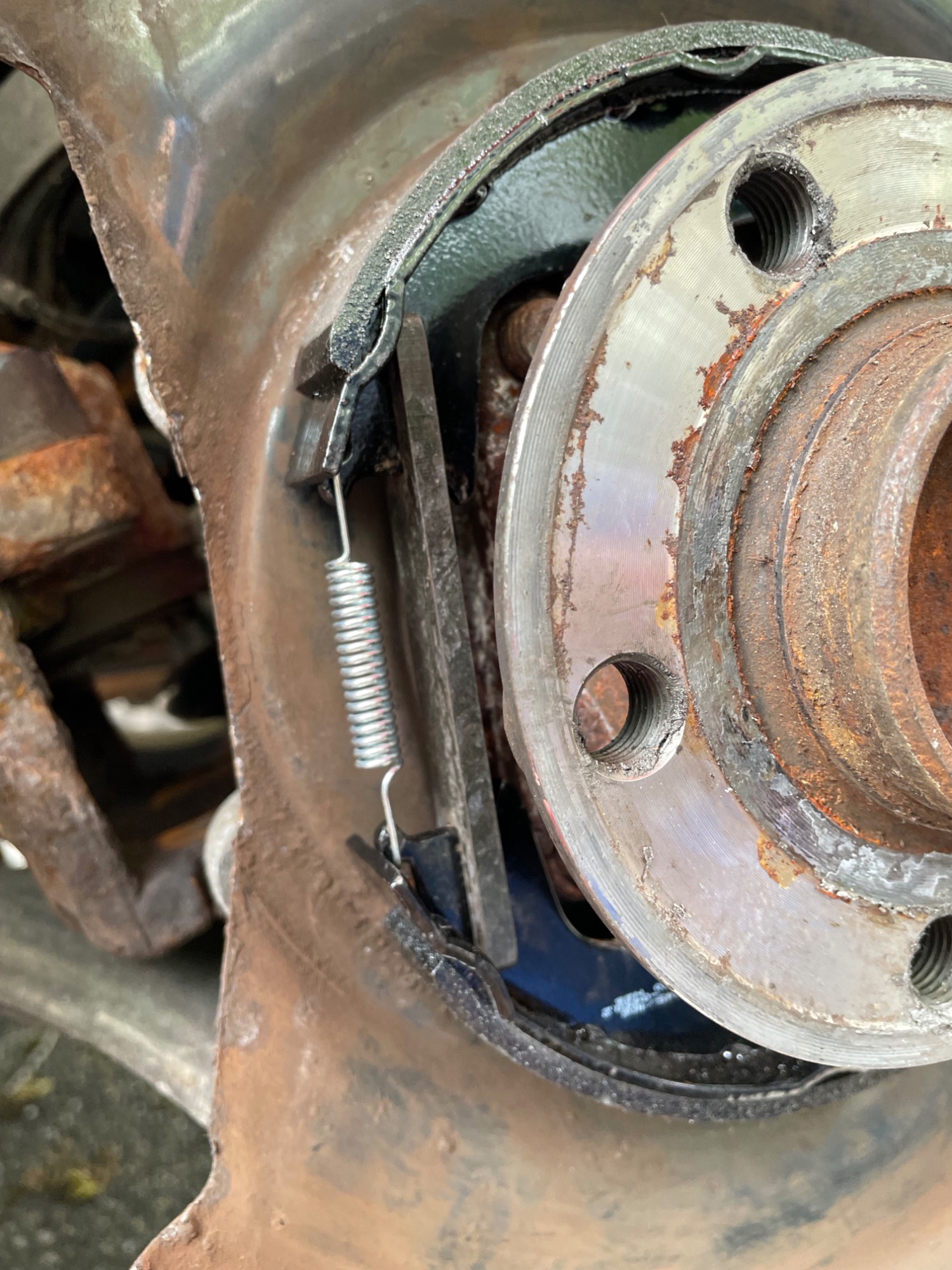

Knocked this job off today. 4 hours in driveway.
Chock, block, jack, and post up.
Wheels off
10 mm small screw retains rotors
H7 tool releases caliper bolts.
Use a 11 mm socket to ease bleeder
Two m8 13mm head bolts release caliper bracket.
You don’t back off the parking brake on a p2, all adjustment is at the handle.
My park shoes had disintegrated so my rotors popped off
Clean up that backing plate
Install shoes and then spring clip retainers. These are a little tough as you have to feed the hook end into a hole hidden by the shoe
Insert front brake bar
Make sure wide end of shoe is in actuator.
The two return springs are best installed hooked into the top, put a slight bend on the lower tang so you can pick up the lower groove.
Then is down hill…bracket , pads, caliper. Rotor.
‘Bleed 250 ml fluid through when done

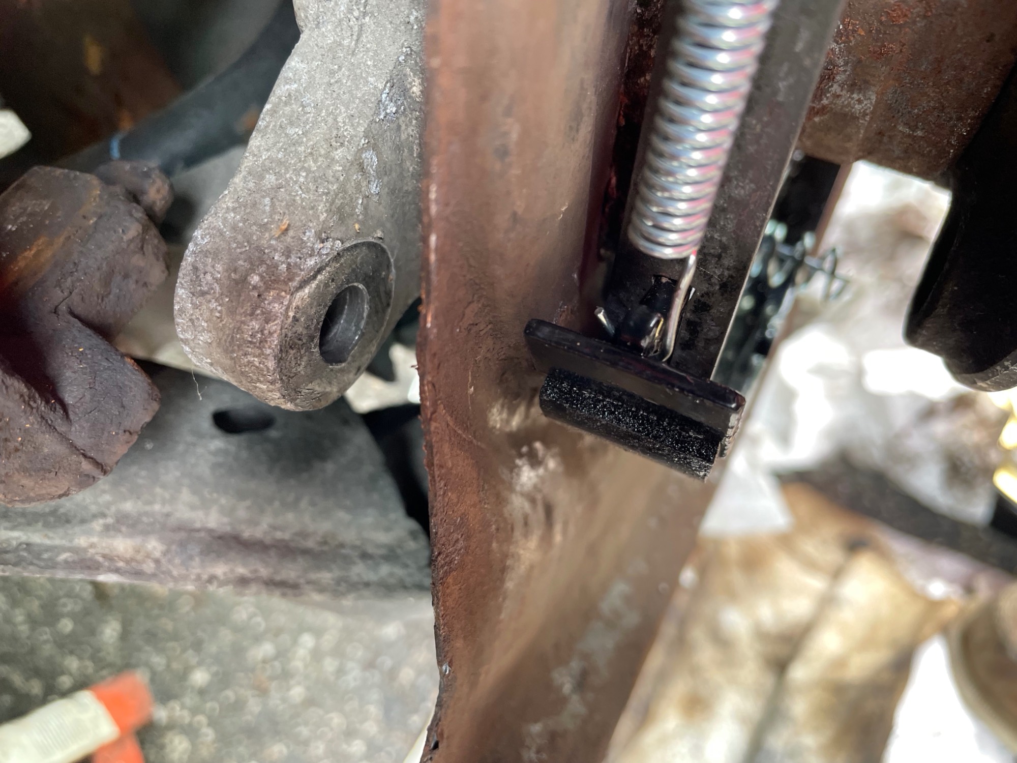

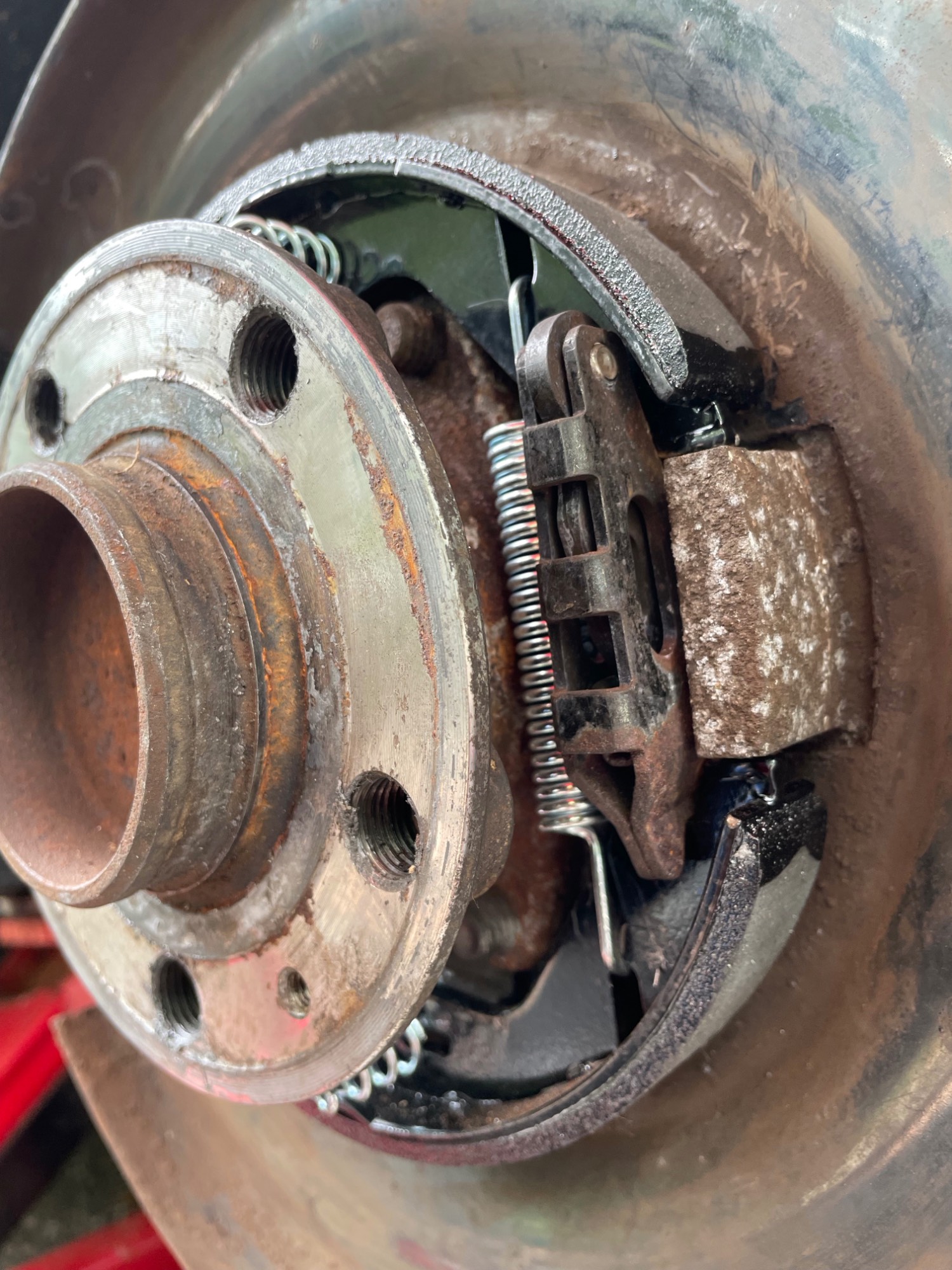

The brake clips on the parking brake shoes are a bit fussy you have to stuff the square bit inthe slot the slide it forward to catch the lip yo lock. You are working blind as it’s hidden by the shoe. It took me a few minutes to get the technique
On the springs, if you put a 28.5 degree angle on the spring with a plier, it’s a lot easier to hook them into the slot/hole on the shoe, under tension. After they go in , you can squeeze them back to parallel with a plier, or not. Obviously , the student will recognize 28.5 degrees as θ /2 = > 3 cos( θ ) ^2 -1 commonly called the magic angle. See picture below.
The shoe end with the deep slot goes toward the front of the car. The flat plate with the two slots mates up with these slots on top and bottom both shoes are identical with respect to both top/bottom and left right. You have four identical pieces in the box
You don’t have the star wheel adjust on the p2, unlike the p80. Adjustment is done at the handbrake lever. I didn’t have to adjust mine , I will wait until the bed in before doing that. I’ll add a picture here.

Note the slight angle on the spring facilitating install

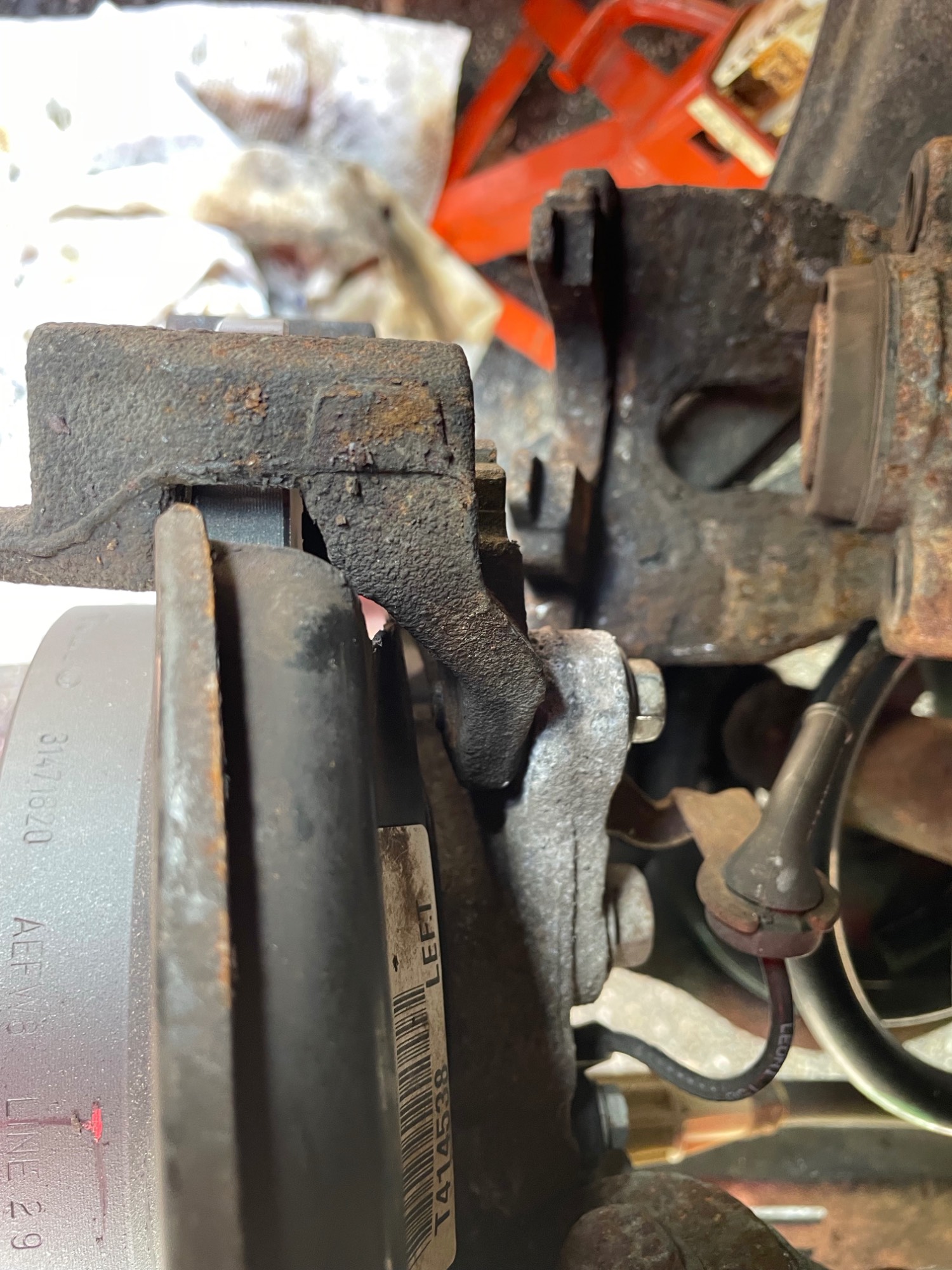

Loosen the 11mm bleeder and push pistons in by hand
